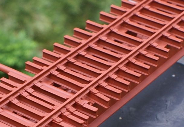

Hi, I haven't been on in a while but I was poking around tonight and saw this thread. I used FineLines for the prototyping on my 1:48 Cimarron bridge model kit. It is a mix of castings, laser cut and etch. I embossed all the rivets on my first all-resin bridge and decided to have them made via 3-D on my second kit. That way I could include complex shapes with rivets in any plane.
I used the Renshape SL 7820 in a high-resolution build. That gives .002" layers. The layers are visible in high magnification, but in even a close-up photo they are not noticeable. The special green material and build is for special cases only, or if you have a way of dividing the cost.
The rivets are .030" diameter, the flange is .060" high. The lines are the layers of the build, which are visible due to the sloping side of the beam and the hemispherical rivet. They are also caused by my somewhat course segment resolution I needed to use in my old computer.
In the assembly they look fine.
FineLines took care of me very nicely- I had problems with my .stl files that they fixed for me (one was inside-out?!). The high-resolution is not cheap. The trick is to make multiple copies and sell them to friends, or on e-bay or somewhere. The set-up costs money and the subsequent parts are a small fraction of the original 1-up charge. I chose the natural finish which saved money too. It is worth doing once at least to try because of the fun experience in sending in a 3-D drawing and getting parts in the mail that match the CAD perfectly.
