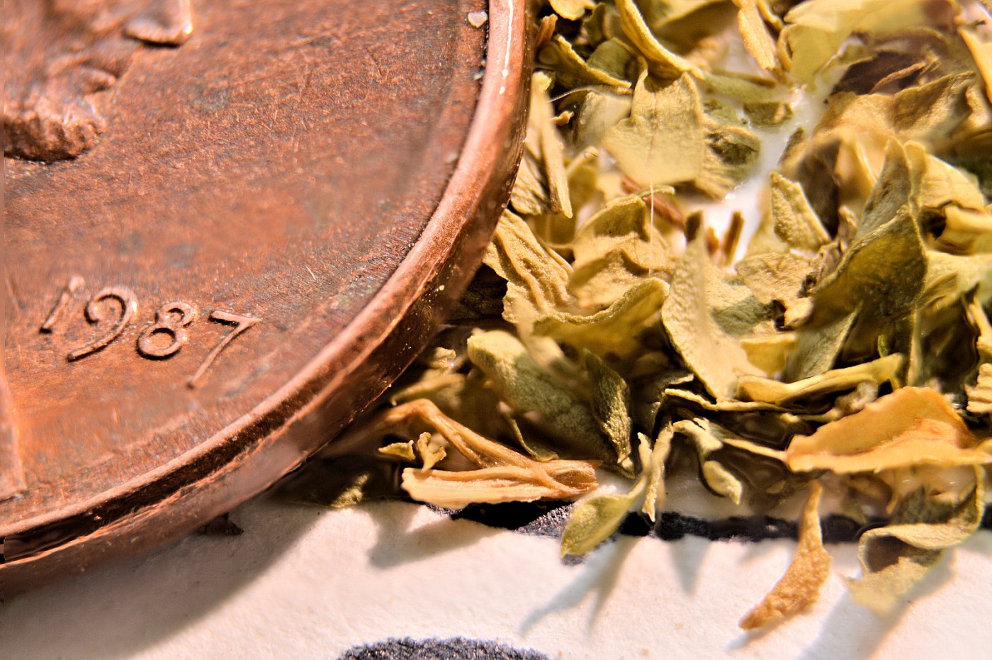

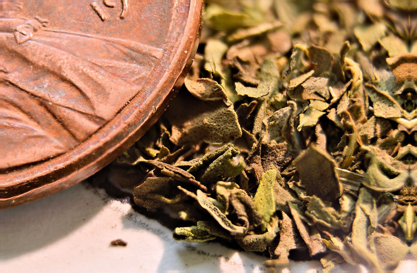

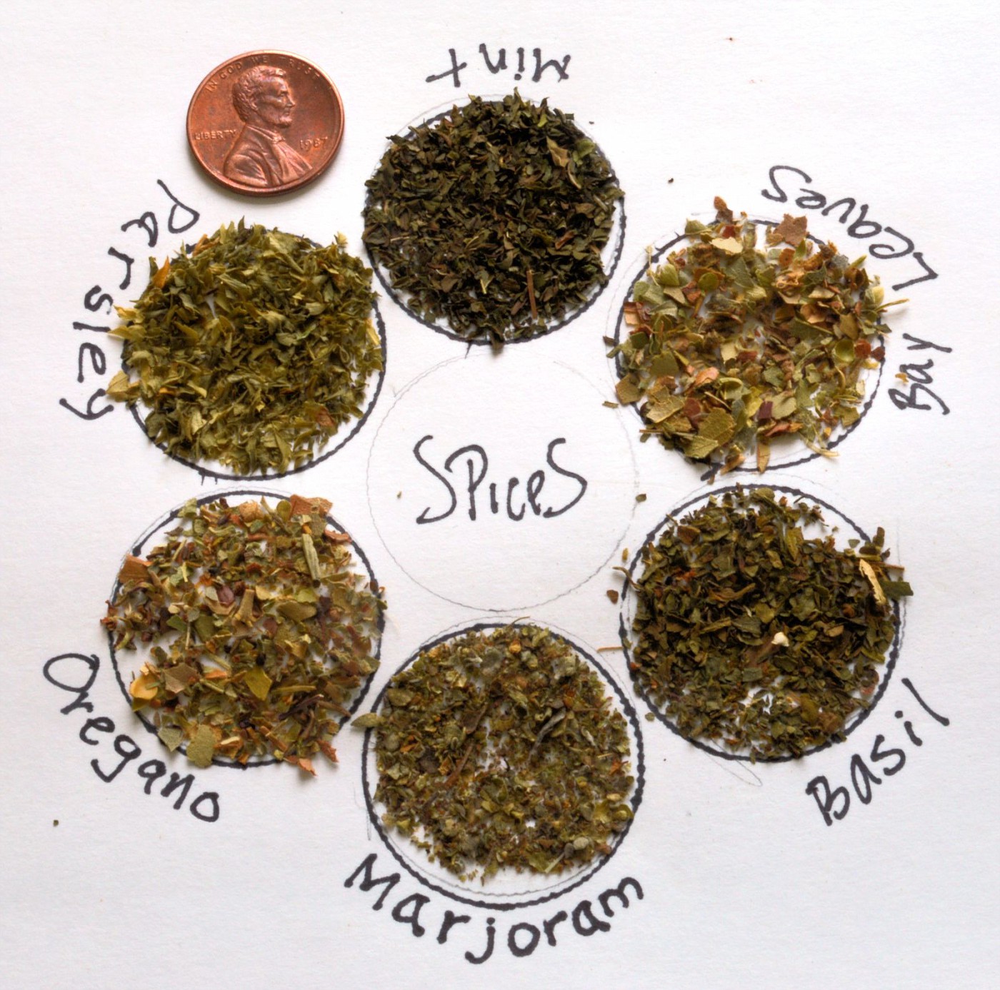

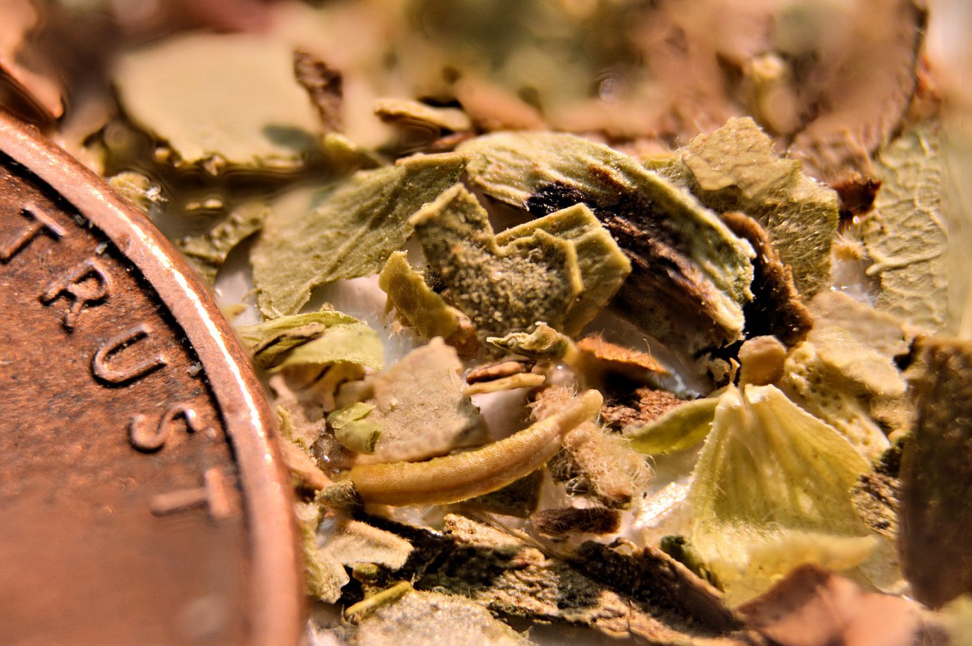

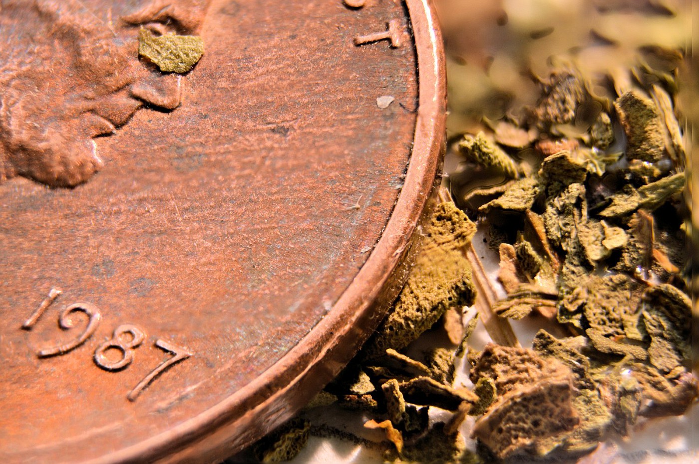

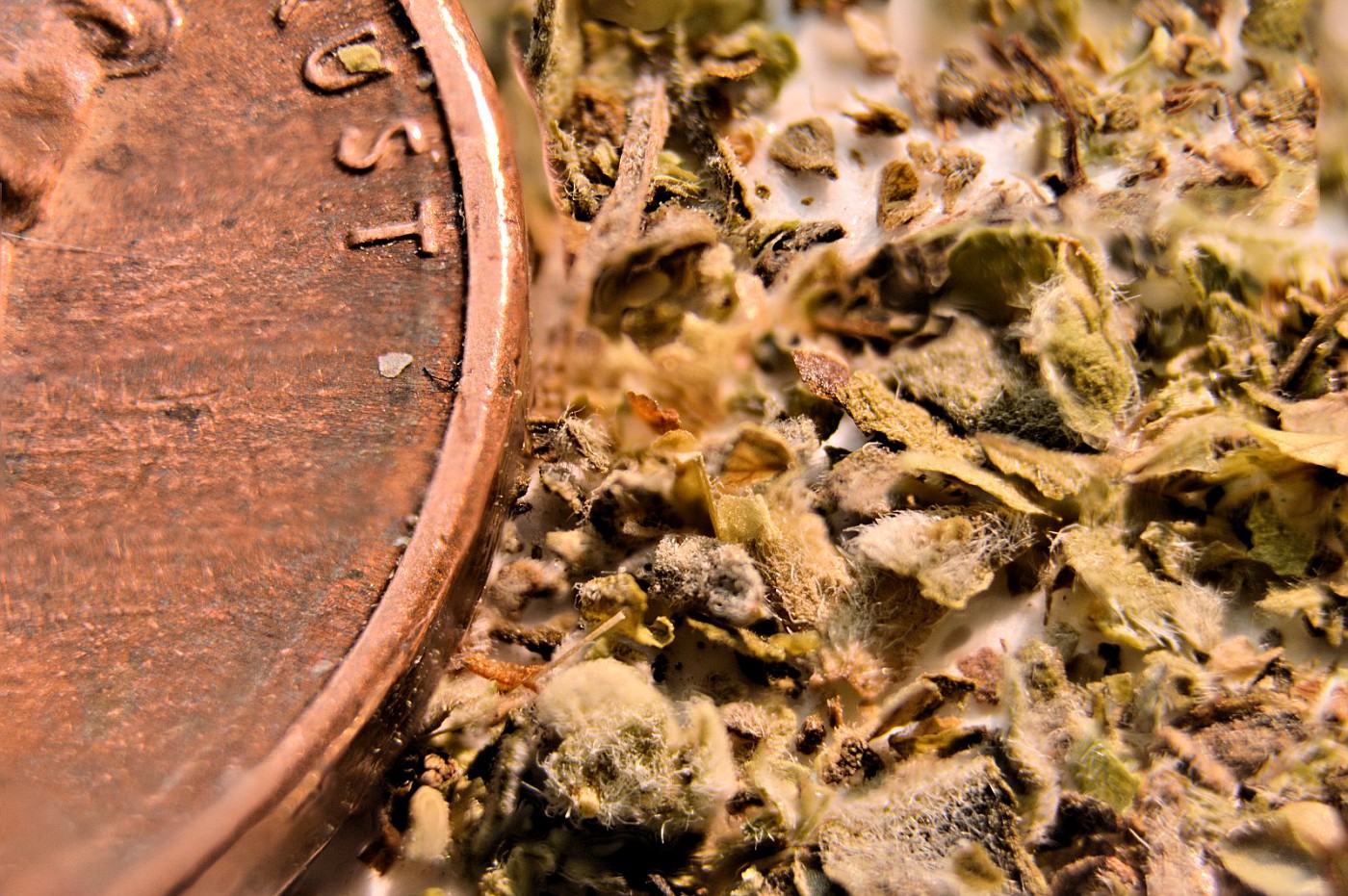

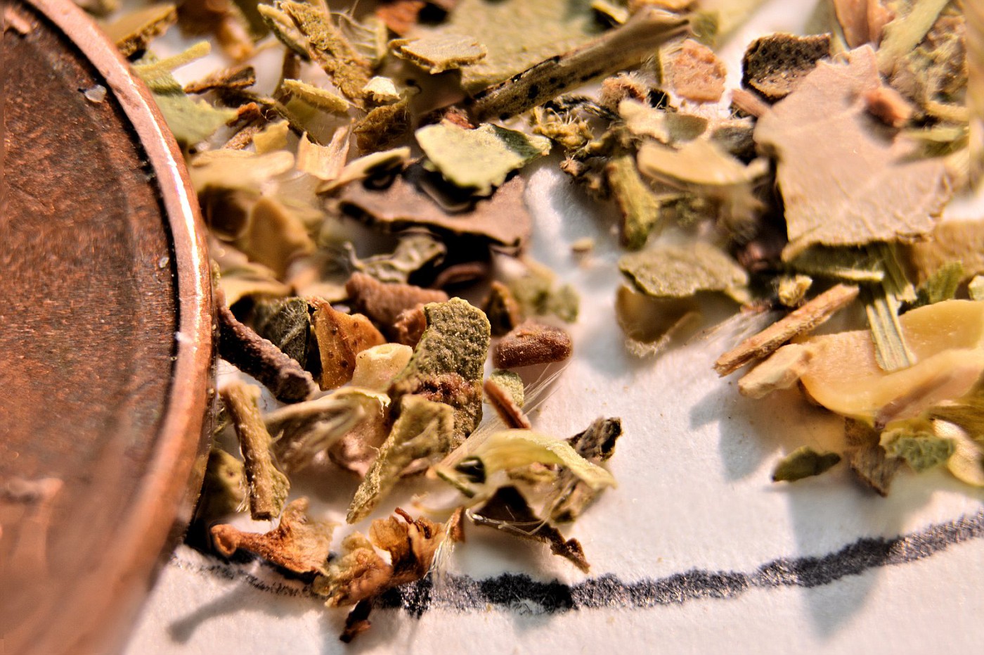

I was playing around with some items from the spice rack to see what I could l do with them.
I tried Mint, Bay Leaves, Basil, Marjoram, Oregano and Parsley

Are these ground or are they out of the jar?
Some color mixes look interesting, but the weak point is the thickness of each leaf. (while it's look good on the first picture, on the macro shots it does not look as great)
Something I would recommend for dead leaves or forest scatter is to make a gradient in the particle's size.
Starting from ground mix (powder look) to biggest leaves, cause that's a good way too add contrasts and help the mix to be readable.
I'm not sure it makes so much sense, so I'll do a small test piece to show what I mean.

I think the Mint and Parsley were probably best .. the rest being too thick. Here's something else I tried .. the plant in the center of this photo is from a feather duster (Ostrich plume)
