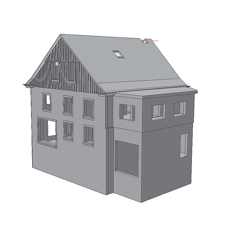

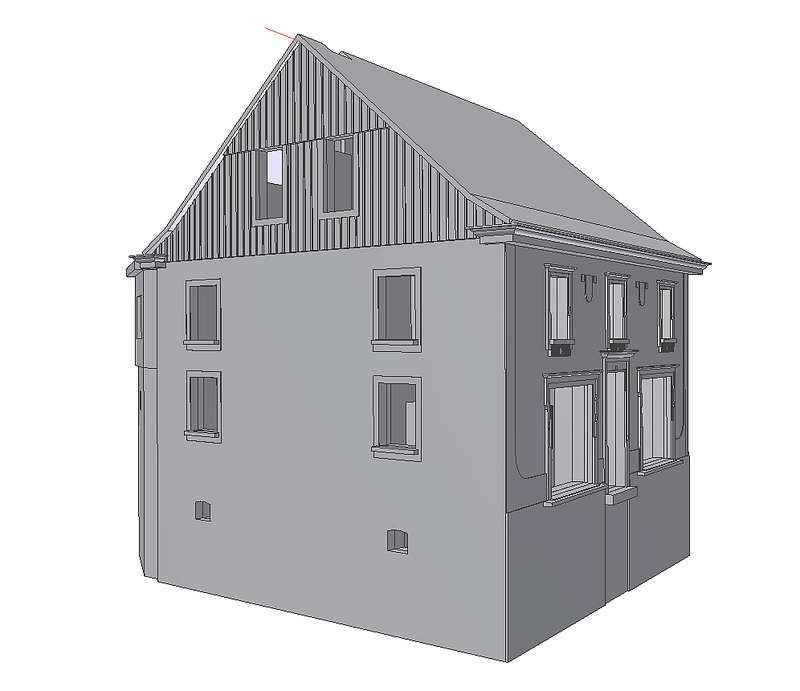

There was a building nearby the railway bridge over Oester brook: 'Haus Lohmann'. The building has long gone, even the railway lasted a few years longer than this. Fortunately there are some meaningful pictures and even some plans from a conversion dating back to 1909 preserved, when it was changed to a watchmaker and jewelry shop.
(Picture: Albert Middelmann 10/1941; W. D. Groote collection)
Please note the lower part of the lamp visible left hand; it's the one I'd shown before. During some kind of modeling lockout a CAD drawing was the first approach to the building, which is quite interesting for it's annex and the sloped wall alongside the brook.

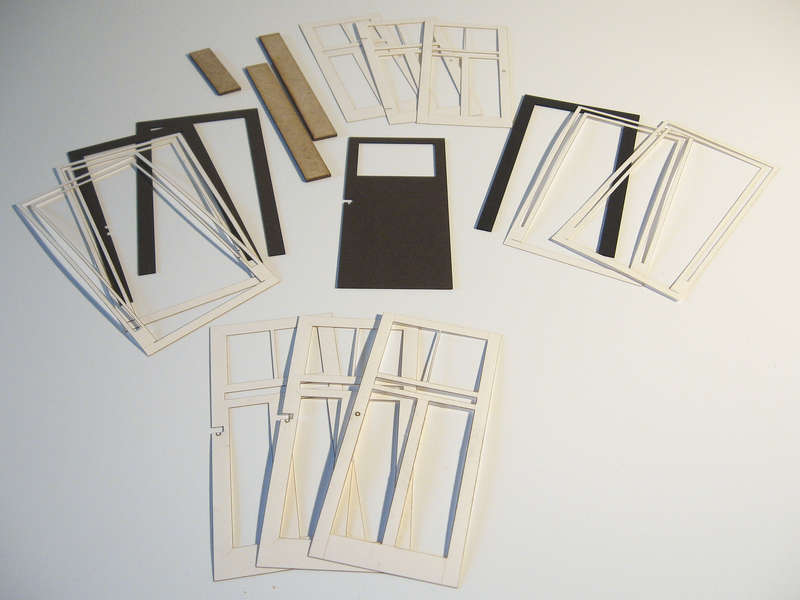

Let's talk about transition from virtual reality to, um, real reality. A good item for that is a door. There ares some of them in such a masonry.

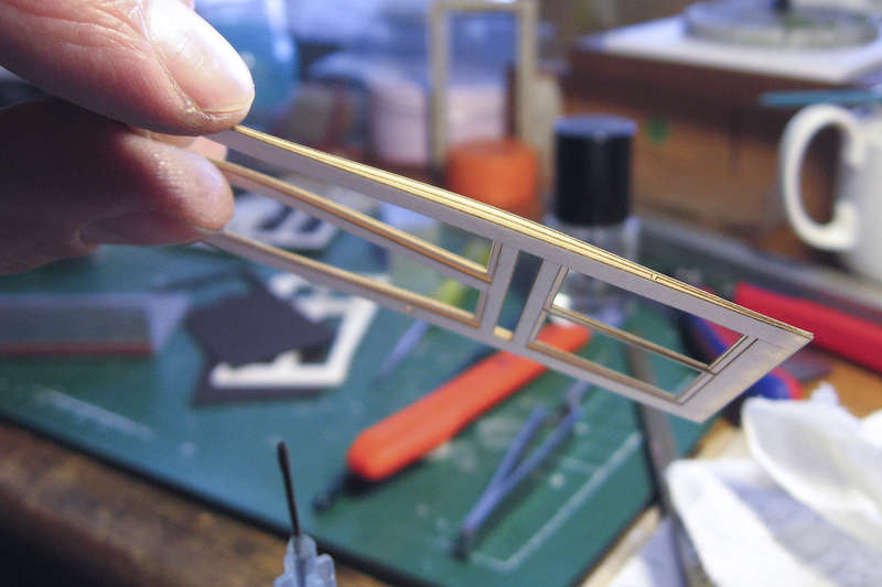

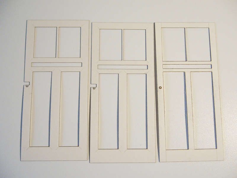

The doors are made from lasered paper, cardboard and MDF. Dark brown parts are 0.5 mm cardboard, bright brown ones 1.5 mm MDF and the yellowish ones 0.15 mm (180g/m²) paper. Those are all parts required for one door and I need some 20 of them.
The layers differ a whiff (some 0.5 mm) to create the door leafs' elevation; this is for a partially paned door. The longitudinal cutout is going to be filled with 0.5 mm steel rods.
Note the tiny cutout in the middle layer which later on serves to position the hinges.

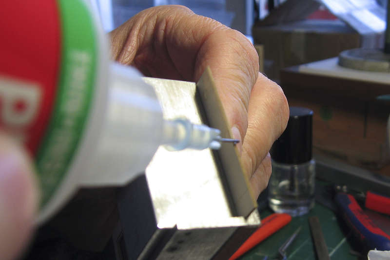

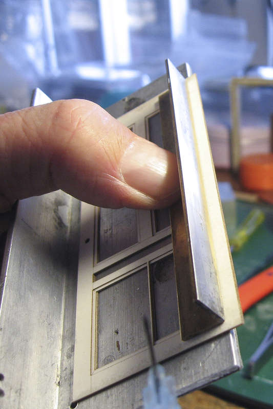

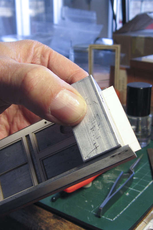

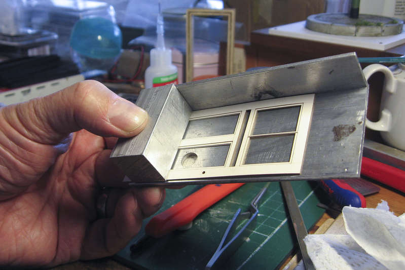

Some aluminum parts served to align and fix the parts for glueing with very thin ca. I found out that it doesn't matter if there's some ca running into the gap between paper and metal; it doesn't really stick to aluminum and so paper is removable without destruction, if that happens. The point is to have the paper layers' edges protruding from the aluminum material while compressing it the same time.

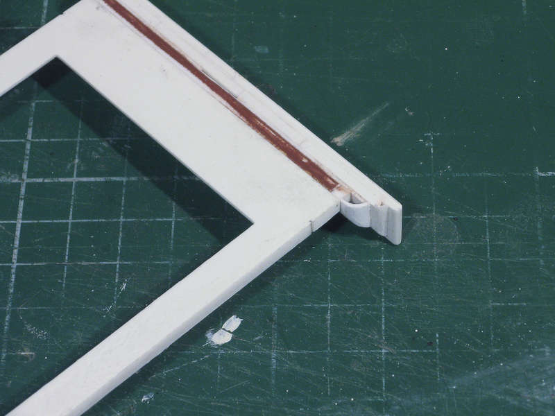

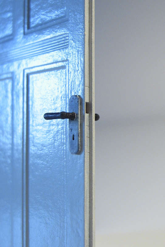

Door handles, hinges and lock bolts are 3D printed (the latter missing in the following picture). The hinges do work by inserting some 0.3 mm steel wire. I designed them with two holes, one for the hinge bolt and one to fix it to the above mentioned cutouts in the door blades and doorframes sides.  Most doors won't be in working order, of course, but doors, being closed forever, are a sad thing, aren't they?

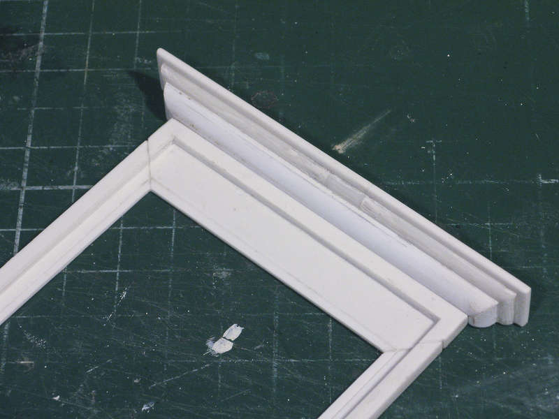

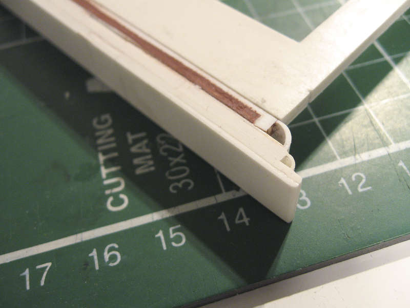

The door and shop windows had some ornament. I'll have some smaller parts 3D printed, but for the entrance door I used ps panel and cutter quartered tubing of different diameter to create the profiles, all from the junk box.
