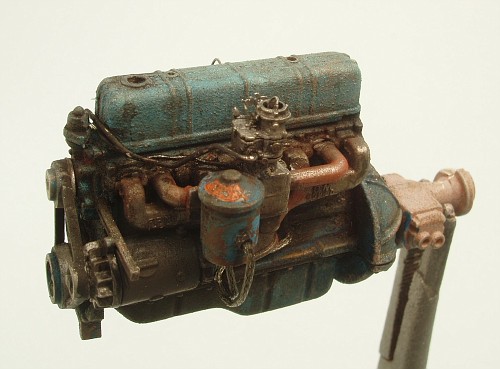

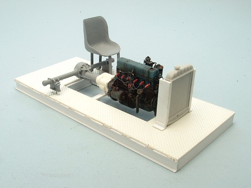

My newer, freelance piece is powered by a Chevy six:
The platform is diamond plate "welded" to channel stock.  I'm using the radiator & axle
from the same '48 Chevy the motor came out of to enhance the story of a home-built lumber
buggy that was made from parts found around the yard.

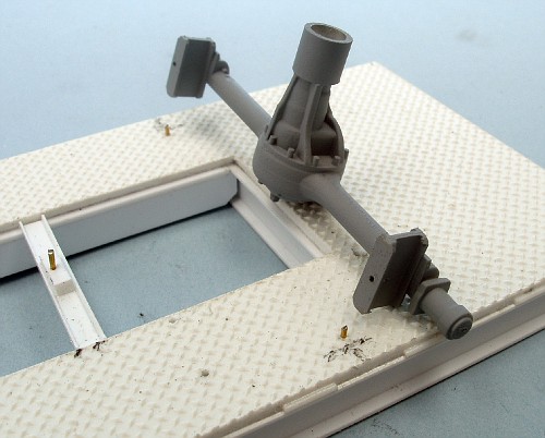

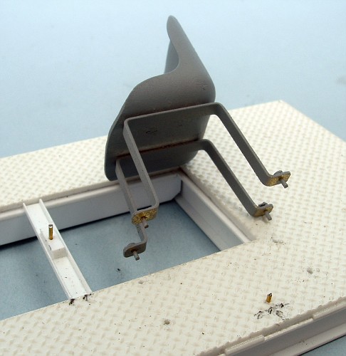

The seat was found in the parts box.  I think it was from an old sprint car kit and had to be
narrowed by about 3 scale inches.  I didn't notice the rear axle cradle wasn't pushed down
onto the pin for the photo....
Speaking of pins, one thing I learned during my "Model Car Years" was using pins to locate
sub-assemblies. The transmission, axle unit and seat are all positioned with pins, which make
mocking up the model really easy and assists no-end in final assembly.

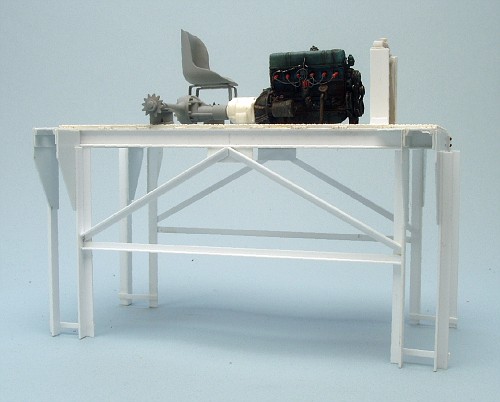

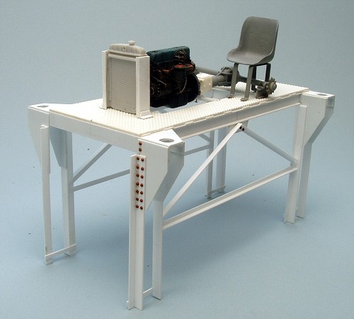

This is where the model stands right now. I've started building the legs.
Nothing fancy, just styrene angle and sheet stock.
The rivets are .050" Tichy.  It would be cheaper to make them but this way they're
uniform and WAY easier to do.
The stuff on top is just sitting in-place for the photo.

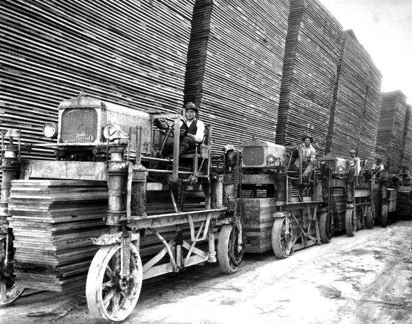

#7
Gerlinger has been making lumber carriers (actually called Straddle Carriers) since 1918.
One of their original models.
There is actually a book called:
"A Pictorial History of the Straddle Carrier" by D. Earl Starner. 1988.

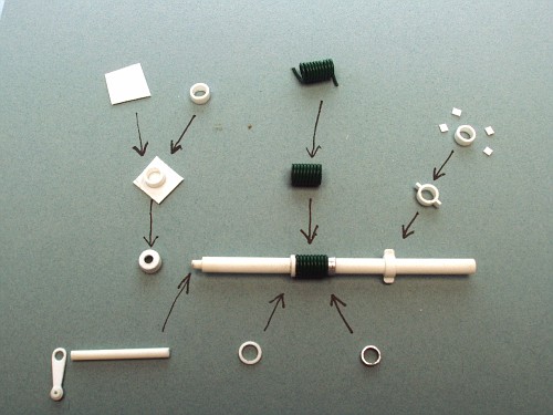

This step might be more clear as the project moves ahead, but here's how the legs are constructed:
The end cap (upper left) is made from styrene sheet and a slice of tubing, which is filled & drilled.
That piece will allow the leg to pivot in the outer sleeve (on the machine's frame) for poseable steering;
The spring (center) is floral wire wrapped around the leg. The ends are filed flat, then it's slipped
over the leg & held in place with two retainers;
The leg's lower guide (right) is made with a slice of tubing and 4 styrene ears;
The steering arm (lower left) is attached to the small styrene rod that is inserted and glued to
the leg, basically forming a pin out the top of the leg....

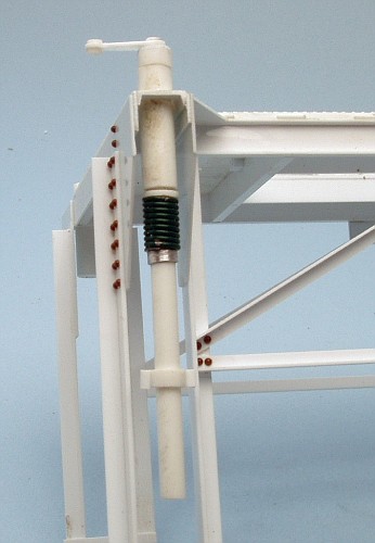

Here's one leg in place.  I hope the above description is clear.  If not, if may become more obvious as we go along....
