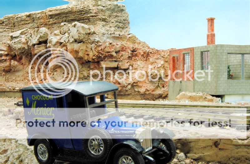

I just did a quick and dirty test of the software. The only glitch I ran into was a small strip at the very bottom and left of the stacked photo that appeared to be a mirror of the 'bit' above it. That was simple enough to strip off the finished photo.

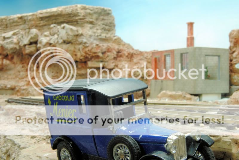

Here's the scene using Auto focus at f29
Here's the same scene created from 9 photos of varying focus distance using Combine ZM
Got no complaints .. as hard to beat 'Easy and Free' as Frederic put it.
