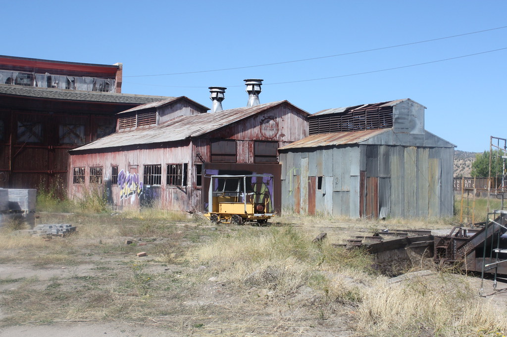

When a smoke jack is used on a roof with an uneven surface, such as tiles or corrugated metal, how do they usually fit the "flange" at the base of the jack to the surface, without leaving gaps?
So far the photos I've seen don't make this very clear due to the angle of the photo, and the distance. In fact I'm looking at one right now, which shows a smoke jack on a corrugated metal roof. It looks like it's just sitting on top of the corrugations -- I can't see any attempt at preventing rain from getting under it from the "upslope" side.

Ray, dont know about smaller smoke jacks, but metal stacks that I have seen on old corrugated industrial roofs often had a square/rectanguler sheet mateal flange. flashing at the base of the stack where it protruded out of the roofing. whenever possible this flange would lap over the lower piece of corrugated, and extent to lapunder the upper piece of corrugated. I have also seen corr. ruufing pieces notched at stacks and chimneys to specifically provide this type of coverage.
WHere no joint is near, and the lapping the flashing under is therfore not possible, I have seen the use of a diverter lip/edge at the piece above the stack location. This way the majority of the water run-off coming towards the stack was diverted....then at the stack, flashing itseld there was likely a asphaltic or bitumen type of sealer used as Ed notes.
There are other ways this can be done and flashed,...but this would likely all depend on the type of constructio/structure you are representing )IE. what was it used for..and how much did the owner want to spend or care).
