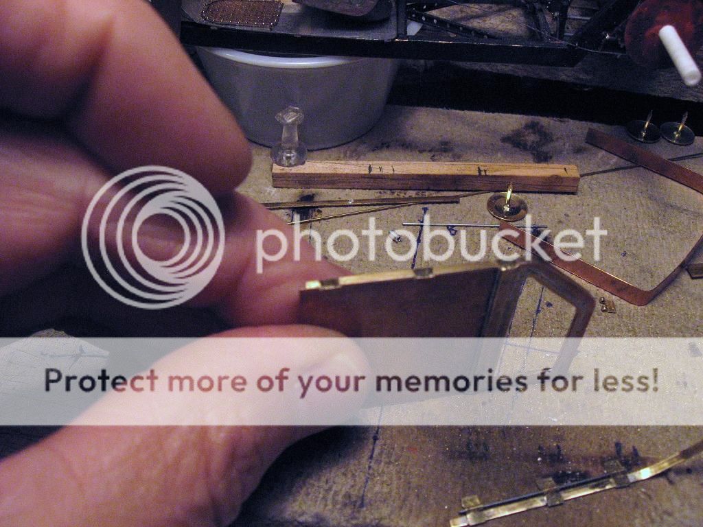

Finally had some bench time!!!

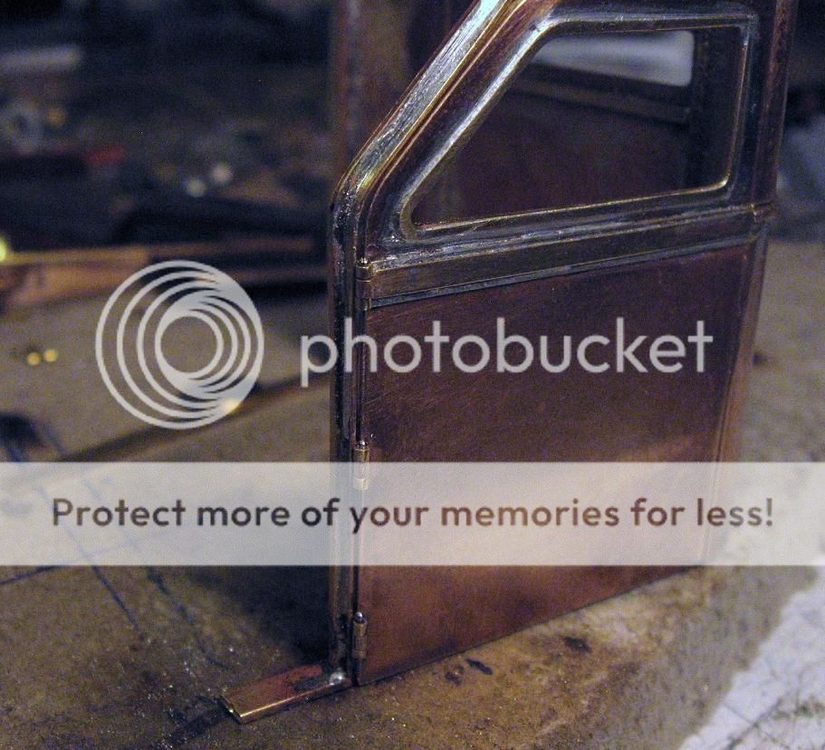

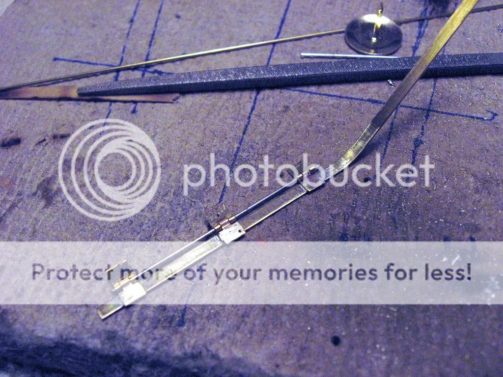

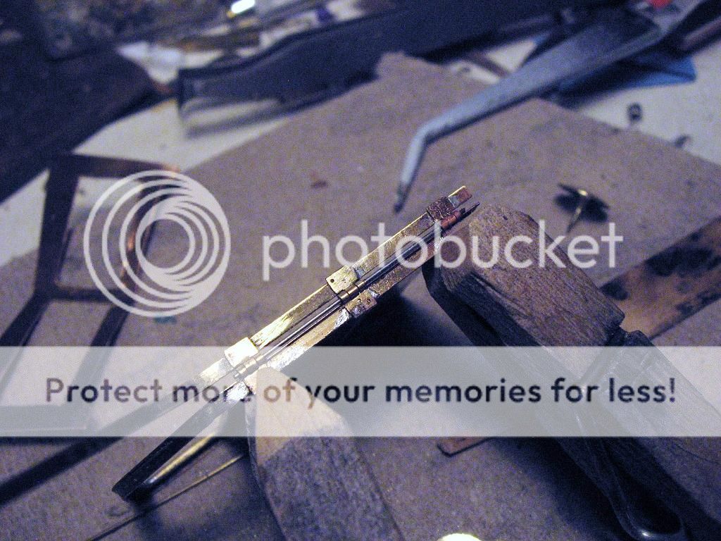

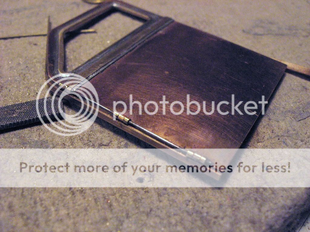

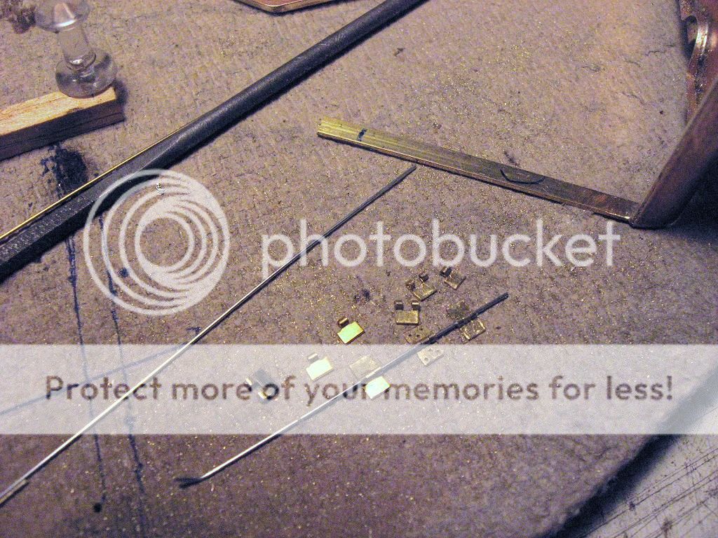

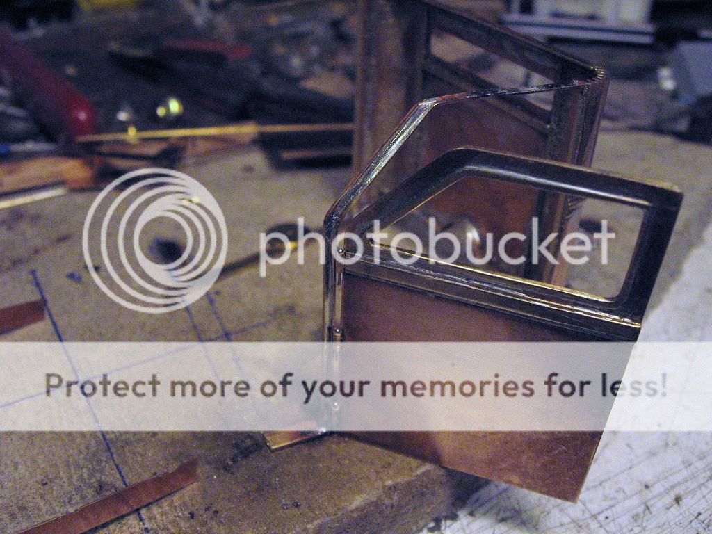

  Made up  door hinges by cutting down  "Micro-Mark"  small hinges....

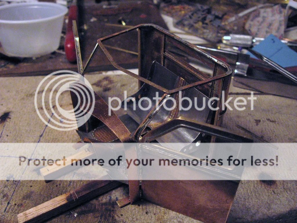

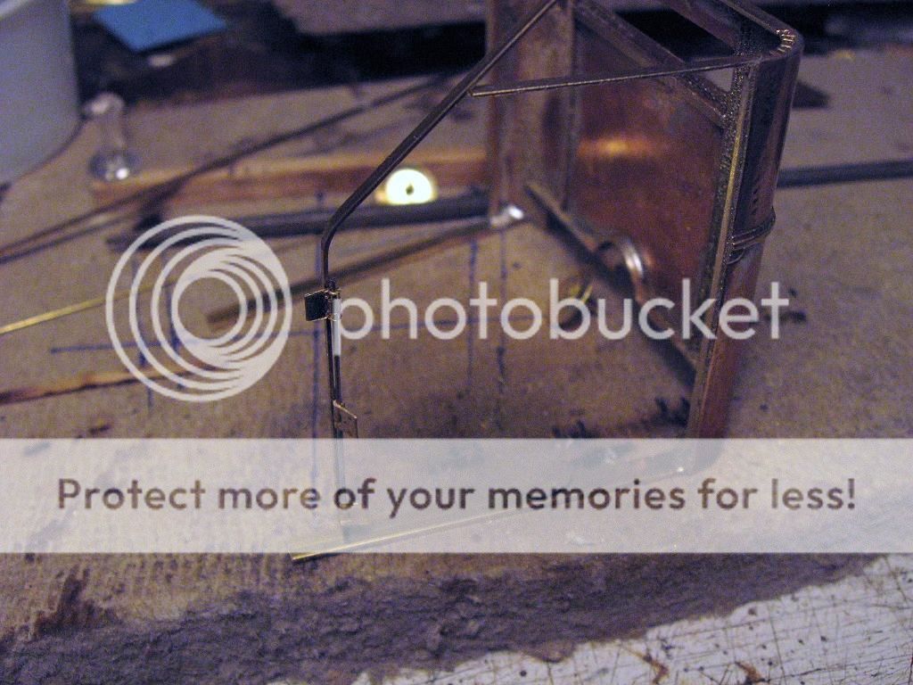

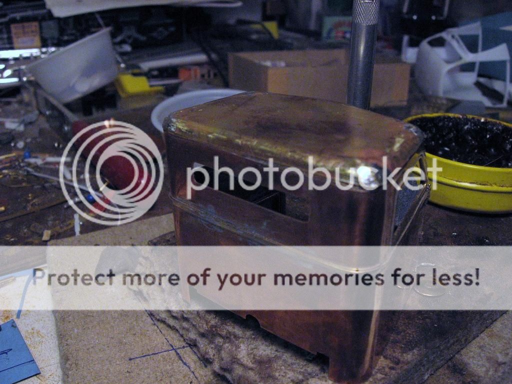

  Mock up time,  the cowling piece is not soldered in yet..

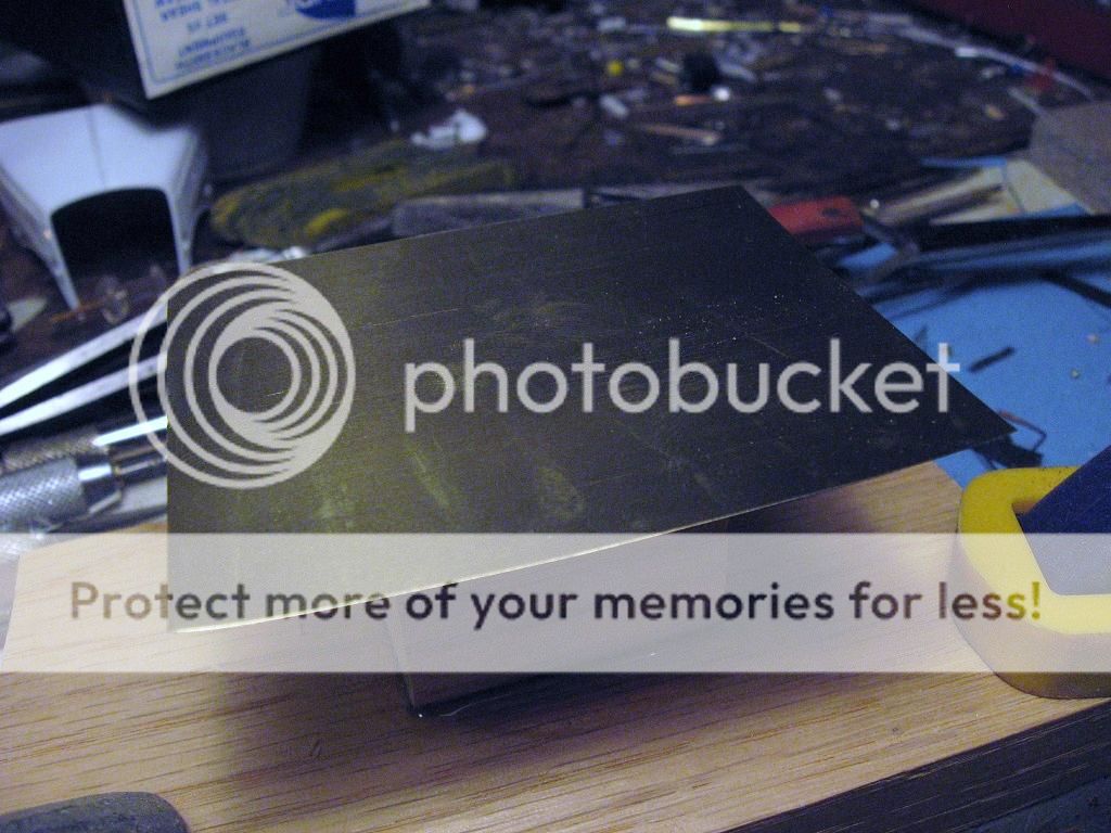

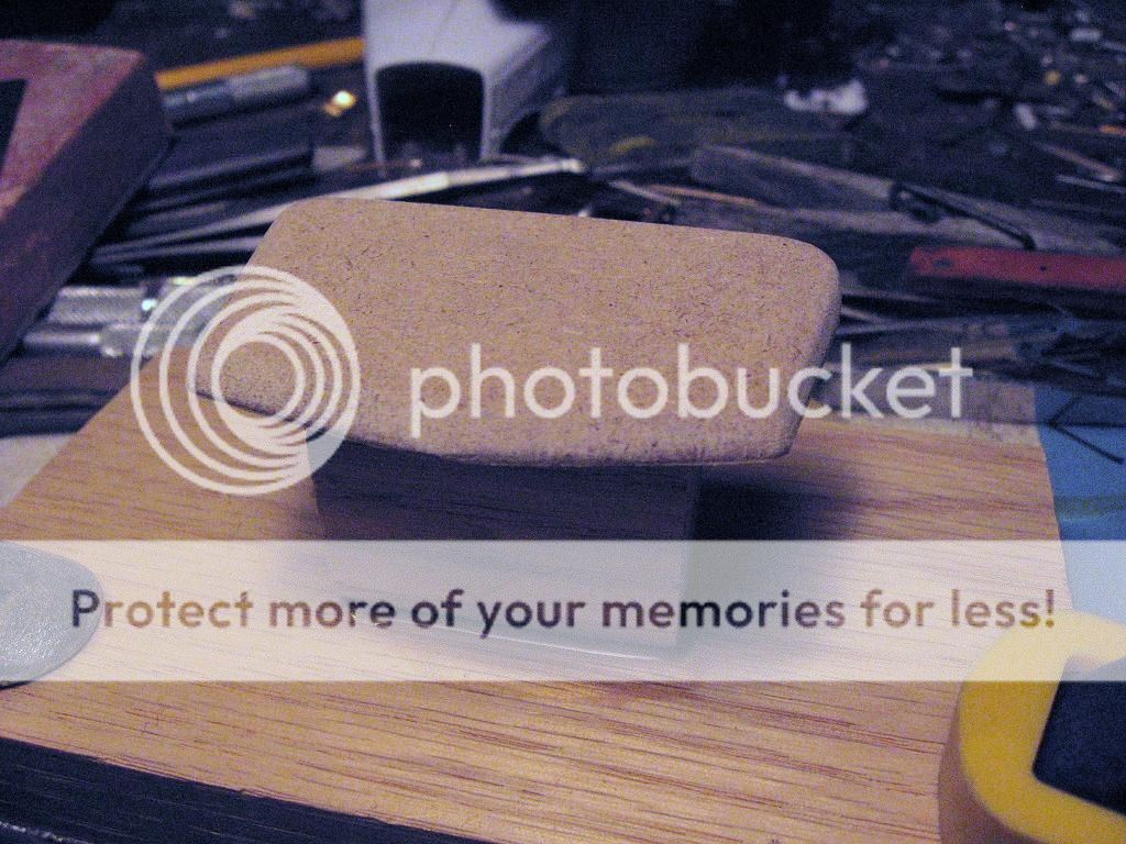

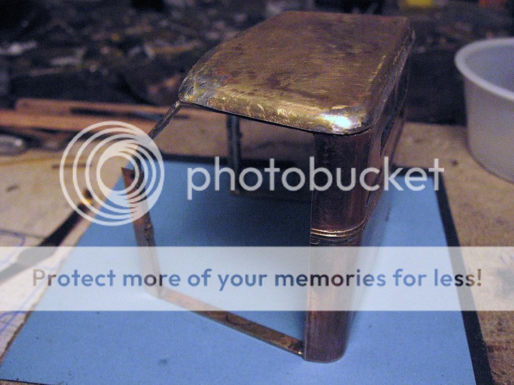

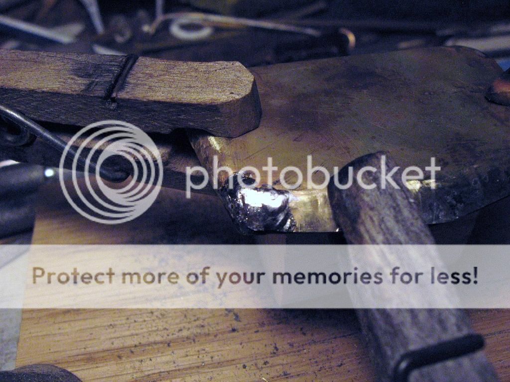

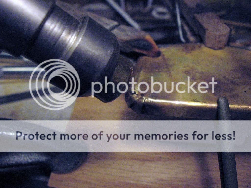

Now a roof,  .005 brass sheet that is heated cherry red then beat down around the form.  Corners are 'pie cut'  then filled with solder..
  That is all I have for now,  thanks for looking in!

Fan-TAS-tic brass work.
How you did the corners of the roof reminds me of lead paddle custom work back in the 60's.
Each piece of this model is a work of art. Great job so far - can't wait to see more.
Beautiful hinges, too.

(I "think" there are only 2 hinges.....)

I am surprised the .005" brass on the roof does not distort with the heat. The top is nice and smooth. Very much a master craftsman at work. It appears very little in sophisticated machinery or CAD drawings are used here.
Nice job Randy, thanks for sharing.
