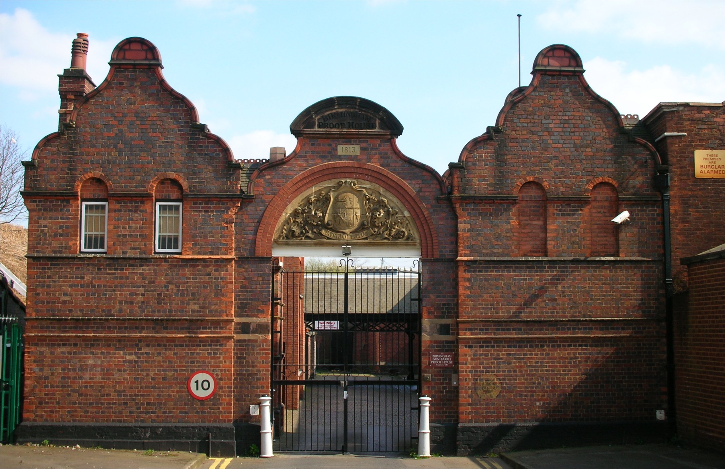

Can you sculpt with this tool?  I am looking for ideas on how to approach something like this?
. The thingie above the gates?
Jim
Jim Smith-Wright
Wrong tool for that job.   It would be sort of like trying to make that by building up layers of paint in an airbrush, but in reverse!
