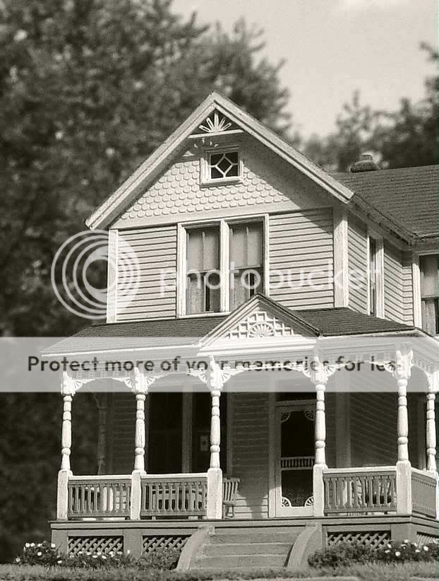

Something I've been working on a while.   Always liked the looks of decorative carpentry in 1/1 scale, the HO scale selection was very limited and not what I wanted, so I made my own.  Will offer an assortment online shortly, meanwhile I'll have the parts sets available at CSS this week.

Don't forget folks this is 1:87.1. We look at all sorts of larger scale stuff on the forum but not much HO. This is not Burn 'n Box like so many others sell these days. This is art.

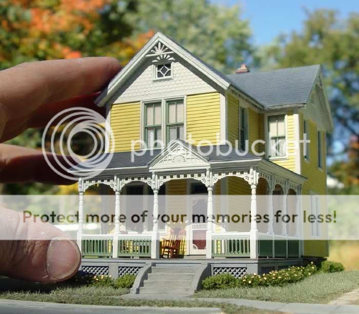

Dave sent me a couple of color photos of this model recently. I put one up as my work computer desktop. Various co-workers, men and women, asked me if it was my house and what a nice home it is. I had to tell them it's a model that can fit in your hand.
Dave, how about something in the photo for scale?

I don't know about the feasibility of laser cutting styrene sheet, but if its workable, you could glue the trim on with regular liquid cement.  No weak, potentially messy white glue bonds!  No disappointment when the last bottle of CA on hand is dry and frosted!
Styrene will laser cut but not to the degree of precision and sharpness I need.  The material I use for details like this is a .0145" thick resin impregnated cardstock, its actually much stronger than styrene of the same thickness.  Takes paint very nicely and glues really well with CA, the glue is absorbed a little, so smears disappear.  Proving once again, Russ's point about the versatility of paper!   :)
