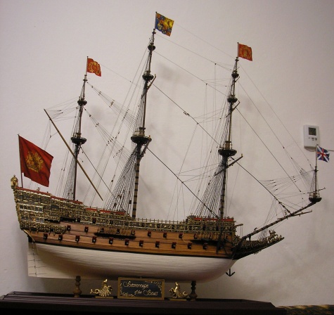

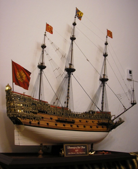

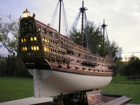

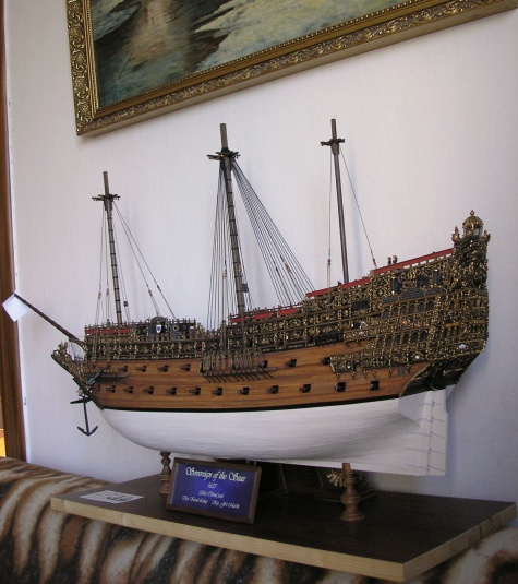

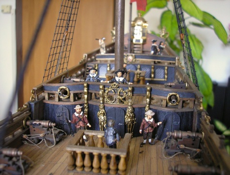

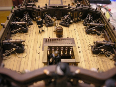

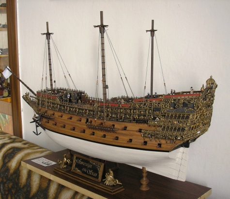

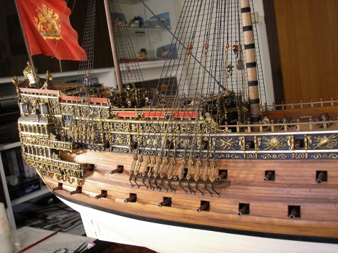

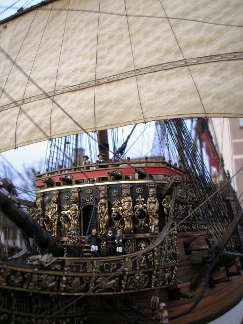

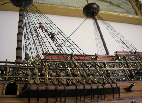

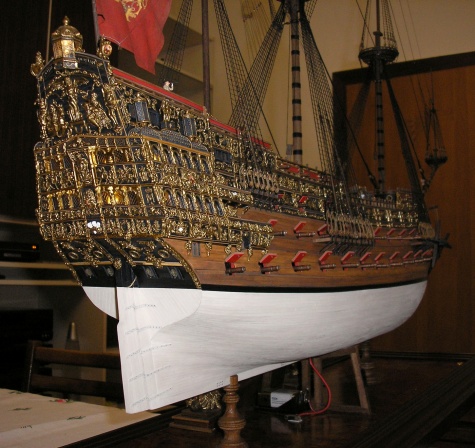

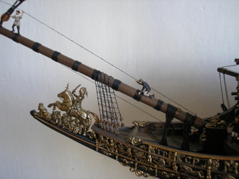

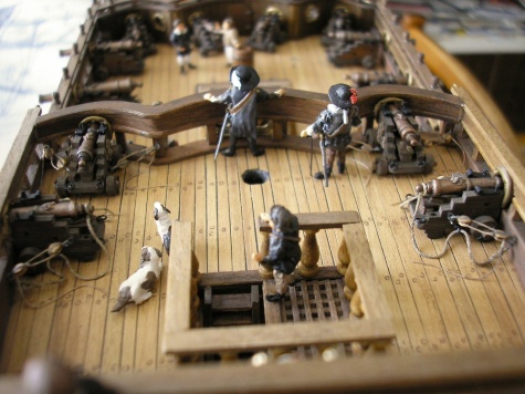

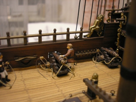

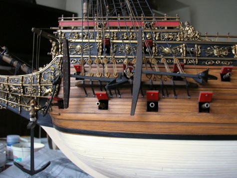

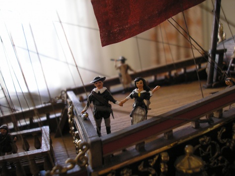

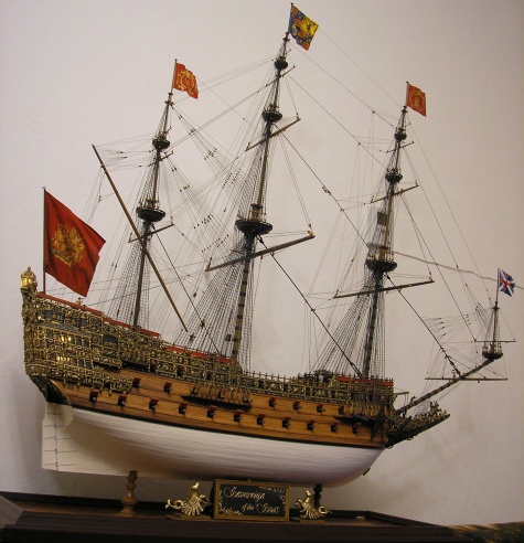

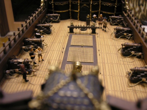

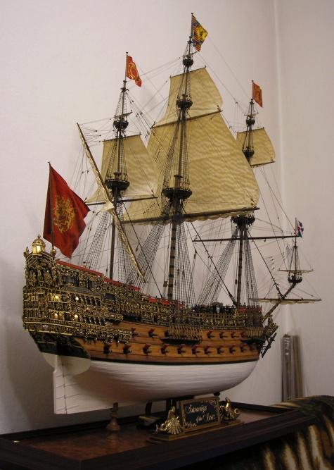

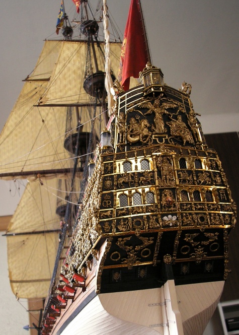

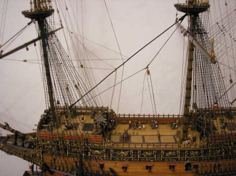

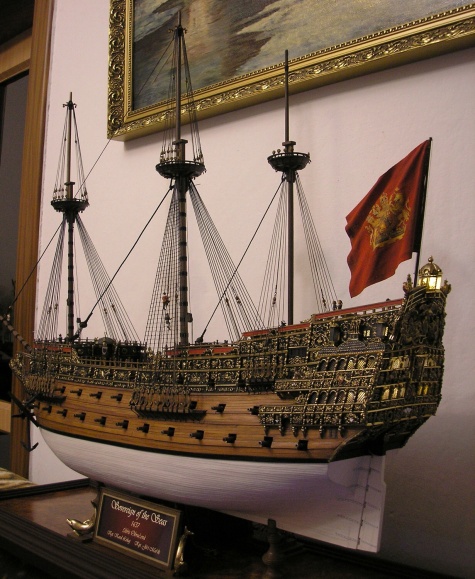

Here you can see finished details around the cannons. SoS also has a new and improved base and several other decorations.
Upper deck
Quarter-deck
Half-deck
Forecastle

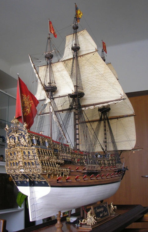

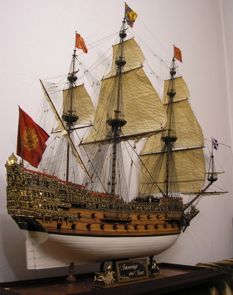

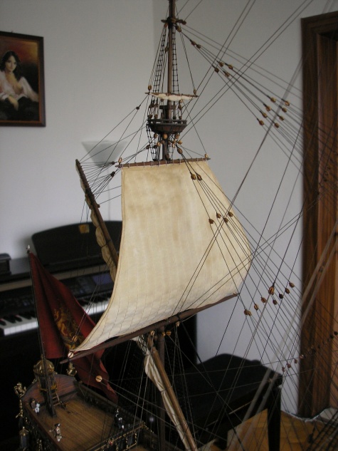

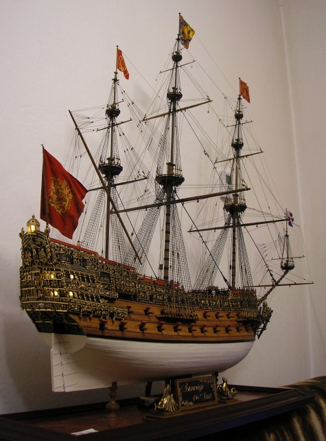

Masts and standing rigging - second part:
DORIS

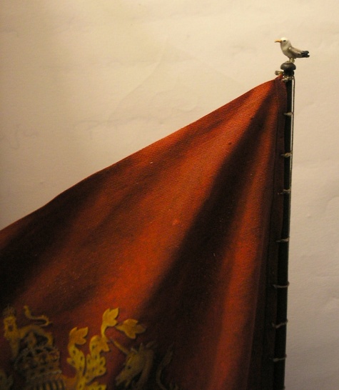

All masts are finished now. Sovereign is almost 100cm tall. I took some photos during making another flag, so you can have a look at my technology.

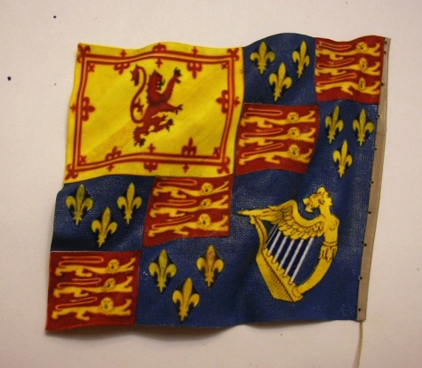

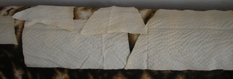

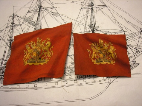

How I made the flags for Sovereign?
I used a very thin natural cloth (for example from hanky) which I dyed by Tamiya colours ( I use water-thinned colours).
The shaping of the flag is done with a warm air during paint drying -  ideal is a hair dryer.
Image is made out of paper - printed on an inkjet printer on matte photo paper. After printing the image is first oversprayed by clear varnish (I use acrylic spray by Motip) and then it is necessary to reduce thickness of the paper. I separate the lower layer of photo paper by a sharp knife or by spiky tweezers. After cut out  the image goes to the flag and itĀ“s gently colored to achieve more realistic appearance. Finally the flag is locally dyed by a hardener and the flag shape is improved again by using a hairdryer.
Here are some pics of making another flag for Sovereign:
Printed picture on photo paper was oversprayed with Clear varnish (Motip)
I used a very fine cloth and dyed it with water-based paints from Tamiya + hardener.
After applying the last colour layer I began to shape the flag using hot air to achieve the wavy shape.
The lower layer of photo paper was separated using spiky tweezers to reach the thinnest painted/printed layer as possible.
Each paper part is modified this way. Then it is placed on the flag and itĀ“s shaped immediately before the glue dries.
Done:

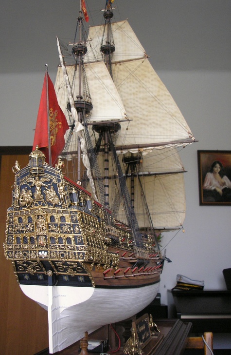

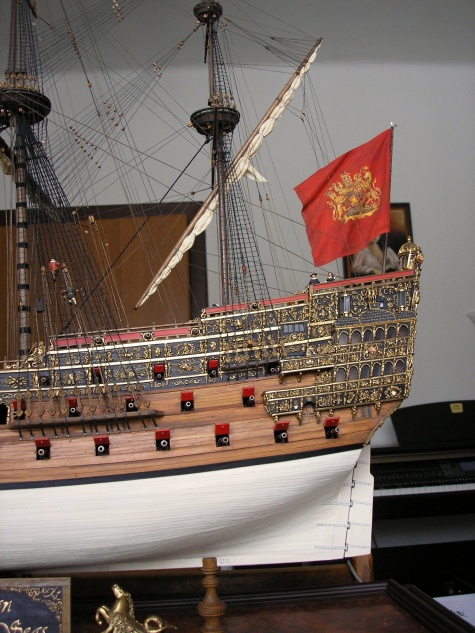

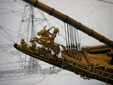

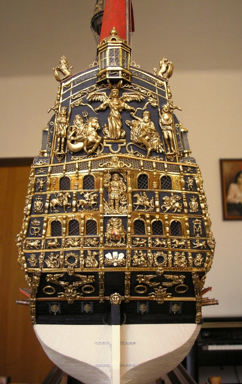

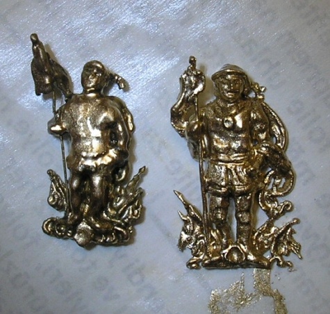

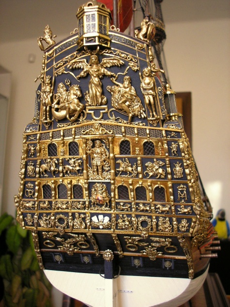

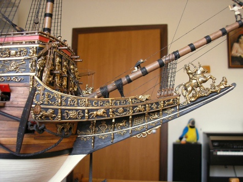

Some decorations and sculptures were improved or made again and replaced original ones.
Jednorožec na bočnici galionu taky proÅ”el změnou:
Finally, it was made the last and biggest anchor:

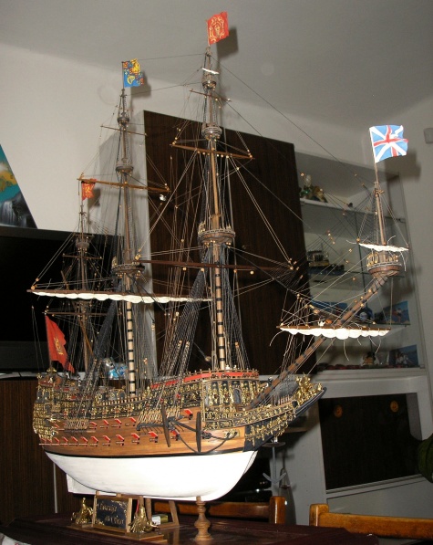

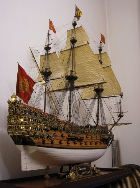

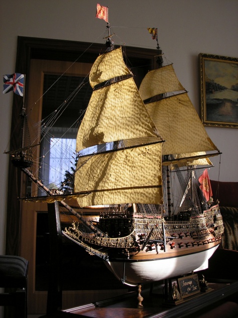

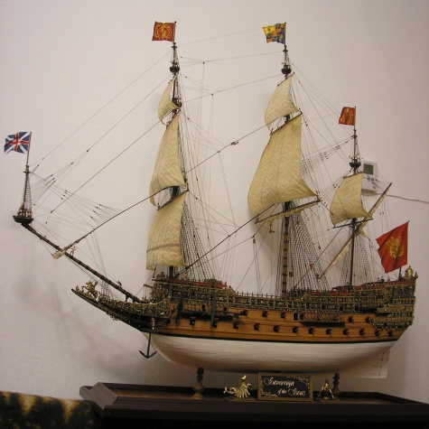

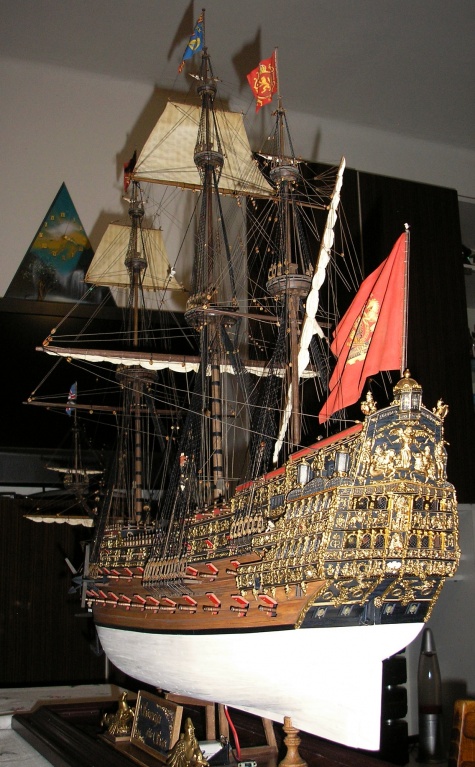

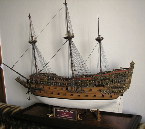

Stand rigging and yards:
DORIS
DORIS
DORIS

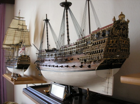

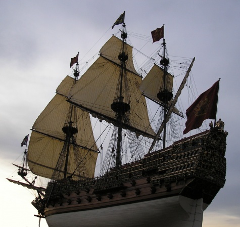

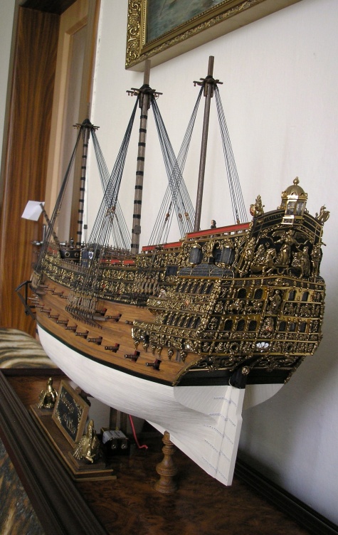

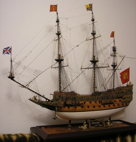

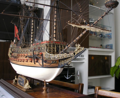

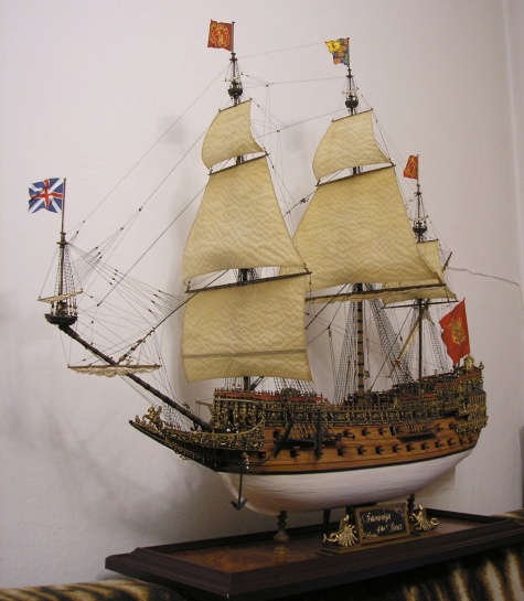

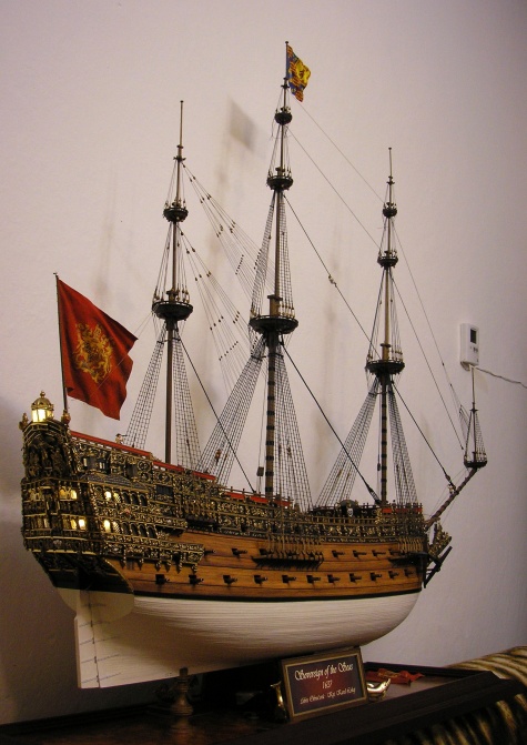

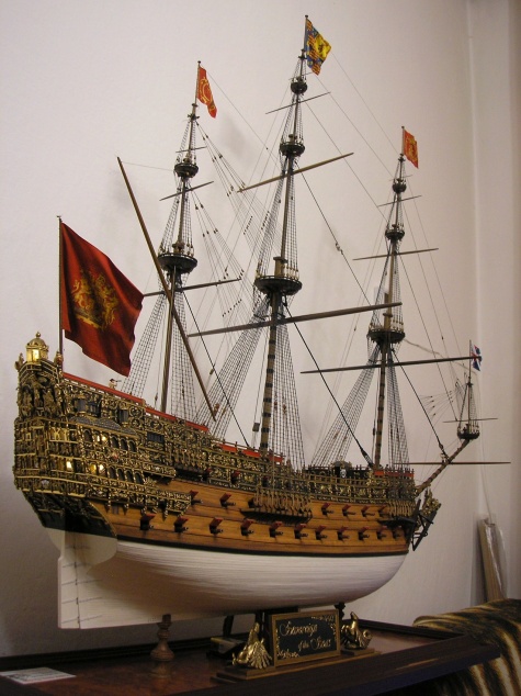

Sovereign of the seas together with me  ;)
Here is my presentation of Sovereign of the seas, so you can enjoy it. Music is my own, I like playing the piano as well as building models. This is my present for you all:
