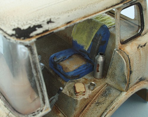

You can't beat oil piant for giving subtle effects  a wash. It's really coming together nicely Ken.
KOOL!
Seat looks muchbetter!

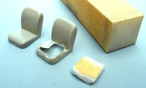

Could you give me a little info on the seat modifications and color(s) used for the duct tape?
Also did you do anything special to get the crackle on the white or is it a happy accident?
Shouldn't be taking this long to empty those little beer cans....
pwranta193
Great duct tape... and that seat makes me think of rides in similar vehicles abroad - that towel and the decrepit foam make me want to shower  ;D
nk
Waxed paper fro a sandwich...I haven't seen that since school. You have a great eye Ken.
If my kids get their lunches made by their mother, it is still waxed paper. Good stuff - keeps the contents fresher longer. Would love to know where the sandwich actually came from (ie what is it made from).
Obviously this model is from a time before fast food!
Thanks, guys.
The seat was done by thinning the plastic from below until it was paper-thin, then picking
away at the top with a blade until it looked like a torn seat cover. The cushion is a worm
section of a fingernail-sanding-pad:
The tape is real masking tape brush-painted with Metallizer "Magneisum" and touched up
with chalks; the sandwich is sanded and painted sheet styrene.  All you really need to do is
add a thin wash of light brown for the "bread" color, and darken the edge for the crust.
Then add cardstock lunch meat and paper bag lettuce........

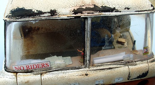

Here's tonight's progress.  A shot-out back window....

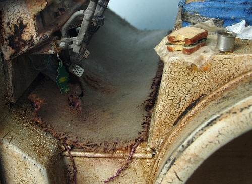

....a dirty rug...
...and some dash & windshield details:
Hi Ken, I am still catching up as time permits. I just went through the whole thread, enjoyed looking at the progress, the security gate is a gem, and the inside of the truck is very interesting. I think that the hula girl is great but a little too clean, unless of course it was just put there.
Wonderful work overall.
Don't just tantalize us with those details; please explain how you created them! -- Russ

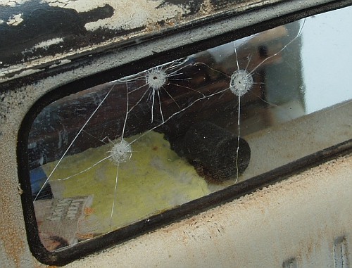

Some excellent details.  Just how did you do the bullet holes???
