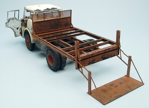

Here's some progress on the truck.  I painted and started weathering the bed.
The cab is just mocked-up on the frame.  Nothing's glued in place yet and the
truck still needs mirrors, bed wood, sides, etc......
KILLER BED DUDE!!!!!!!!!!!!!!!

I am "assuming" your own design of a prototype?

Thanks, Marty.
A "Lift Gate" search turned up photos of this design.
It had kind of a delicate, spindly look that I liked.
Very nice, I like the lift gate!
Not bad. Not bad at all. -- Russ

That is really cool!!!!  Just some remarkable work as usual.

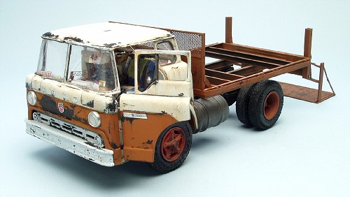

That´s a great truck Ken! Every detail is spot on :o! Now we expect pictures of the finished diorama when you take it to the show in Peabody!
Anders  ;D
Ken the detail in the cab is great, I thinks that the maps are spot on, The beer or pop cans look like paper and not printed metal, I think that given the incredible quality of the rest of the interior I wonder if there is a way to bring the cans up a notch? I only ask this because I think that the cans take away a little of the finesse of the rest.
Point taken, Michael.  Maybe a gloss coat with some weathering
(hand prints, smudges, etc) might do the trick.
I'll try it...........
