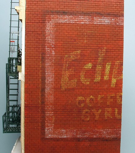

Hi Ken,
I used to engrave the stones as well as you.
Meanwhile, I've had practice, drawing on the computer to the stones and engraving with CNC.
Now what really goes fast, I can not say exactly.
But your score even more convinced that bemahlung of advertising.
Here's a closer look at the ghost wall:

Each wall took about 3 hours.  It was a good kitchen table
project in the evenings after long days of sight-seeing and
generally doing nothing.

That really captures the look of a faded ad on a brick wall. Your brick carving gives a great effect...after I carve a lot of bricks, I feel like I need a vacation!

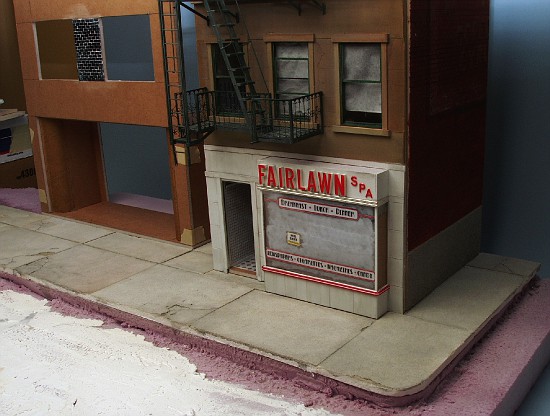

Had time over the holiday weekend to get back to the Arcade.  The base is
made out of pink rigid insulation (my new favorite base material) and measures
in at around 22"x 38".  The sidewalk is Hydrocal cast in a big sheet and scored
at the expansion joints, broken and glued onto the foam with silicone caulk.
I did something a little different with the sand mixed with the plaster:  I sprinkled
it on the bottom of the mold instead of adding it to the plaster mix.  See the whole process here:  http://public.fotki.com/khamilton/models/model_how-to/how-to-make-deterio/
No written description yet, but the photos will give you an idea.
Next up are the curb pieces, which are in now but weren't when I took the above photo.

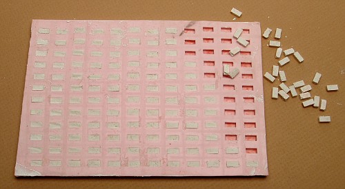

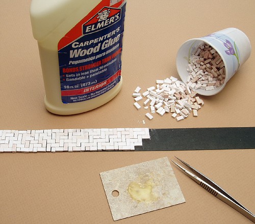

The asphalt street will have a brick gutter, which I'm making by casting plaster bricks in
a mold made by a friend and gluing them to a long strip of black construction paper that
will be glued to the street before the asphalt is poured:
More to come.  Thanks for looking............

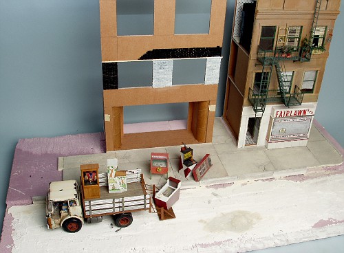

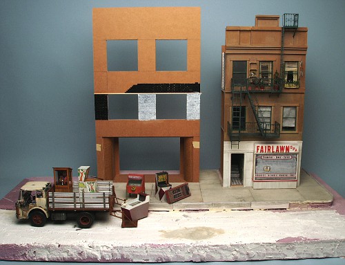

Ray, the base measures just about 22"x 38".  Here's a quick, roughed-in composition shot:
The empty lot on the left will contain debris from a former building at that location; the Arcade
in the middle will be in the process of being dismantled, with perhaps a wood scaffold on the
facade, while the games are loaded onto the truck.  The apartment house on the right is, except
for the closed storefront, managing to hold its own in the neighborhood, at least for now.
