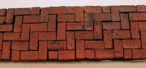

After the plaster bricks were glued to the strip of black construction paper,
the bricks were painted with a not-too-neatly-applied coat of Burnt Umber:

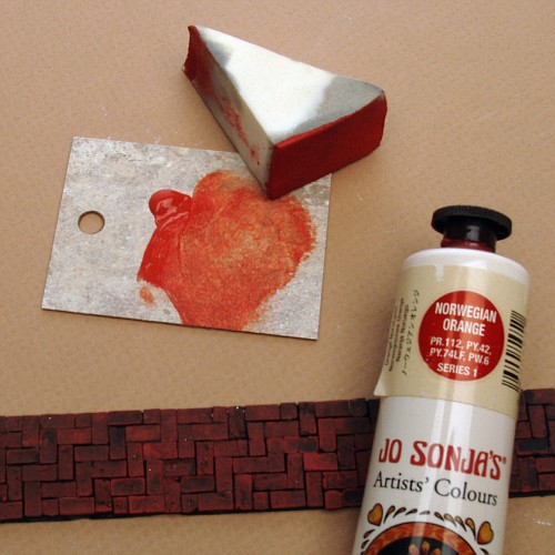

Next, the bricks were lightly dabbed with Norwegian Orange applied with a
make-up sponge. Lots of Umber was allowed to show thorough:

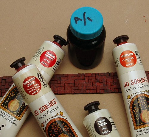

This was followed by dabbing on other brickish colors like Cadmium Scarlet & Vermilion,
along with a few more dabbles of Umber & Orange.  When that was dry, it was washed
with a coat of A&I to give it some depth:

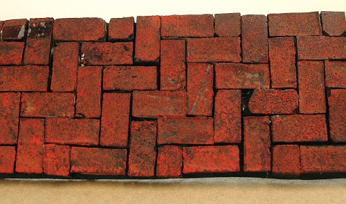

Here are some of the sections of the 36" strip:

I am really annoyed by the realism you have achieved in a quarter of the time I have. Using plaster and painting the bricks is obviously much better/quicker/realistic than the current method I am using with plaster and cement oxides.
Oh wait, the reason I don't paint my bricks is because I can never get that level of dirty realism that you have. Damn.  ;)
I'm really annoyed with your realism, too. The modeling is satisfactory nonetheless. -- Russ
This will be a great diorama with an unusal concept and story. The color of the bricks is excellent.

Ken those bricks look great. One thing I do when the bricks chip and the white plaster shows through is to apply diluted red paint to the chipped area so that you have a bright looking chip, just like a real brick.
mlcolbert
and that would be the one reason I would leave the the plaster 'a naturel' the extra red would make it.  Thanks for the tip nk!
