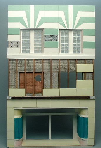

Those meters came out nice. Neat gate too.

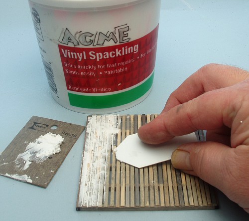

Here's a quick little SBS on how I just did a plaster lath wall that will be seen from the back.
Building a the wall in scale is done the same way as the old craftsmen used to do it.

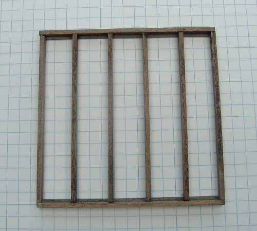

First, I framed a wall with scale 2'x 4" lumber.  I squared the wall over graph paper:

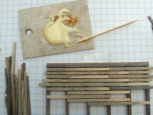

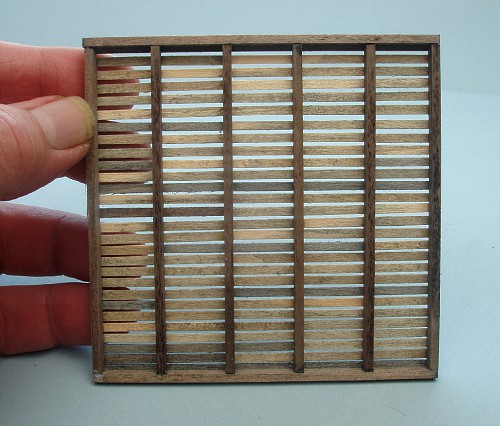

The lath was done with thin, pre-stained strip stock:

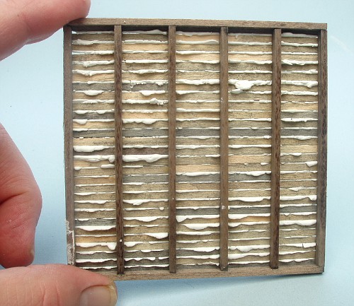

From the back, the wall looked like this with the lath strips in place:

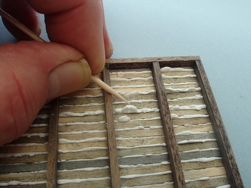

Next, I applied spackle to the front of the wall with a styrene trowel, squeezing a little
bit through the spaces between the lath:

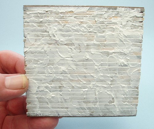

From the front, the finished wall looks like this.  Since this side of the wall won't be
seen, I'll leave it like this. If it were going to show, I'd sand this side and apply a finish
coat of spackle:
The INTERESTING side of the wall is the back:
In some spots, too much spackle oozed through, but that's easily chipped off
with a toothpick after everything dries:

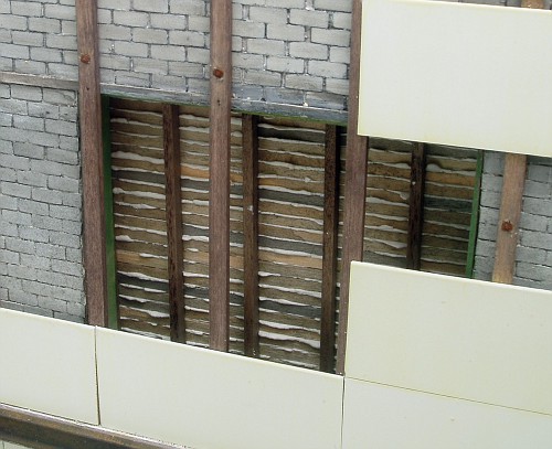

This wall will be placed in front of a window in the Arcade building that was sealed
off during an earlier renovation.  Not a detail that will jump out, but it adds a little
more interest to the scene:

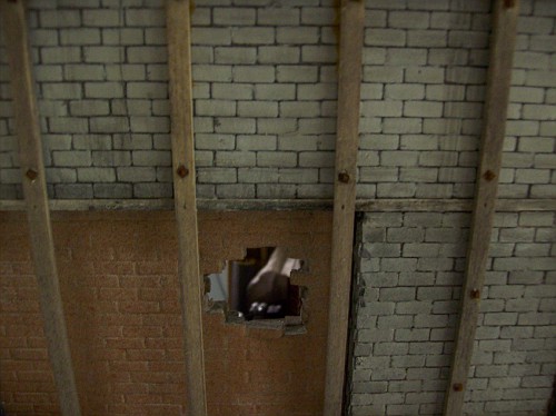

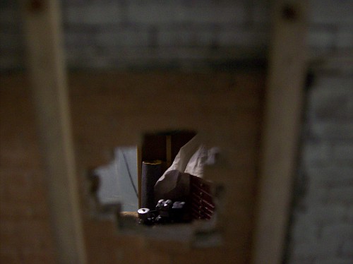

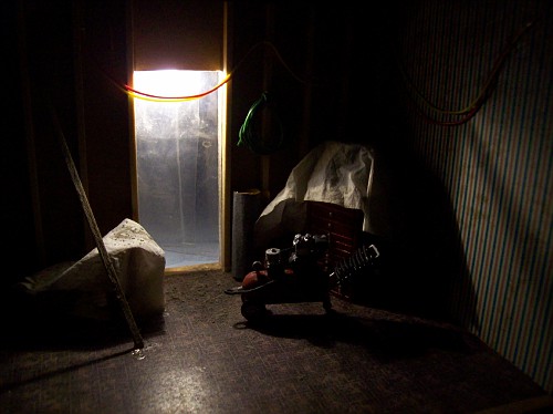

The hole in the bricked-up second floor window was going to be simply a hole,
but I thought maybe it could serve as a basis for an inconspicuous detail...

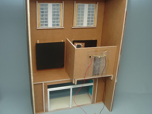

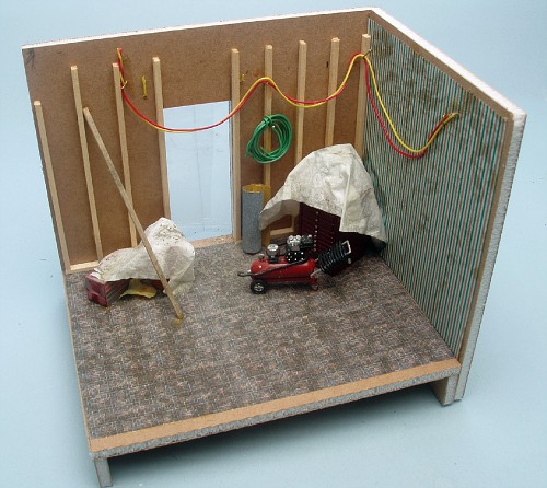

....so I made this quickie box with some general details for inside the "hole":

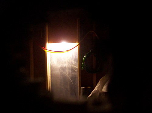

An LED behind the plastic curtain over the door creates this effect:
Here's the box placed inside the Arcade building behind the hole in the brick wall.
The LED at the top center of the door is on, but you can't really tell in this picture
Here's what all this is trying to achieve.  When the viewer notices the light and peeks in
the "hole", a small and somewhat difficult to see interior room will present itself.
Not something you might notice the first time around, but something to keep you
interested during the second or third look......
