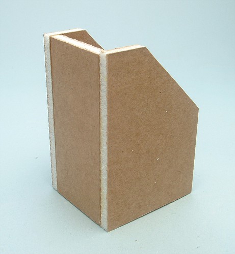

Stairway to the roof - the basic Gatorboard form:

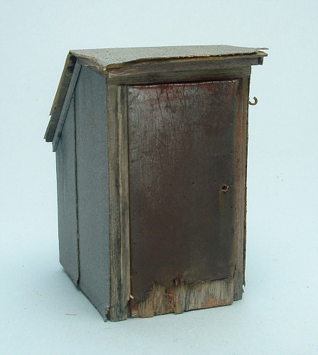

Etched aluminum over model airplane plywood door; wood frame, painted sandpaper siding:

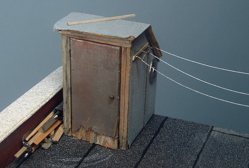

In place on the roof:
In the real world, the sloped stairway roof would extend all the way to the building's flat roof.
Since this is a "cut-away model", the back of the stairway is cut at the plane where the roof is
cut; however, I don't think this really works - the stairway just appears to be a shed on the
roof. I should have made the stairway enclosure longer, with more of the slope showing.
I think you're right about the cut-off bit ... immediate impression from the photo was that the stairs would go out the side/back of the building in question ... however, that door looks great!  -- Dallas

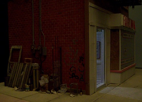

Started detailing the alley before the building-next-door went in,
but I ran out of daylight.....

Darn shame!  Loads of storyboard possibilities for the dark alley and the "somewhat" inviting open doorway ... cue Mr. Hitchcock ...
