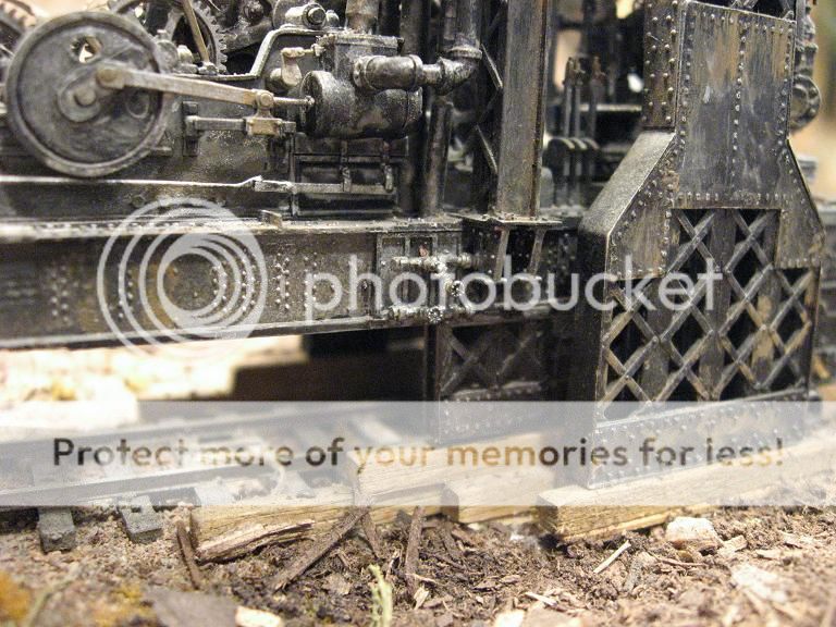

Gerald,
If your base rust color is solvent/oil based (Humbrol), and your color coat is also oil/solvent based, using solvent can/will affect both coats....there is a good chance that the yellow and rust colors will mix togeteher and make a mess. (but you can try/experiment on the underside where nobody can see).
The hairspray should have worked the way you did it (though brush application is not recommended because of coat variations and potential streaking).....but this can depend on hairspray coat thickness, on the thickness of the color coat, and how long you let the color coat and HS dry before you began chipping (you want to start chipping pretty rapidly after the color coat has set, and the thinner the color coat the better it works). I suspect another problem could be that...if I recall correctly....you are using a brush to apply the color directly over the hairspray...this can potentially cause the hairspray to disolve and mix with the color coat, thus eliminating its function as a barrier/release coat/layer.) If you are applying the color coat with a brush...the way Chuck does some of his...I highhly recommend that you use his approach and apply a coat of clear finish from a spray can over the HS before applying the brushed on color coat.  (this layer of sprayed-on clear should be 'Acrylic' based paint....not oil...otherwise you will can once again have the issue of the color coat mixing with the clear and thus also the HS.)
This all though, is not a big problem. Before you go crazy and try all sorts of solvents here are some potential suggestions:
Option 1:
If you do not have the problem of brushed on HS bonding with a brushed on color coat, you could use a very fine sharp needle to poke very small random holes in the color coat, and then wet the area liberally with warm water...let it seep into the holes and then try the removal. Wetting and removal may need to be repeated several times. Do this working only a section at a time.
Option 2:
Paint on your chips and wear, using fine brushes and a sponge. This is till the way many armor modelers do their wear; and it is also frequently used in combination with the HS technique to gain more control or a specific finished effect or wear pattern/coloring.
For quick example, these chips and wear were all painted on, no HS was used.
HTH.
