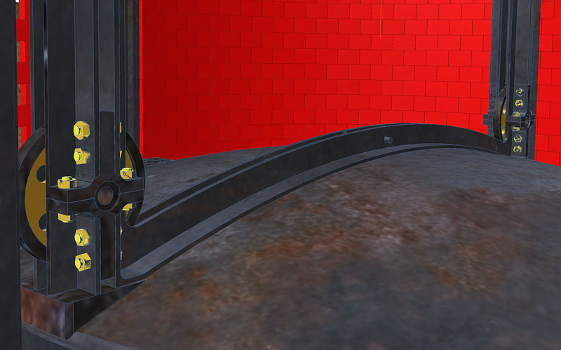

The two floating container carried the bridge with two columns of four L-profiles.
On each side rolls were placed with 30 cm in diameter and about 2.5 cm in width.
They were conducted in corresponding U-profiles. Therefore the float glides smoothly in the shaft and does not hit the wall.

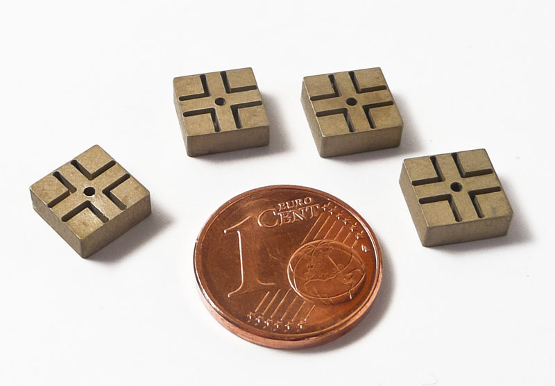

Four 8 x 8 x 3 mm brass sockets were equipped with four 0.5 mm L-shaped grooves which will serve for secure attachment of the supports to the float.
Schwimmer_26(fspg2)
Schwimmer_28(fspg2)

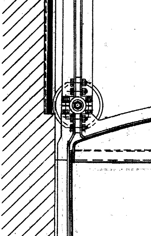

Volker gave notice that the attachment of the supports maybe not modeled accordingly.
At the time of construction of the lift bridge in 1899, all pieces were riveted. The base soccets (picture No. 26) should have been welded - but that was not possible at this time. I have to agree with Volker.

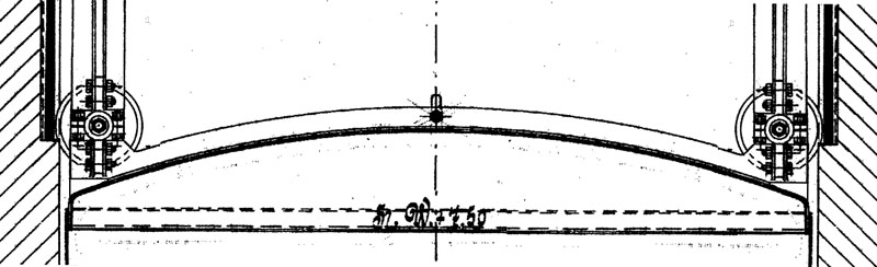

Although there is a drawing, which shows a solution with a band profile around the float,
Schwimmer_07 (fspg2)
Schwimmer_29(fspg2)
but on any photo, there was a indication like this. All plotted diameter show no peripheral profile band. Unfortunately I have no real detail drawings of this area... it's been a burden, if you count the rivets: wink:

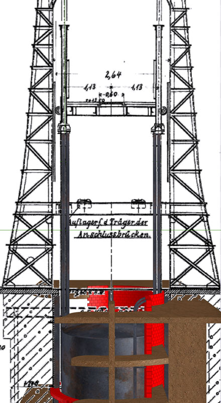

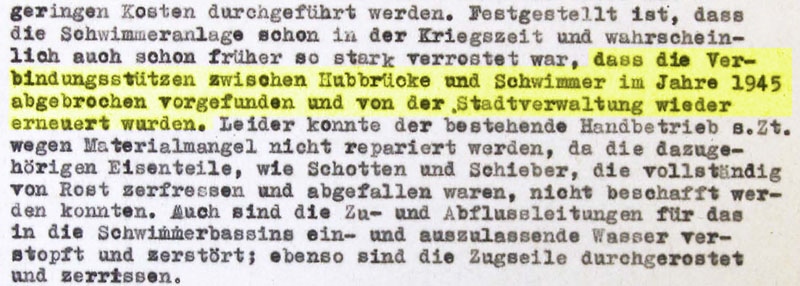

A letter of 1948 describes the desolate status of the bridge  after WW2. Here the idea for my execution was given:
Schwimmer_32 (fspg2)
So the base and the columns were replaced after 1945 by the City Council ... at this time they could be riveted as well as welded ...
Schwimmer_30(fspg2)
Slowly it comes out of the ground in the open pit, the supports will be cut on next weekend.

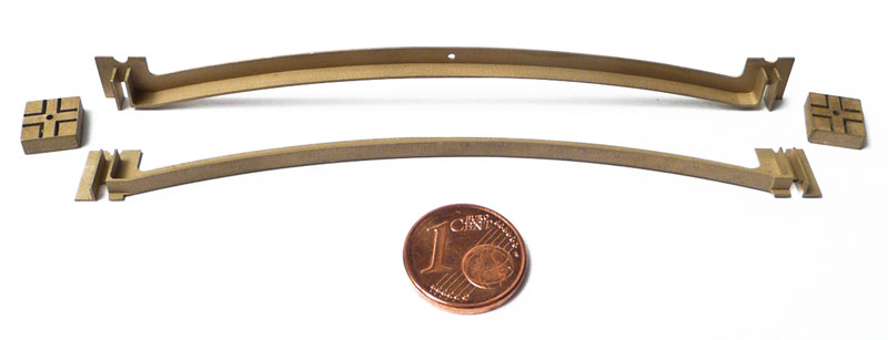

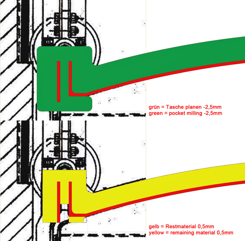

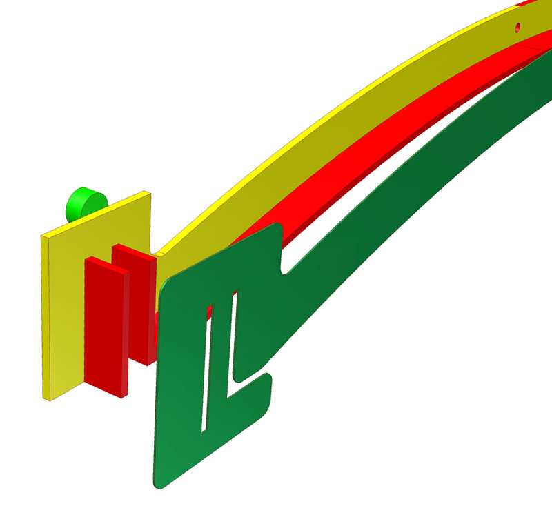

To solder a few items together only, I draw up the two lower L-profiles in one sketch:
Schwimmer_37(fspg2)
Schwimmer_36(fspg2)

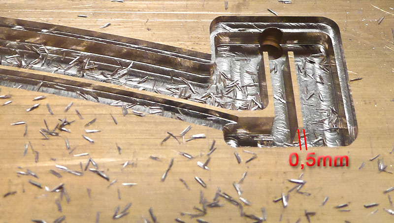

A 3mm brass sheet was fixed with double-adhesive film to a MDF board. Next I attached the plate to the milling machine.
First the holes were drilled (light green). Next I milled the dark green area as a pocket 2.5 mm deep.
Schwimmer_33(fspg2)

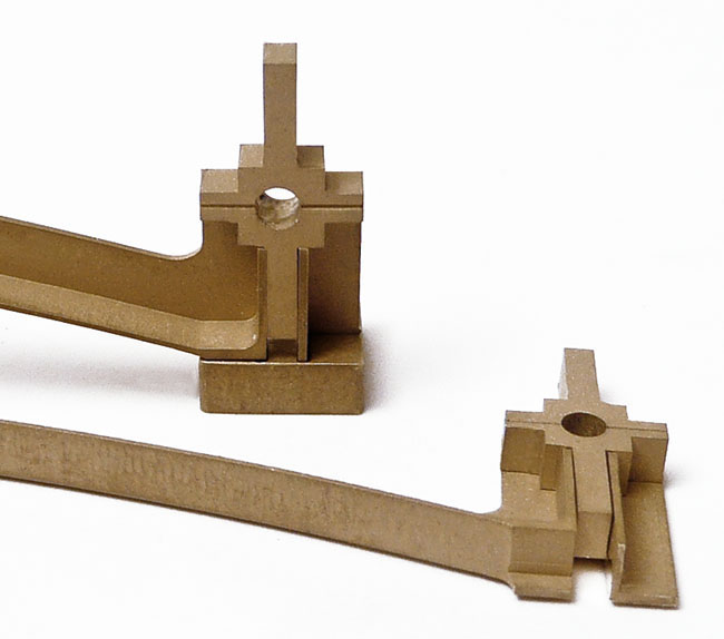

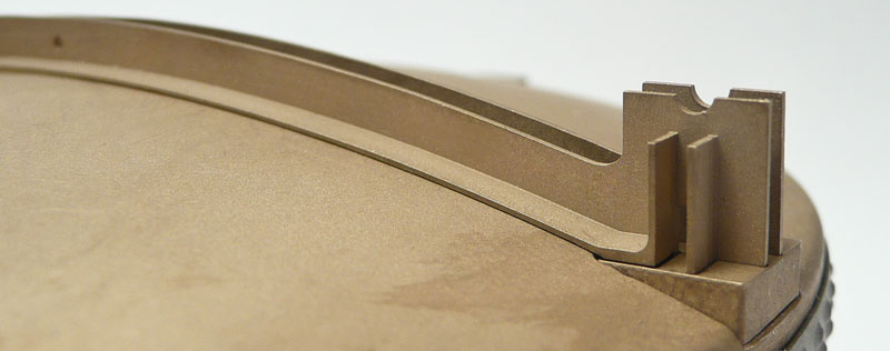

After cutting the outer contour with a 1.5 mm-cutter (several passes in 0.8 mm steps) I got  the finished profiles (yellow and red) .
Schwimmer_34(fspg2)
On the following  picture you can see the profiles assembled loosely. They fit neatly into each other thanks to CAD.
Schwimmer_35(fspg2)

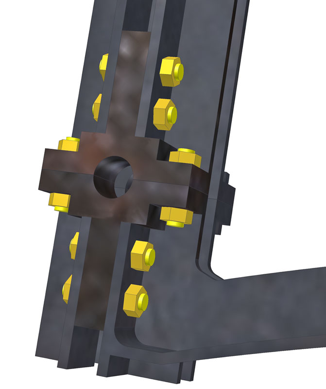

The next step will be the ,,cross".
Schwimmer_38(fspg2)

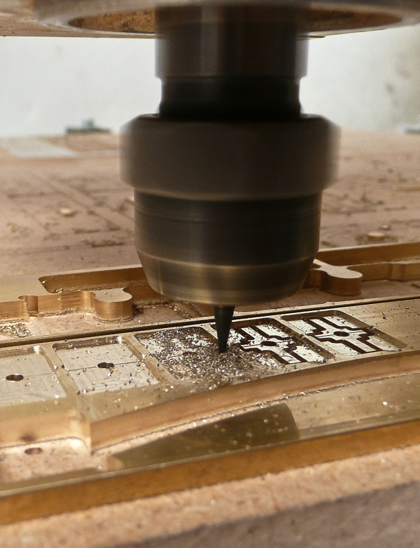

Last weekend I finished the "cross" quickly. 3mm brass material was used as before. Initially I milled a pocket  0.5 mm deep to get the required height of 2.5 mm. Then the 2mm holes were drilled , a V-cutter did cut a groove of 0.1 mm deep and a 1mm milling cutter did the rest.
Schwimmer_39(fspg2)

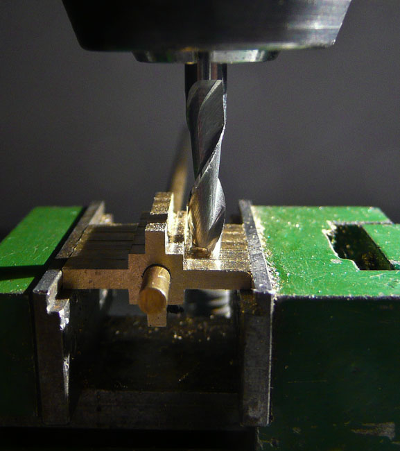

The used 1mm cutter produced 0.5 mm radii in the corners. To get square corners I lined up all parts to a 2mm wire and putted this unit to my mini vice.
Schwimmer_40(fspg2)
Schwimmer_41(fspg2)

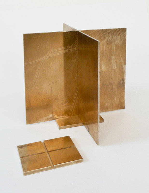

The four guide rails in the shaft must be mounted exactly at 90 degrees.
Schwimmer_44 (fspg2)

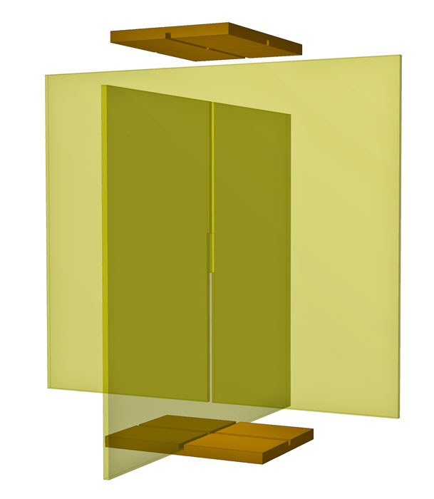

Therefore I have milled two 1.5 mm brass plates and put both together. For aligning two 3mm brass plates were grooved at right angles additionaly.
Schwimmer_47 (fspg2)
Then all parts were assembled. They sit inside each other very tightly. Later I can take apart the pieces and use them again.
