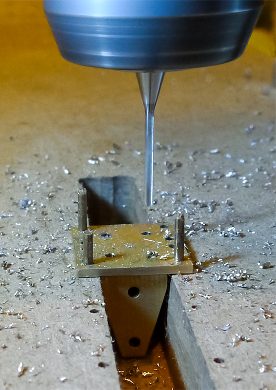

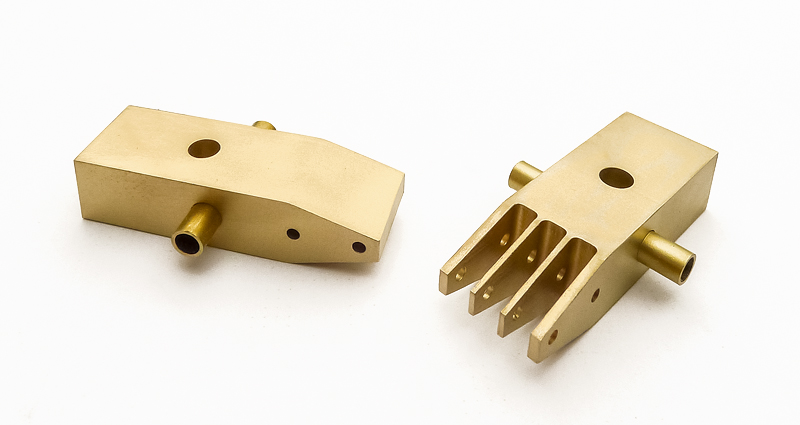

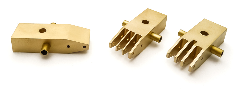

I have milled the roll holders from a 12.0mm x 10.0mm MS58-square rod.
First the two 1.2mm holes were drilled.
Into the third 3.0mm hole a rod will be inserted later. This will hold the brass part accurately in position into the gauge while milling.
Rollenhalter_03 (fspg2)
Seilfuehrung_02 (fspg2)

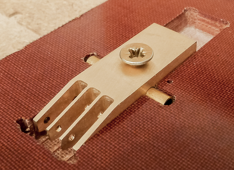

Afterthen a small pocket was milled into Pertinax and the brass block was putted inside.
Rollenhalter_02 (fspg2)
Another hole was drilled to allow a small screw to fix all.

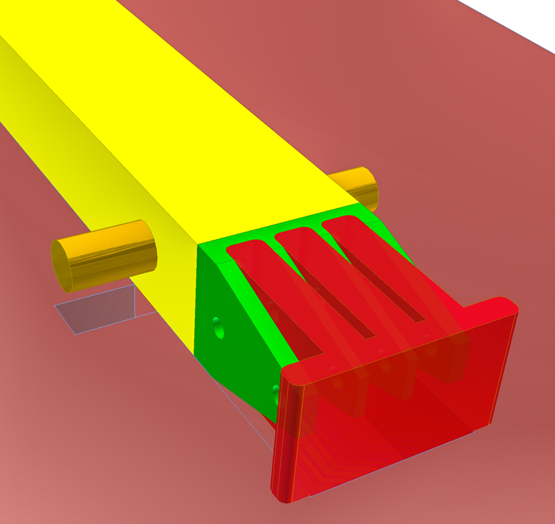

Next the above red marked area was milled with a 1.0mm cutter in steps of 0.5mm.
Rollenmontage_06 (fspg2)
Rollenmontage_07 (fspg2)
Rollenmontage_08 (fspg2)
Rollenmontage_09 (fspg2)
Rollenmontage_10 (fspg2)
Now I have both, 3-roll holders and such for one role.
In the next step the parts will be separated from the brass rod, so that I´ll get the green-marked roll holder.

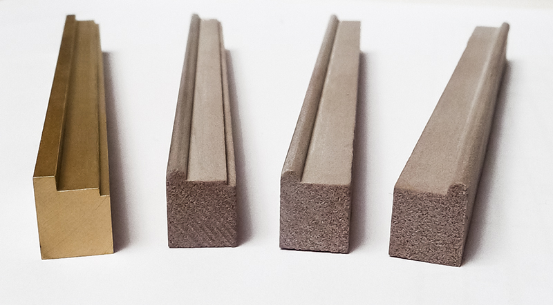

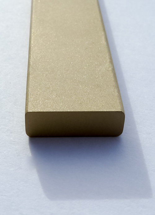

The upper metal end of the sluice walls will arise from 10.0mm x 8.0mm brass profile .
Metallkante_1_25mm_01 (fspg2)
For test purposes I profiled Ureol rods and the brass profiles afterwards.
Metallkante_1_25mm_03 (fspg2)
In a MDF gauge (8.0mm deep) the bars were tightly inserted and milled with a 3.0mm router - first the green and blue marker.
Later the 1.25mm quarter round cutter rounded the red zone.
Metallkante_1_25mm_02 (fspg2)
