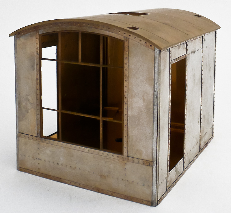

While they may "only be rivets," to the crazies on this forum, the quality of details like this is what makes the model.  (They don't call us rivet counters for nothing.)

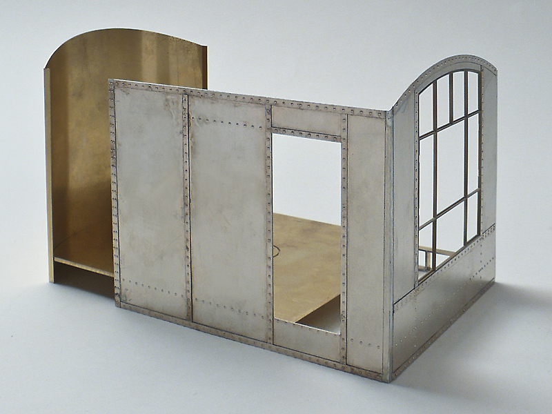

First I blasted the parts with a small sand blasting gun Badger, like this.
The blasting material I bought here, it has a very smal grain size.
For larger parts like the crane cabin this blasting gun is to small but it works - only it takes a while.
I´m using a burnishing stain from a friendly professional company. Previously I had used a stain from the Tiffany area.
At the following picture you can see the way from brass, sandblasted, two minutes bathed in the burnishing stain and four minutes at last.

The modeling and the drawing, both are two areas of my hobby. In the CAD I can determine exactly all sizes.
I still remember a few years ago when I came into contact with the CAD, there was very often the "how can I do it?" in my head. Today, I can check with the CAD already the idea even before production! It does not have to start with a huge project. Step by step you can continue.
A friend helps me very well, so I'm now able to realize my next step.

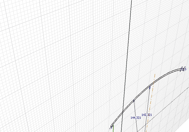

First, the curvature of the roof was drawn from the side and extruded into the depth.
Münzel-Kran_045 (fspg2)
It was followed by a new layer from the top, which received the contours of the openings and the rear roof rounding. The next step was a negative extrusion into the depths of everything - like a punch.
Münzel-Kran_046 (fspg2)

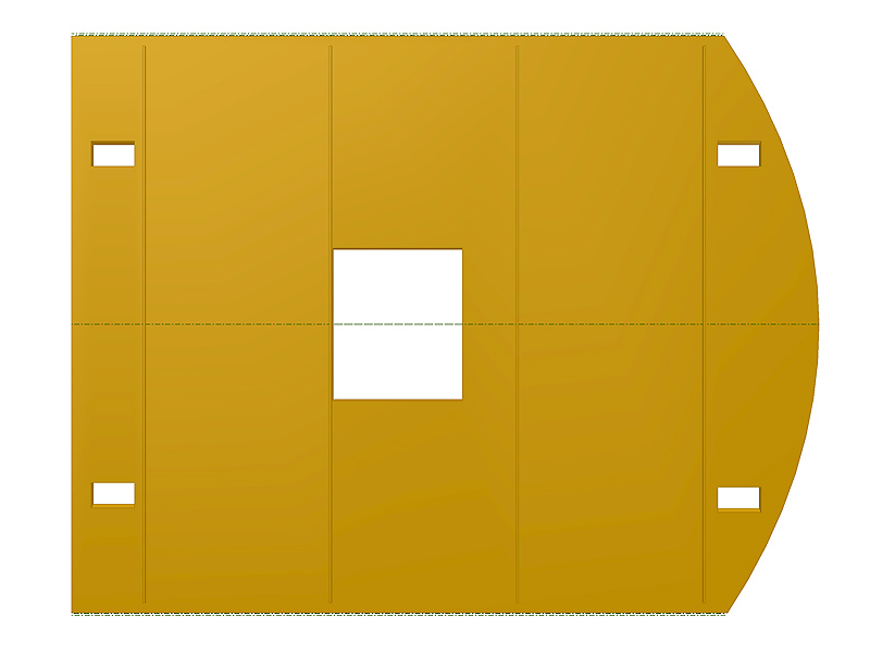

It was followed by a winding-up of the rounded roof, in order to generate a DXF file. For each milling the corresponding lines have been inked.
Münzel-Kran_047 (fspg2)
The  visible black lines mark the lower contour of the once vaulted roof. They should not be milled.
Münzel-Kran_048 (fspg2)
