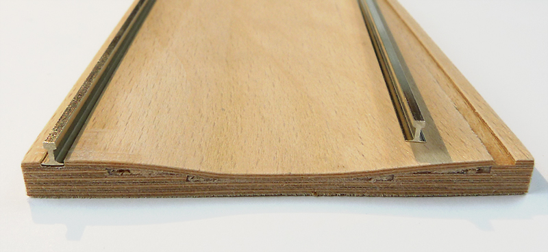

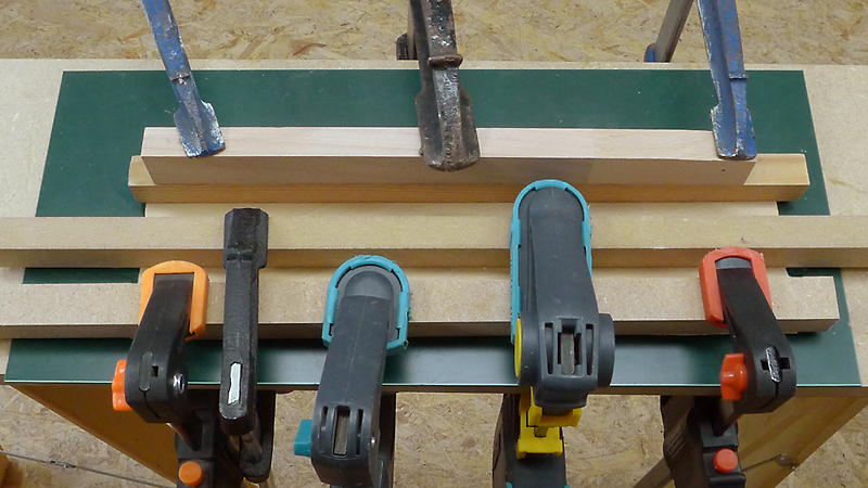

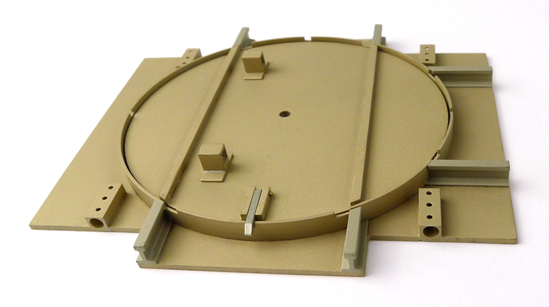

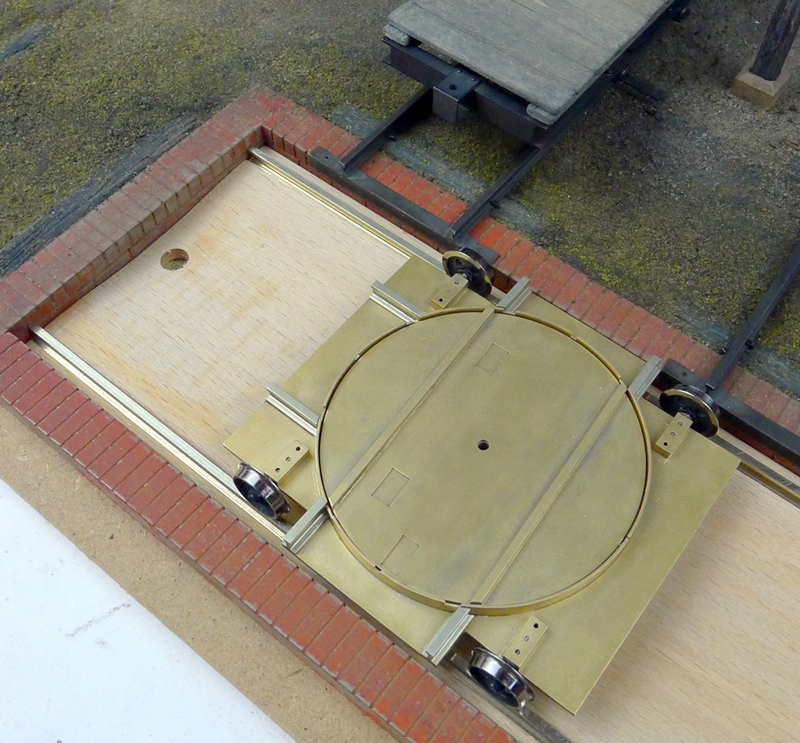

The little turntable got a bed today.
To do this, several layers of 1.0mm aircraft plywood were glued together so that a 2.0mm deepening was created in the central axis.
The water can then run off in the middle, should it rain. :)

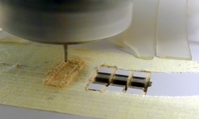

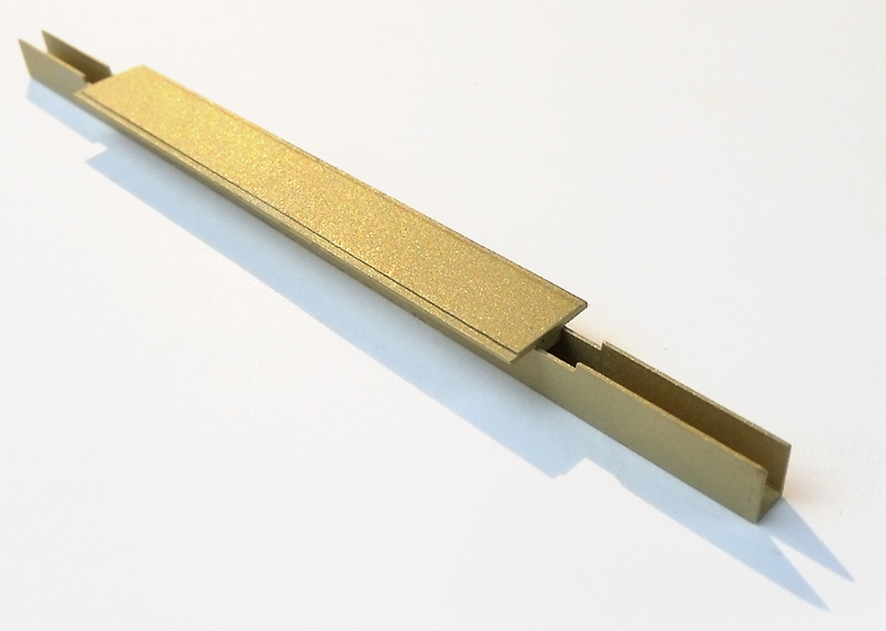

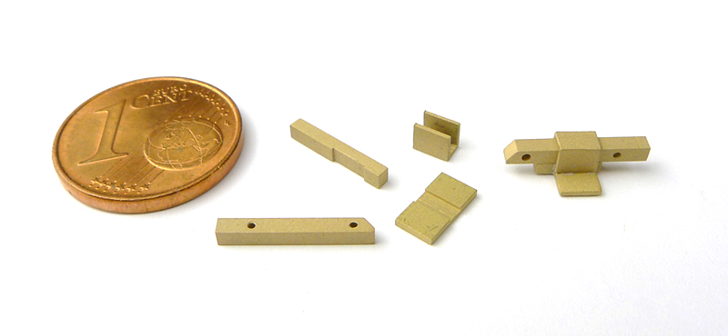

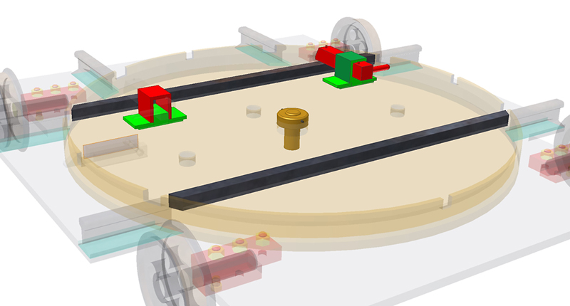

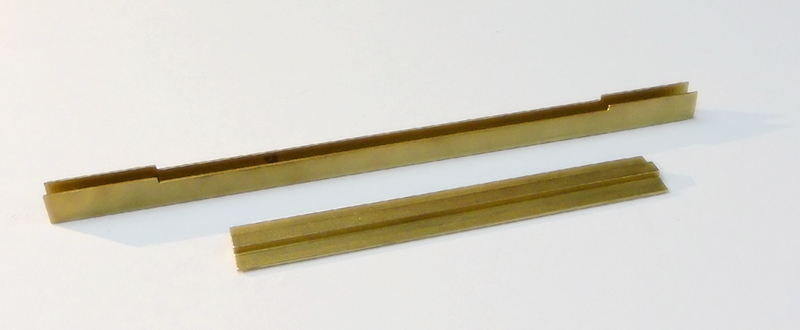

For the locking blocks the wheels on the turntable, I needed about 2.5 hours for drawing, creating the three milling files, milling out and soldering the individual parts.

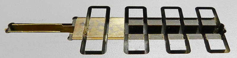

First a 2.7mm wide U-profile with a wall thickness of 0.34mm was milled from a 4.0mm brass plate. Thereby it received a 0.6mm recess for inserting the middle plate.
The 1.5mm thick insert plate received a lateral recess of 0.2mm on the back. On the top, 0.9mm was milled off on both sides.
Drehschiebebuehne_148 (fspg2)
Drehschiebebuehne_149 (fspg2)
Drehschiebebuehne_150 (fspg2)
Both parts were soldered together in a correspondingly milled groove, placed tightly in an HPL panel and glued with a crepe adhesive strip.
Drehschiebebuehne_151 (fspg2)

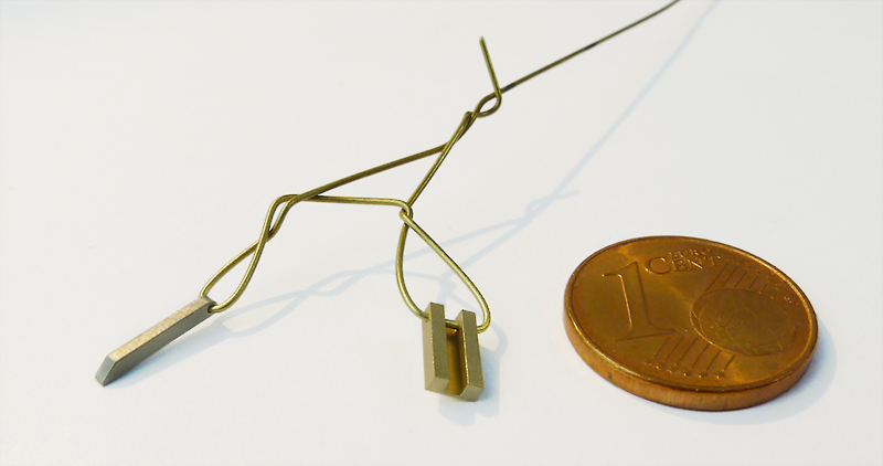

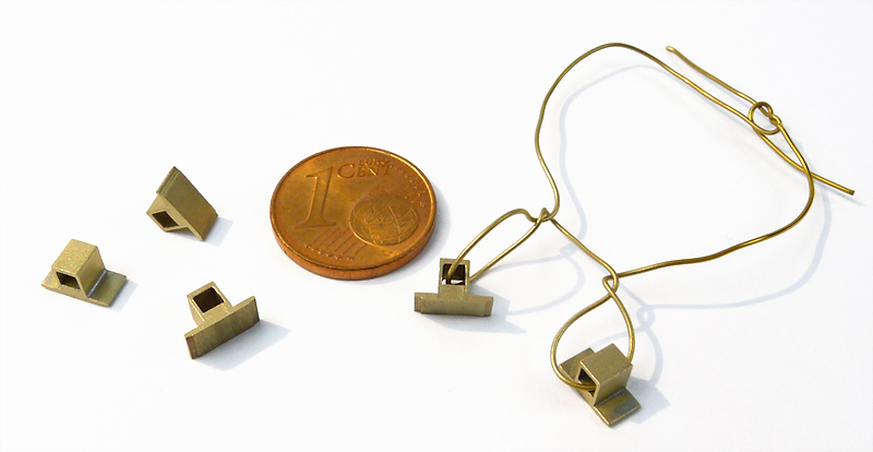

Those parts were strung on a thin wire and sandblasted.
Drehschiebebuehne_152 (fspg2)
Drehschiebebuehne_154 (fspg2)

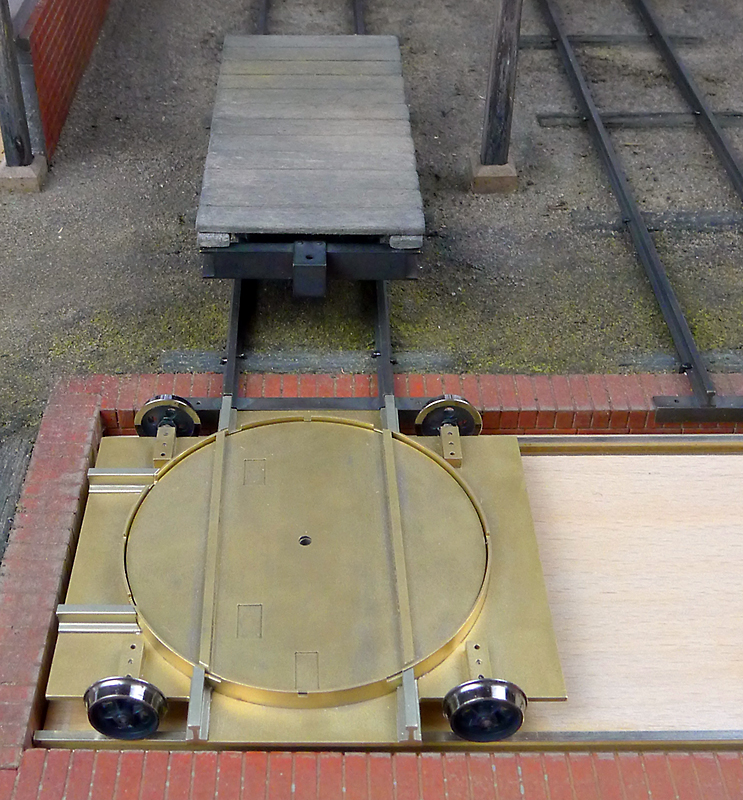

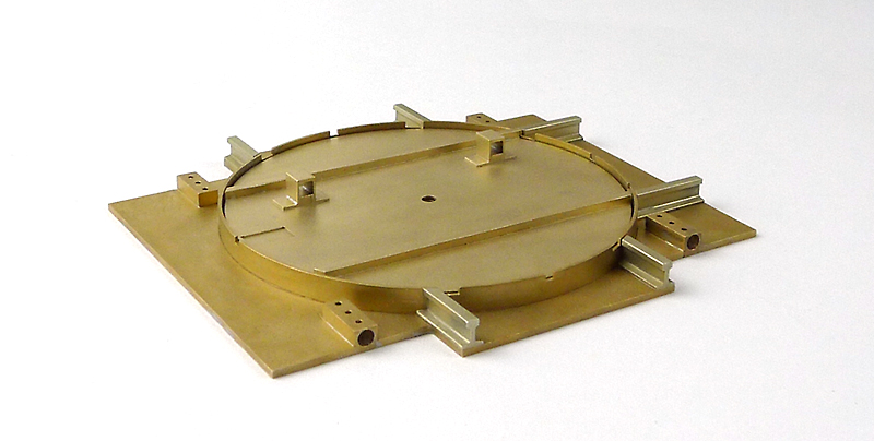

The turntable is slowly being equipped with the individual parts ...
Drehschiebebuehne_153 (fspg2)

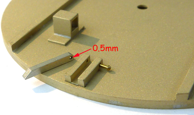

I sketched the drilling of the 0.5mm hole in the base body on February 12, 2021: click
After the hole was drilled, the protruding sides of the base plate were cut off on the sheet metal cutting machine and the sides smoothed on 400 grit sandpaper. After sandblasting it could be installed.
Drehschiebebuehne_155 (fspg2)
The rivet will be replaced by a hexagon screw.
Drehschiebebuehne_156 (fspg2)
Drehschiebebuehne_157 (fspg2)

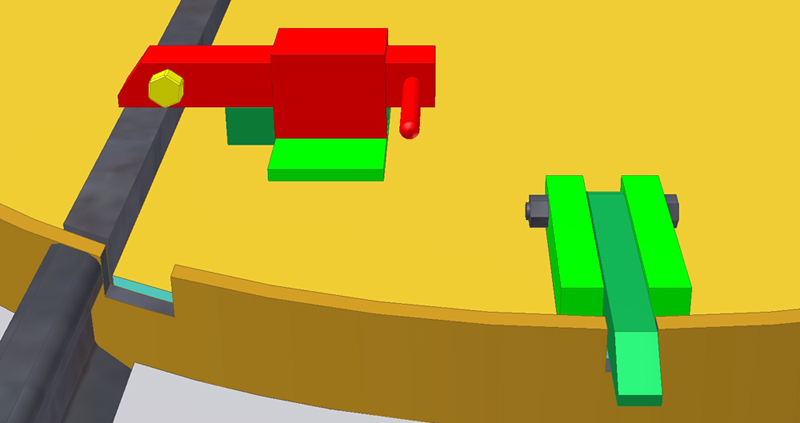

"You can see better with the second!" or if you look twice, you discover something that was overlooked the first time.

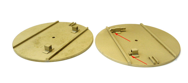

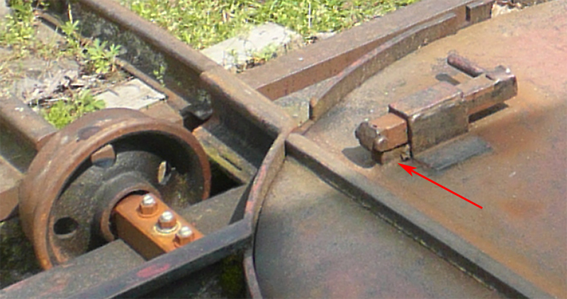

So when I compared it with a prototype photo, I suddenly saw that the two guides for locking the wheels on the model seemed a bit too bulky and a small part was missing (see red arrow).
Drehschiebebuehne_158 (fspg2)
Drehschiebebuehne_159 (fspg2)
Drehschiebebuehne_160 (fspg2)

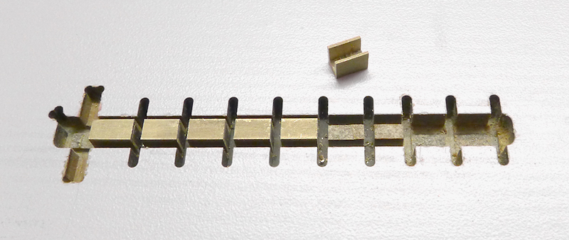

All parts were redrawn and milled - mostly a few more than needed ... sometimes something so small disappears.
Drehschiebebuehne_161 (fspg2)
All square edges are shortened at one end before the final assembly. There were two retaining bars there, because otherwise the small brass squares would have been damaged during milling.
Drehschiebebuehne_162 (fspg2)
For comparison: on the left the first guides (inside 2.0mm x 2.0mm) - on the right the new ones with an inside dimension of 1.5mm x 1.5mm.
