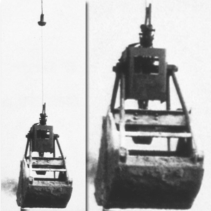

The old harbor crane had a double shell type grab, which was closed and lifted with one rope only.
Münzel-Kran_067 (fspg2)
On top there were two movable hooks.
The hooks grabbed over a "mushroom-formed" objekt. By pulling a second rope the gripper opened.
Münzel-Kran_068 (fspg2)
Unfortunately I cant see the exact mechanism at the pictures.
Maybe someone has even a photo or drawing of just such a hook on which I can still see a few more details.

I don't know if these are the same kind but I found some plans for clamshell buckets online...
http://constructionbucket.tpub.com/TM-5-3815-200-23P/TM-5-3815-200-23P0022.htm
http://constructionbucket.tpub.com/TM-5-3815-200-23P/TM-5-3815-200-23P0035.htm
You can also find a lot of photos and plans by searching "clamshell bucket" on Google Images. Here's one...
@Dave, Ray,
Thank you for your tips!
Looking for photos of my favorite model of clamshell buckets I got several emails from various people with useful notes, drawings and images.
Thanks to all of you!
Most of all I have enjoyed the help of two colleagues who had made their way to the Museum of Work in Hamburg/Germany and send some pictures of just such a gripper to me.
To recreate the look I put the photos to the background.
Münzel-Kran_076 (fspg2)
The 3-D drawing is the first step.  So I can build the gripper later in brass and nickel silver on a scale of 1:22.5.

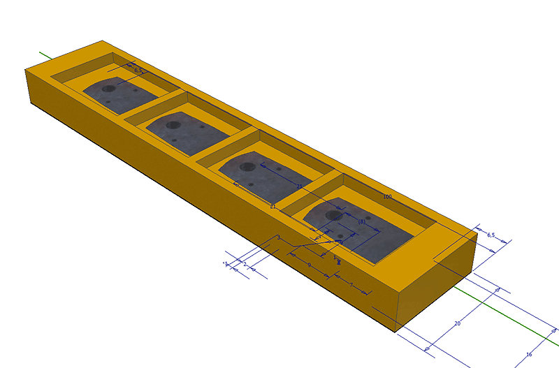

Meanwhile the 4 beam supports for the roof were milled in brass of a 20mm x 8mm profile.
Since the parts are 5.5 mm thick only I have provided the profile of the back with 2.5 mm deep pockets.
Münzel-Kran_074 (fspg2)
The center bars are for the fixed clamping during cutting the opposite side.
Münzel-Kran_073 (fspg2)
The centrally exciting vice helps for fixing the parts correctly.
Münzel-Kran_077 (fspg2)

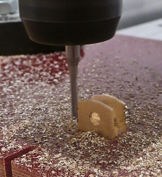

Then I milled a 9.0 mm deep pocket into a piece of hard paper.
Münzel-Kran_071 (fspg2)
The beam supports were placed in these pockets.
A 2.0 mm mill took off 0.5 mm material per each pass. In all 7,5mm he removed.
Münzel-Kran_070 (fspg2)

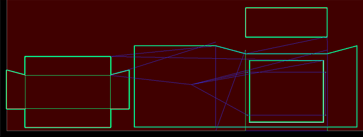

The two doors and window frames were milled from 0.5 mm brass MS58.
Münzel-Kran_079 (fspg2)
One frame shall soldered to the door. After painting a plexiglass disc will be inserted and glued with the second frame to the back of the door.
