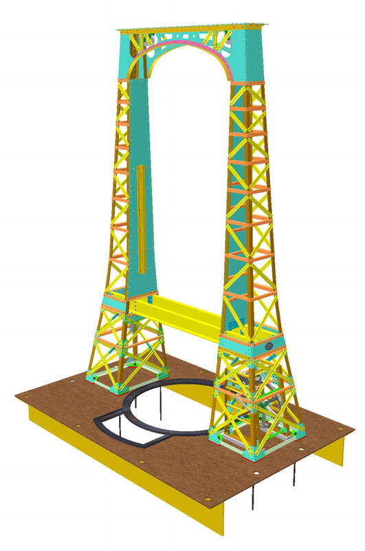

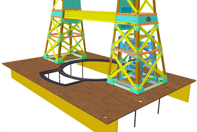

Because the control of my milling machine failed again, I drew a little further.
For the two lateral portal supports I want to mill out a common base plate soon in order to put the entire lifting mechanism on a secure footing.
Portal_Bodenplatte_01 (fspg2)
Portal_Bodenplatte_02 (fspg2)
Traeger_Montage_mit_Schacht_01 (fspg2)
Traeger_Montage_mit_Schacht_02 (fspg2)
