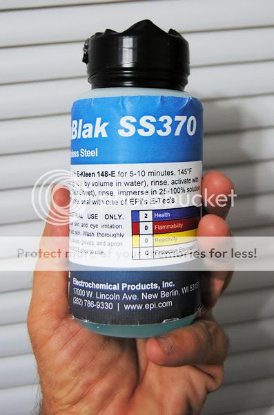

Free 250ml sample InstaBlak SS370
Started by eTraxx, April 27, 2011, 06:51:26 PM
This is a room temperature product to blacken stainless steel. Goto ..
https://ecommerce.epi.com/ProductDetails.asp?ProductCode=IB-SS3701
The drop down shows 1 gal for $133.70 .. click the drop down and select the 250ml sample.
Note under description: Receive a free 250 ml sample for the month of April! ..
that includes shipping .. IMO .. you can't beat free.
Good tip Ed... thanks. Ordered my sample this evening. Also, thanks for the intro to the supplier. I'm looking for some oxidizing chemicals for an upcoming bike project.
SandiaPaul
Thanks for posting this...but I looked and looked, where do you order the sample with free shipping? The drop down has 2 "samples" and both have $37.50 charge on it.
Thanks,
Right here ..

The 'sample' arrived while ago. Ordered on the 24th, shipped on the 25th and arrived today on the 29th. Sweet. Assuming I don't manage to spill it this 'sample' should last my lifetime ..
#7
I too am quite impressed with their service Ed. I ordered last night and received a shipping confirmation today along with the MSDS data sheets on the product.
I have a feeling they are trying for market share. Notice that I keep seeing their ads all over the place on the net.

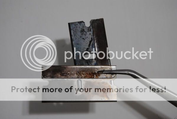

Did a quick attempt to see if it worked on other then stainless. Yeah, it works.  I just did a quick dip. The top razor blade was wiped off with a kitchen cleaner .. the bottom dipped in acetone. Note that the instructions have you first clean the stainless with their proprietary cleaner and then a dip in a 50% solution of muriatic acid so my attempts at 'cleaning' were half-a$$ at best

Works great on music wire and brass too!
The following took a dip in the solution for 20 seconds each.
.046" music wire & .125" sq. brass
I did nothing to either piece, took them from the metal bin and stuck 'em in.
