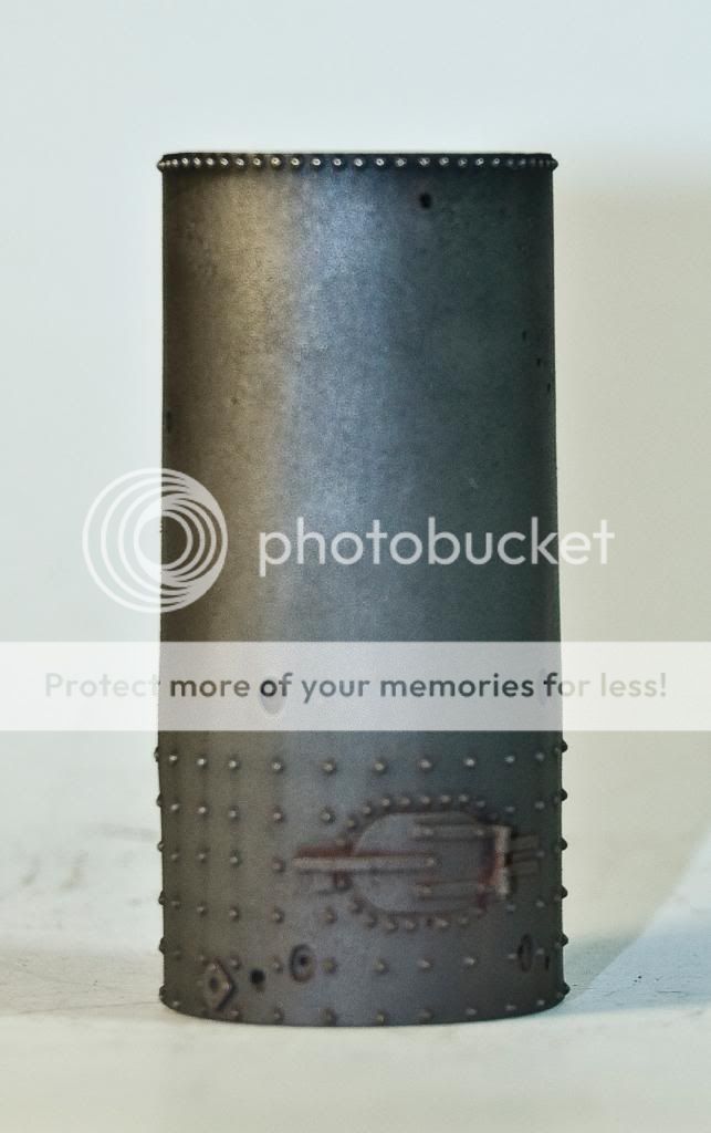

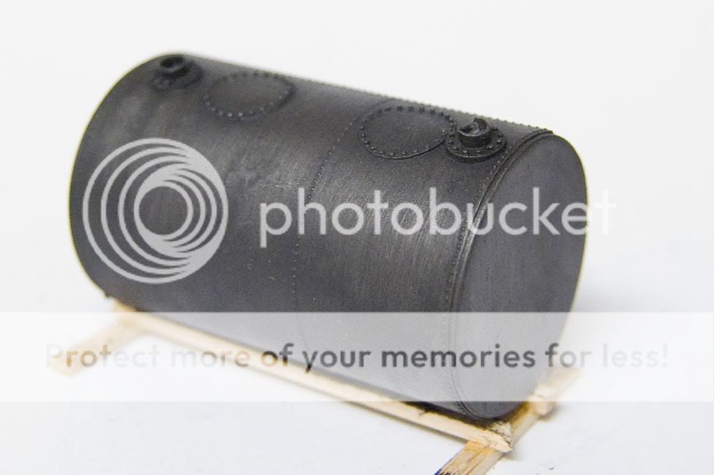

I have been working on a ¼" scale Willamette loader engine. The kit is a C.H.B. DE-1000. From what I have been told by Brett at Sierra West this was one of the last projects Charlie Brommer worked on. Brett also told me only about 100 kits were ever produced. I also have the oil tank/burner option. Only about 40 of these were known to exist. That said I am very honored to have one of these kits. This particular kit has a sorted history and has made it's way back and forth across the country, I'm glad I finally got it!
I wanted to depict a machine in the beginning of it's life, not run down and ready to explode. I used a new technique (for me) to color the castings. The kit is entirely metal so I first blasted it with baking soda. After cleaning I gave all the parts a dunk in blacken it. After the blacken it had dried I painted on Windsor & Newton lamp black artist oil. After about 10 minutes I used a stencil brush to "burnish" and/or wipe away any excess paint. I like the effect it gives.
I have lots to do (these are early on in the construction) and some surprises along the way also.
I hope you enjoy.
More soon.

I am not sure I understand what you are trying to do with the finish. I understand that you want this to be a newer in use machine, but I don't get the metal look....If I recall correctly, I am pretty sure, Willamete painted all their donkeys....but I can check the catalog.
If you are going to keep the metal look, the boiler looks better than the water/oil tank...on that the sanding or wirebrush marks are really distracting and strange looking.

I agree the lines/streaks are very distracting, but, this was early on in the build.
Multiple layers are/will be applied. The lines are actually brush strokes in the oil from the stencil brush.
After a few more layers it is gone.
As far as "paint"  I am unsure. Trying to look at B&W images to discern color is very hard.
I am trying to achieve what I think the paint would look like from the heat of 3 years on a boiler.
Looking at the reference images I am trying to match the "sheen" I see.
Also wouldn't a well loved new machine have been wiped with oil to keep it pretty?
I appreciate any additional info.

Looks good.  I'm sure as you weather it slightly the lines will start to blend in.
Marty,
All the photos (not catalog images, as these were often retouched or shot with the equipment in a "photo grey" paint finish) of the new donkeys show them being painted in black, or black and some color (since you reference "In search of Steam Donkeys". there are numerous images in there that clearly show the paintd finish).
I couldn't find a paint spec/finish note in the Clyde or Willamette catalog, however...and this goes directly to your point of "newer but used equipment", in the Washington Iron Works Catalog (another large mfr of logging equipment) it states under the section titled "A Few Suggestions For The Care And Maintenance Of Logging Engines [donkeys] And Boilers" ...."When laid up for the season, engine and boiler should be toroughly cleaned, greased, painted, and housed, and the stack covered to keep water off tubes and the boiler head."  Likely what you are seeing as "sheen" in the images of units in the woods, is either still from the original paint luster, or from being wiped down with oily rags...or just a lighting result....but almost most definitely not silver metal, as this would oxidize very quickly.
