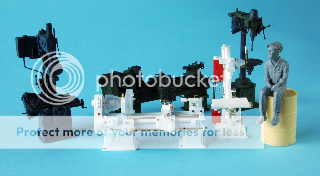

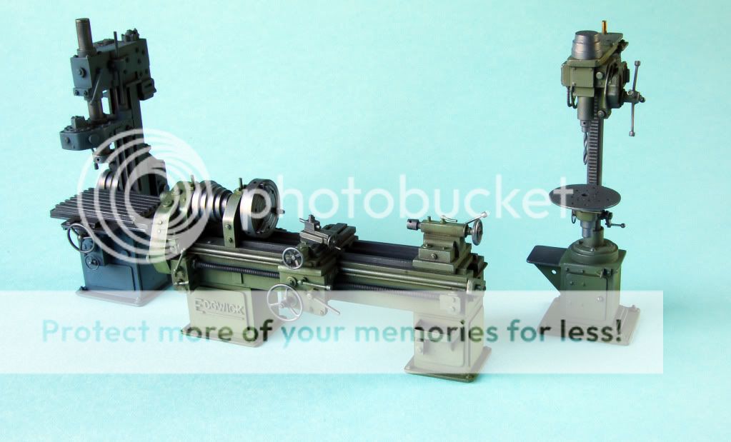

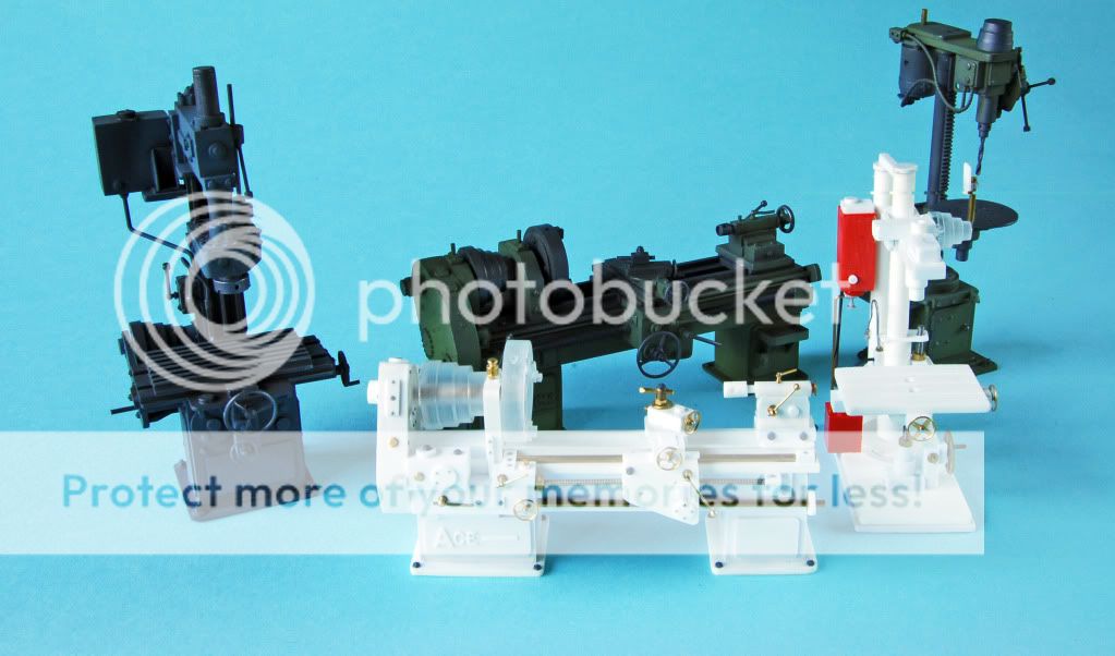

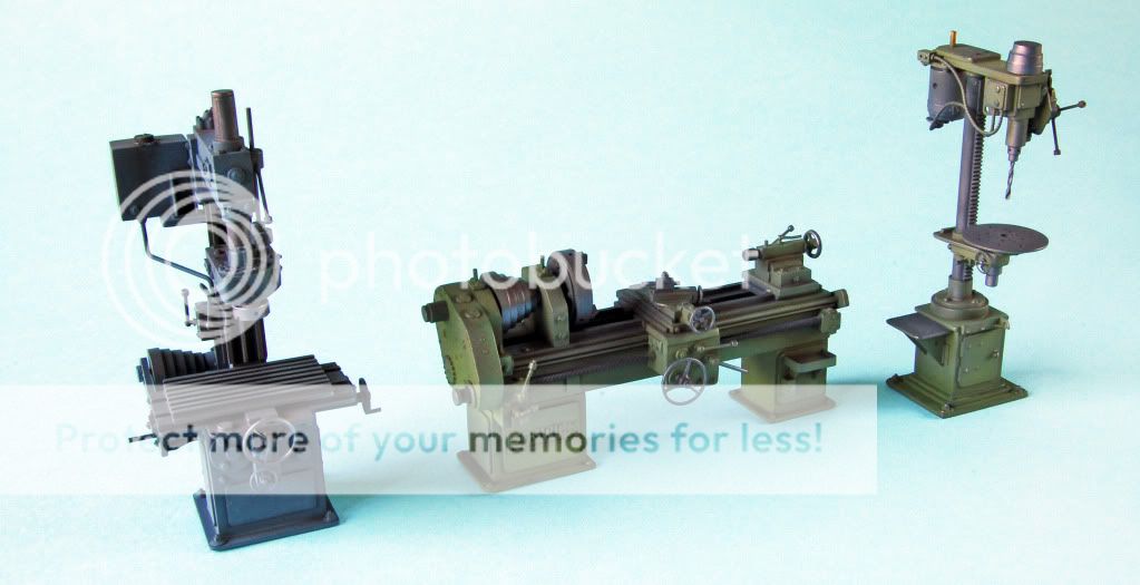

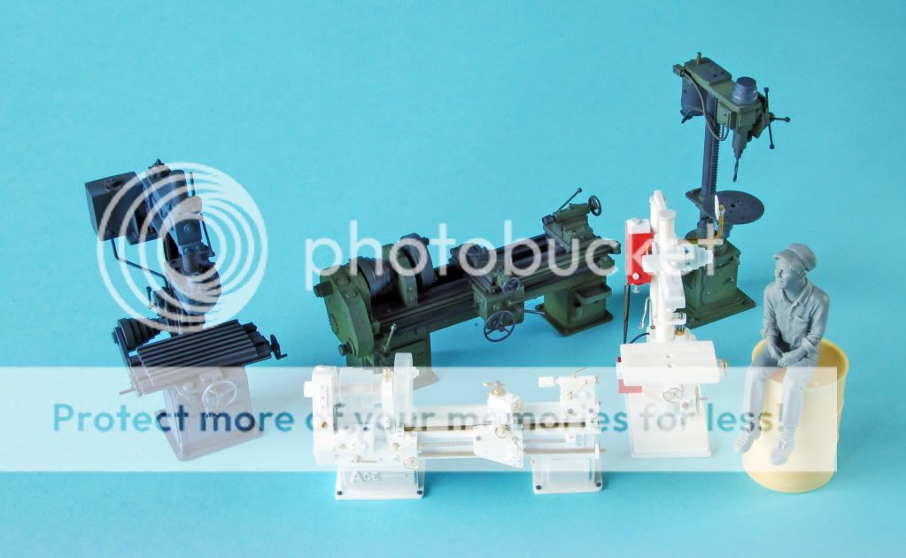

After a break from the workshop to finish other projects off Odd bods and all that stuff for the Euro show - now back at it . Some of the machines painted but still a bit of work to do belts and pulleys and those brass oiler things plus still building more machines -has anybody any thoughts on what to use for the flat belts -paint used was Humbrol enamel -metal finished by dry brushing Humbrol Metal Coat polished steel over tank grey undercoat but I think I might try the AK metal colour on the next lot of machines enclosed photos of some of the machines.
Barney.
Smaller Lathe and grinder under constuction -both based on LEGO blocks
Amazing what you can build from a box of Lego these days ;D
Neat work as usual Barney ....................
"Belts" I have used masking tape cut to relevant width , with the gum taken off with nail polish remover (don't ask) the texture of the tape takes paint and dry brushing  ................. or have also tried the ribbon you can get for Xmas parcels it splits down into any width but its not so flexible as masking tape
Those are incredible! One would never have guessed they started out as Legos. They look better than many commercial castings.

Legos.  Fliippin' Legos... whodda thunk it.  I am so pillaging somebody's toy bin fro my next project.
I love these... and am both jealous and inspired... these came out aces, and you've done them up beautifully in the paint booth as well.

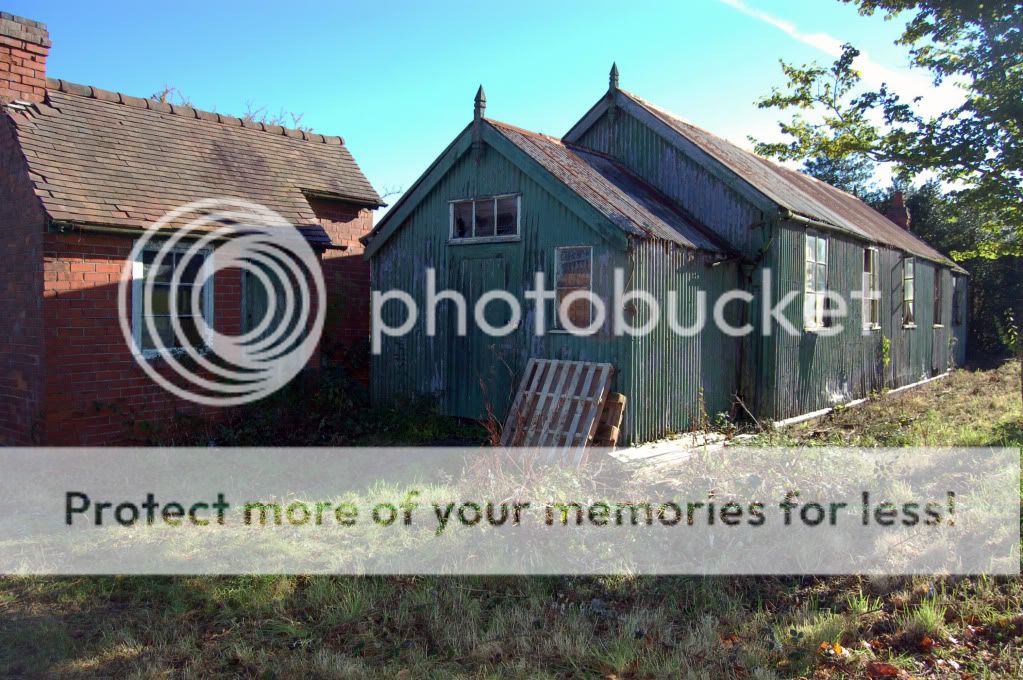

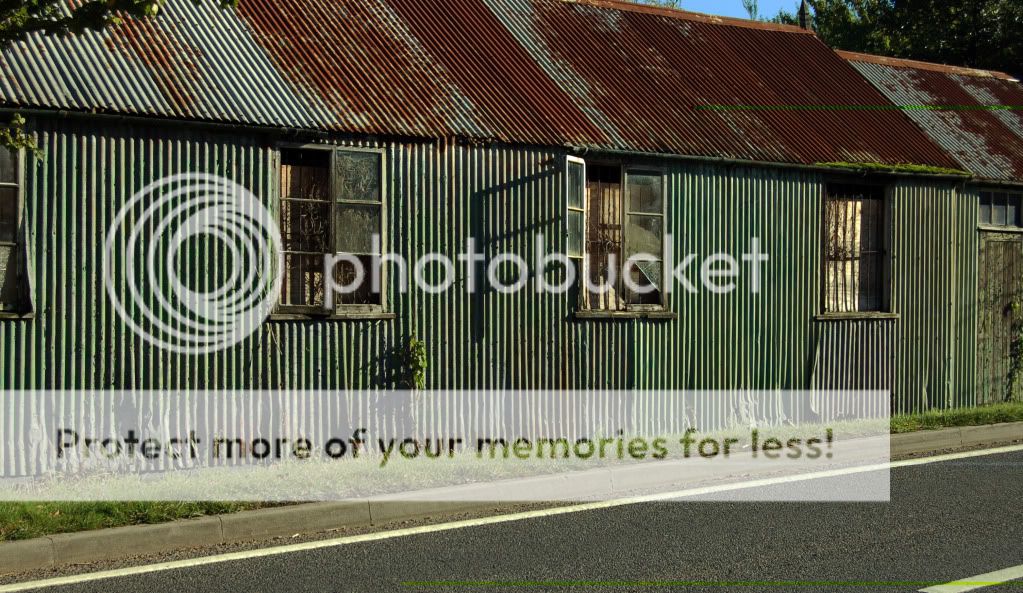

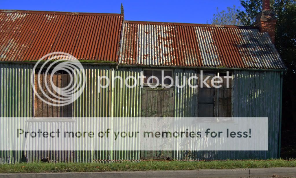

Originally I was going to have a narrow gauge track running through the workshop but as you do a change of plan was put into action - by putting the track on the side of the workshop it gave me a bit more room for the machines and also gave me the opportunity to make the building a bit smaller if you get the meaning of making it bigger but smaller !!! - I think in the larger scales especially with buildings care should be taken not to go down the "Dolls House" road - so I intend to keep the buildings to lean-to type shacks and garage size type of thing and take a page or two from the Mr Ackles book of excellent buildings which also have "an atmosphere" about them - enclosed some photos of some of my thoughts so far -I think the footprint of the workshop will be about 10 inch x 6 inch. (can not understand all this mm stuff)
Barney.
I like that rusty green, corrugated building! Definitely an interesting prototype.
