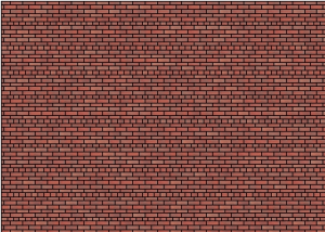

I found this site and link on another model site.. interesting concept.. The brick patterns are produced by an algorithm written by a programmer, who based on his testimony is not an experienced model builder.
http://paperbrick.co.uk/
I have attached a small screen shot of the pdf output in S scale.
My print was a bit glossy, but there may be ways to overcome that based on the paper being used.  I used whatever paper was in the office printer.
So far the downloads are free.

I have done endless experiments with printed brick, and I can only speak about my experiences in 1:87. I have tried all sort of printed brick patterns, (scalescenes, clever models and numerous photoshop experiments). Printing on different papers with inkjet and laser printers. Even carving mortar lines. Nothing with satisfying results!
However, I have to say, that printed paper brick does work excellent when viewed in a photography. In that case it is far superior than any 3D brick, because the missing depth is not visible in a photo. As soon as you look at a paper model in reality the missing texture becomes apparent.
There is no easy solution. At least not for 1:87. Larger scales are different, as many of the members here have proven.

I gave it a try at 1:32 scale, using the Antique Multi brick set and a header bond.  Printed the resulting file on Epson Premium Luster photo paper.   Of course that paper is too shiny, but the perceived texture, coloring, and randomness of the burnt bricks is outstanding.  But I did observe some artifacts of the software repeating a pattern.  Approximately every 3-1/2 inches (measured horizontally) a run of vertical mortar lines is very slightly wider.  It's a minor difference, just enough to be apparent.  And there's a similar repeating wider horizontal mortar line approximately every 1-1/4 inches.
Curious, I tried another brick set, Wessex Mixture, and stretcher bond.  This combination yielded mortar lines of consistent width.
Now for the real test - another printing of the Wessex Mixture patter, this time on Epson Cold Press Natural paper (100% cotton base textured heavy paper with natural whites, as opposed to bleached.)  WOW!!!  Looks very good.  Ready to cut out and glue to a plywood wall.

I guess I'm missing the point here. I visited the site and looked at the artwork. The creator generously offers it for free and, yes it is scalable. So what? It is crude.
To be more specific, it's cartoonish and seems inappropriate for the kind of modeling we strive for. Yet some of us seem enthusiastically to embrace it. Why?
I'll happily rescind my comment if one of you shows us a highly realistic model using those printed digital bricks. But I'll cackle and gleefully say "I told you so" if you don't. I doubt anyone using that primitive computerized pattern of rectangles will be able to raise it to a realistic enough level.
You guys know I embrace technology and any kind of innovation, especially a shortcut that yields superior results. But I suspect the bricks in question will be a dead end for us and I find it baffling that they show up on this forum.

I believe the fellow's effort is honorable and commendable. However, even though he is using actual photographs of individual bricks to generate the random pattern, the same individual bricks in his library are repeated throughout the pattern and that is why some of the believability is lost. Also, the mortar is just a straight line and has no texture.
Here is an example and close-up of a pattern generated in HO scale when I chose random settings. I am not a brick expert (courses, etc.) so any of the choices seemed just as good as the next to me.
Parameters:
Actual size of sample:
Close-up of sample:
Note in the close-up the brick on the top left corner is the same one as in the bottom right corner. Also, there are three of the same brick in the bottom course and the brick on the left of the bottom right corner is repeated twice in the bottom course and found again in the top course.
It does appear to me in the close up that these are actual images of a single brick. As I've stated above perhaps the pattern is not random enough or the mortar takes away from the illusion.
I wonder if the fellow added mirror images of each brick as well as upside-down images would that help?
Jaime
For one thing the lines are too dark...at most he should use a med grey...or a "shaded"/gradated line that is darker at the top half than at the bottom (to imitate the sun/light shadow in the recessed mortar joint)
To get an older looking wall it might also help if the line had a very slight bit of a ragged or deckled edge; to hint at, or give the impression of, worn or slightly chipped edges of the brick.

I agree the grout should be a lighter Gray color.
I think the printed brick would work well in interiors of buildings, esp in the smaller scales.
There are posibilities.
This focus on color and photo renderings of individual bricks is misdirected.  It should be focused on ways to achieve the 3rd dimension.  Because you can make the bricks photo perfect, but paper brick is not going to be right until it has the 3-dimensionality of bricks and mortar.    That is the bottom line.
