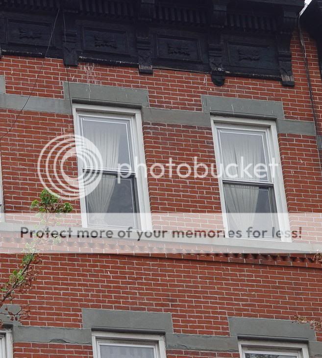

Russ's focus on coarse brick I think is correct because, although its a bit of a cliche, it is indeed common in the 1/1 world and, in my experience, the hardest to realistically reproduce in miniature.   Its basically the gold standard for brick.   If this can be done, then any other type can be done.   Personally I've set my expectations a lot lower for what can be done with printed paper.
Here is an example of the above-referenced front facade brick, very common around here.   It is very regular with high contrast between the brick and mortar, but without a lot of depth between them.  It is completely matte.  On this particular wall on Smith Street in Brooklyn, the mortar has been brought right up to the brick surface.   In 1/1 scale, viewed from across the street, depth is almost imperceptible.  Without the sun at a steep angle casting shadows,  it looks like a perfectly flat wall.    So in 1/87 or smaller, its a possible application for printed paper, which is high contrast, zero depth.
Which leads me to wonder how much depth needs to be added to 1/87 paper brick for it to stop looking like a slipshod phony veneer and start looking like a wall composed of individual units.  Maybe in applications like this, not every mortar line needs to be indented, maybe just some random embossed bricks, or mortar lines, is enough to break up the surface.    Or maybe it only needs to be completely matte without a hint of sheen.  Maybe some texture can be added by pressing the paper with sandpaper, maybe before printing, so it doesn't chip the ink.  I don't know, I'd need to test it.
