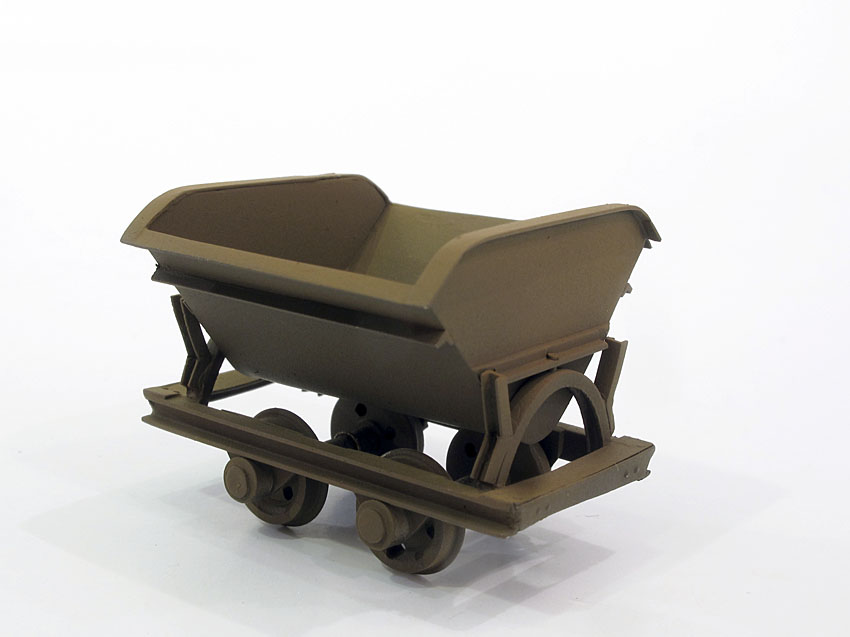

The little Fowler quadruped that was pictured at the end of the inspection car is now underway.
I have begun work on the wheels doing it the hard way by assembling various bits of brass.
I stuck some printed information to the brass discs so that I could fret out the spokes with a jewelers saw.
After fretting them all out I have now started on the ribs and hubs.
I devised a crude way to get the angle of the ribs these are also being cut out with a jewelers saw.
only 3 more sets to go.
regards Michael

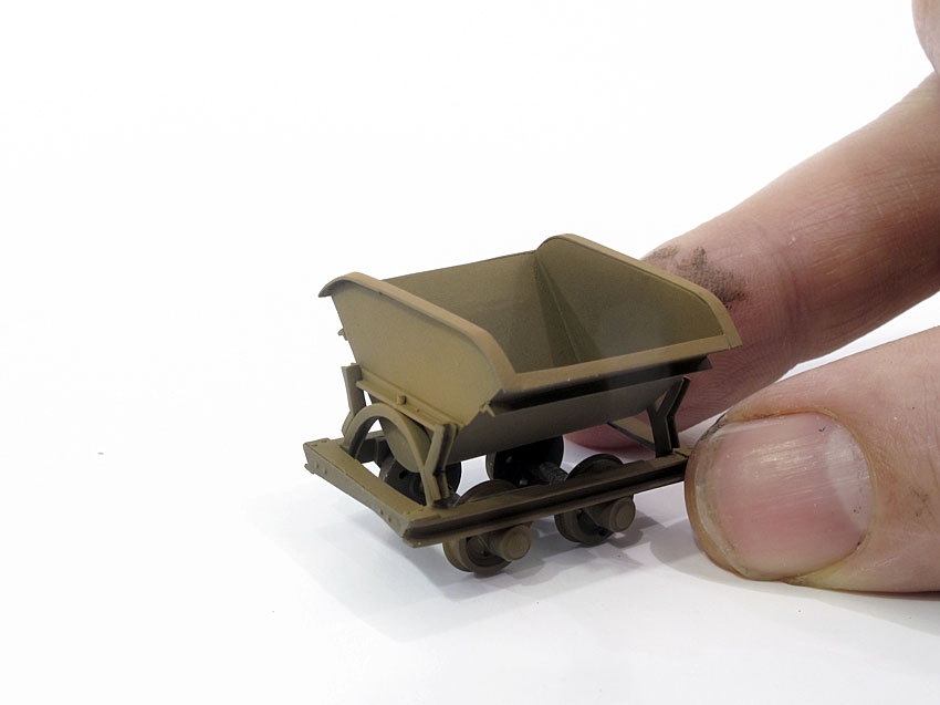

Thanks all for your kind words, yes I would suspect that the originals were cast in sand.
the overall diameter is 1.6" amd the tread is 1.5.
here is the latest picture of the first wheel soldered up
