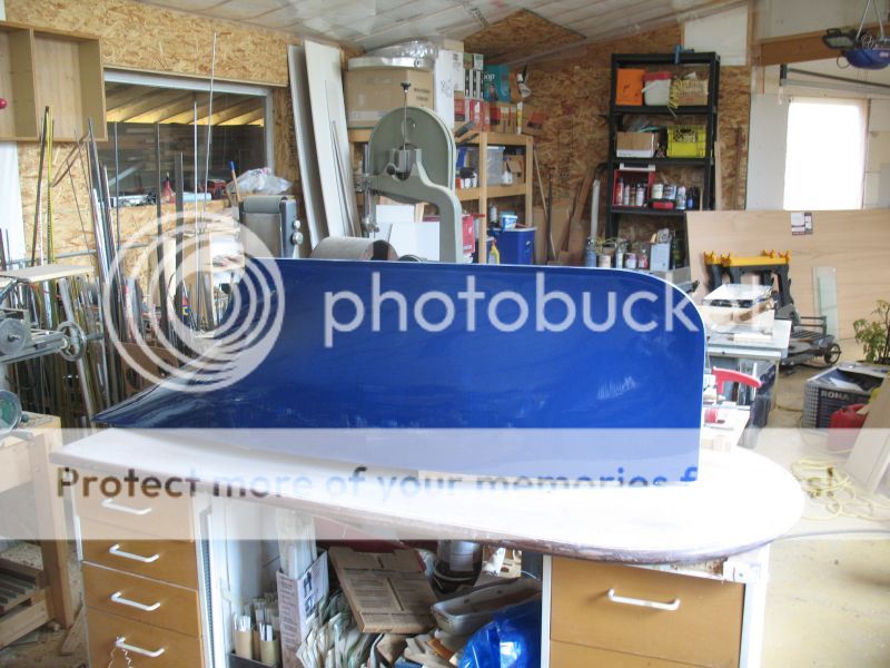

Thank you all for your very kind words, I am not doing any fine stuff at the moment but sanding and painting with the paintbrush is working for me, and as you say Paul it is getting me some shop time, after the surgery I will not be able to do anything in the shop but gaze for a couple of months, So I am trying to make "A Little hay While the Sun Shines" although it felt a bit winterish here today.

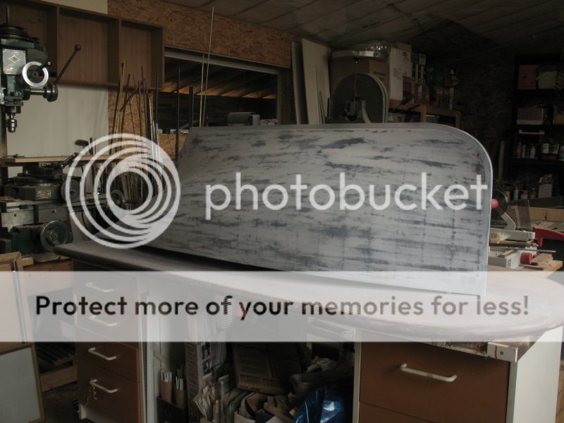

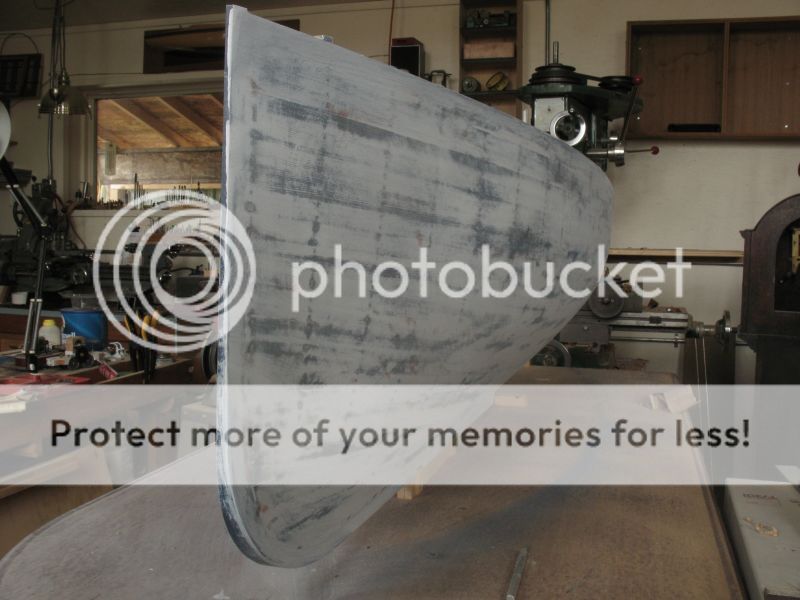

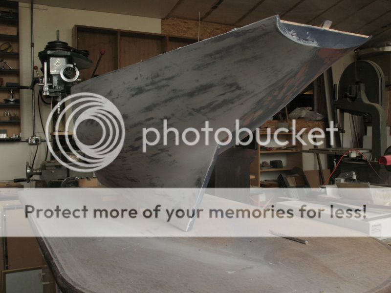

Anyway I was able to do the gross work of "Wax on Wax off" this afternoon on the port side.

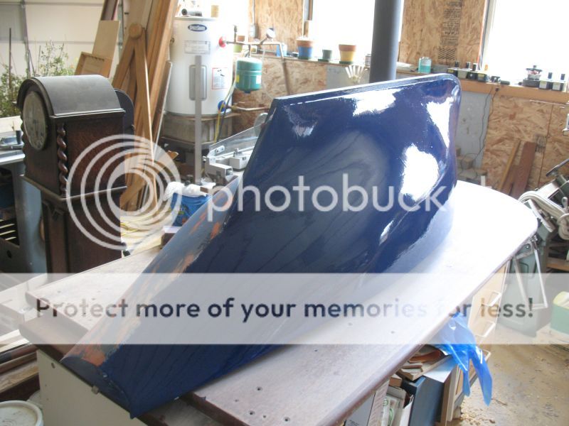

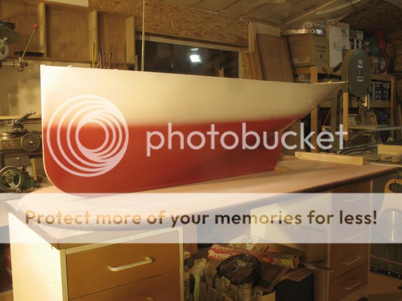

Then after the sanding of the white layer on the port side I applied the blue again this time changing the direction of the brush stroke to up and down.
So tomorrow I will sand and give the starboard side the white coat while the port side hardens up
Well now that it is all smooth and perfect!

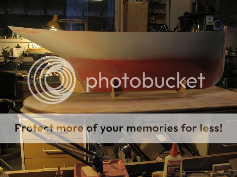

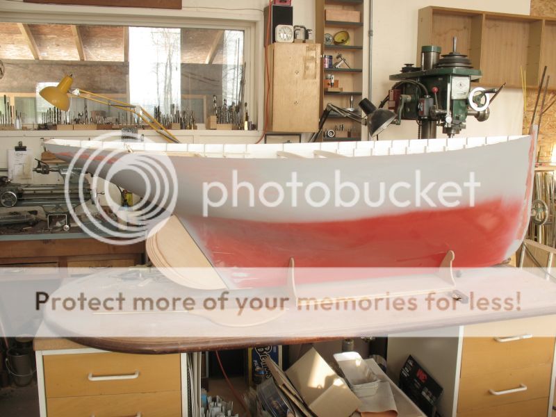

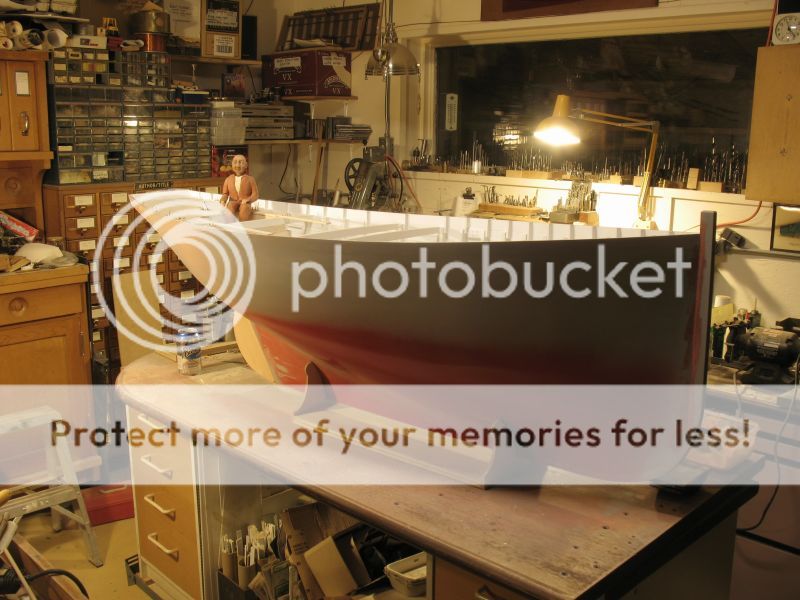

Marty it will be a while before it is under sail, however I have been working on it a little bit and the number of coats of paint both inside and out have been too numerous to count.
be that as it may I have been working on the the hull and the rudder on and off over the last month. The surgery was postponed for one month, so the big cut happens on the 15th of November.

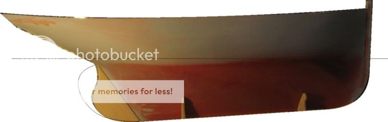

I have been told that the rudder will be too small.
So I am looking into changinging it to be better for the model.

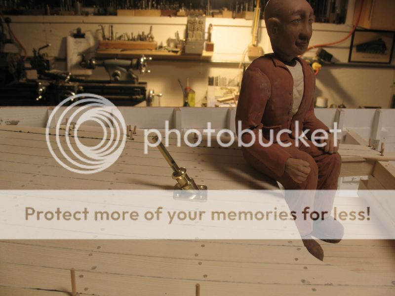

Arnold is checking out the fit of the cockpit.
Finally the rudder fitting for the deck. the deck is white pine half lapped and glued with black carpenters glue.

The rudder looks awfully small though.
Andy, thanks for the kind words, the woodwork on the deck and mast and spars will all be varnished with brass brightwork.
Marty yes the rudder is too small and will be replace with another one this shape.
I was counseled by some RC boat modellers about the size and shape. Just one more learning curve.

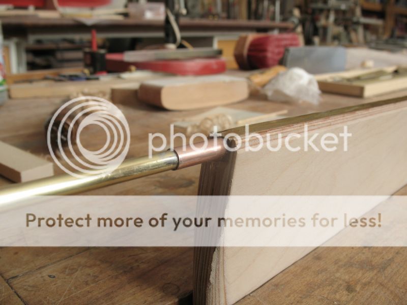

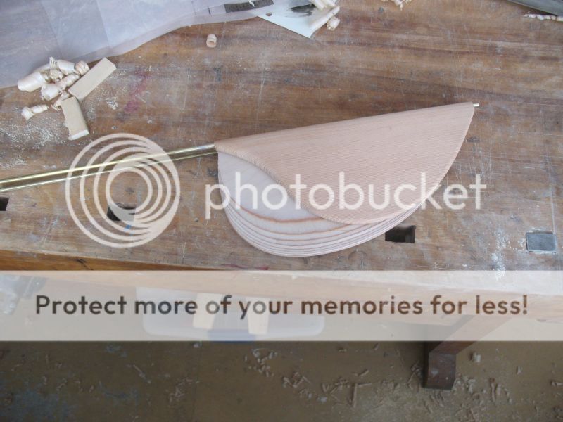

I made the new rudder today from a laminate of two sheets of 1/4 inch x 12 ply aircraft plywood so 24 ply overall I glued them with epoxy.
made a new shaft from some 1/4 inch square and some 3/16 round and epoxied it into the slot at the leading edge.
overall shot
Continues to be beautiful work Michael. The new rudder looks much better. I also like the look of the staggered treenails on the decking. She's going to be a real beauty when ready to launch.
