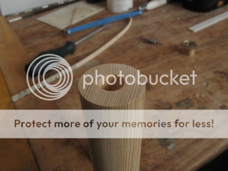

Switching gears today, I have been working on a roller reefing boom, the first boom was made from fir but I changed my mind and made a new one from some clear spruce that I had kicking around. I also decided to make the boom with roller reefing.
This is what I am after

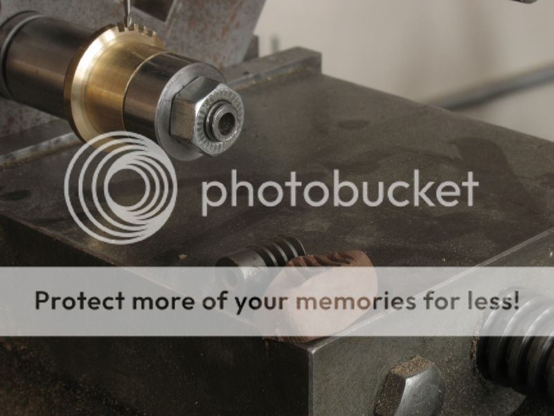

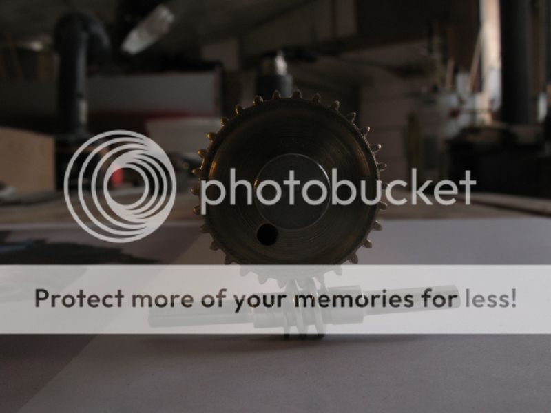

I had a small worm that was the right size diametrically, a bit too long but that was an easy fix. I had no gears that were close so opted to make one
I had an old 30 tooth clock gear in the spares box so I used it as a template on my small gear cutting mandrel.
in order to get the angle of the cut across the face I squashed the worm into some clay that was lined up square with the vice and mandrel. Then rotated the table to line up the fore and aft cutting across the gear face.

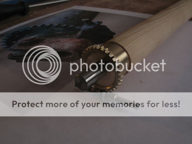

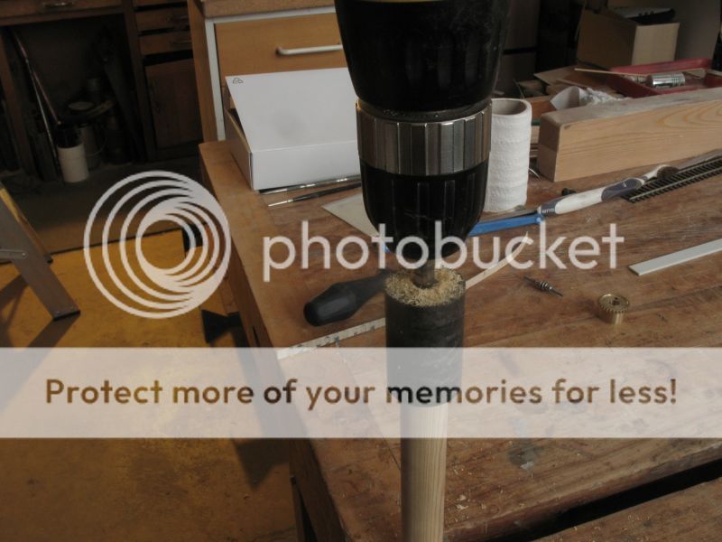

The next task was to bore the hole in the end of the boom, I was not able to do this on the mill drill so I turned up a sleeve that fit over the end of the boom out of a scrap or plastic bearing material. to act as a guide for the hand drill.
this worked very well.
A bit of work reshaping the worm and softening the edges of the gear they mesh well enough that that it will work.

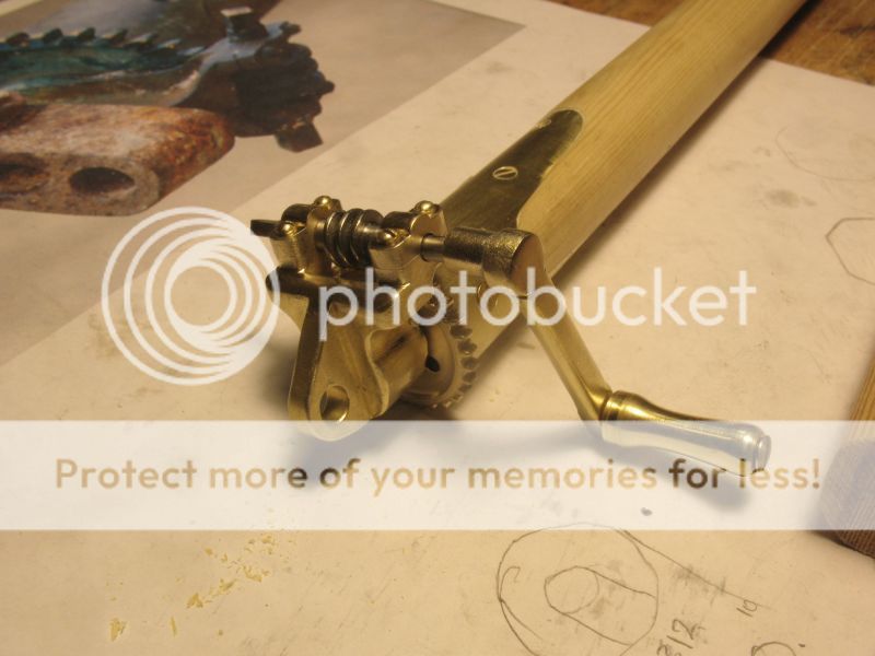

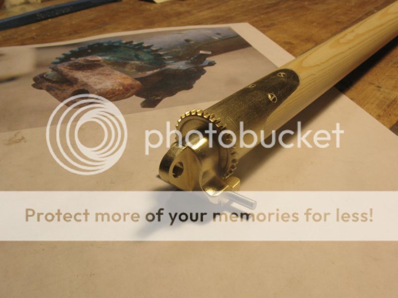

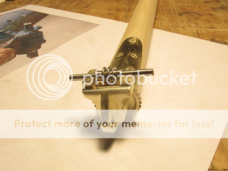

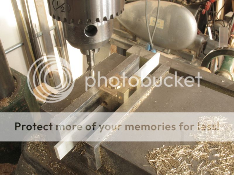

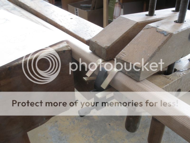

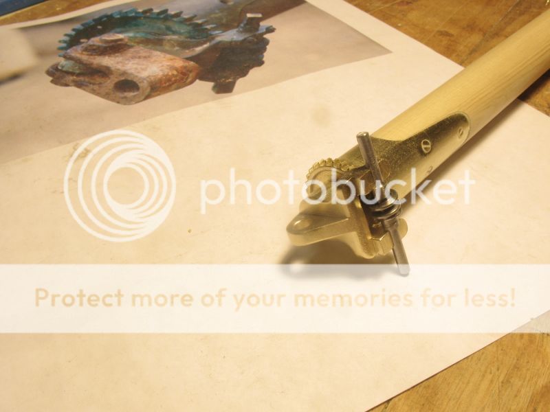

Today I did a bit of milling and a fair bit of filing and fiddling. I worked on the frame section started out with a cube of 1 inch brass.
The tube that fitted to the boom was a brass 3/4 pipe nipple that I bored out to a 1/16th wall thickness then milled a slot and then filed it to shape, it was really hard getting it to seat properly onto the boom. My carving was pretty ugly under the brass. my hats off to all you figurehead carvers out there.

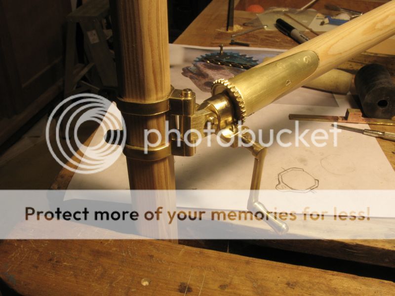

Tomorrow I will make the keepers for the worm. I will use some 0x80 machine screws to bolt them into place, and file a square onto the shaft, for the handle.
Just a bit more fiddling about with the boom and goose neck.
I am pleased with the way it is turning out.
Marvelous! You could actually go sailing with that!
Just fiddling he says... !!!   Michael, that looks fabulous, it really does look the part [is that a pun]?
You seem to be taking this build to a serious level - are you intending it to be a "working" sail boat?? - you know, as in Radio Control or something?
