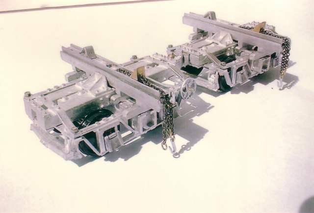

How about the disconnects? These are both available in 3' and 30".
I haven't seen these in real live but the pictures look promissing ...
  Marc988,
  I have 5 sets of BM disconnects. 2 sets assembled but not painted yet. Very nice, coupler hight pocket is for 0n3. For 0n30 the coupler can be fixed underneath the pocket.
When the donkeys are done, I'll start, beside landscaping etc, on rolling stock.

FWIW I have three sets of the ones pictured and they are crap.
They look nice but will not work for On30 and one who wishes to operate a layout.
Besides they are a bitch to assemble.
  Marty ,
  yes  I agree, not the easiest to built.
  KW offers several types wooden disconnects, one expensive in wood and a cheaper one in white metal. Are they usefull ?
  I had an idea about the white metal ones, use them as base/weight and cover them with wood to represent a type as built by Marty.
After I got the "other" kits and gave up I built my own.
They have a rooster and run fine in a string of three; empty (or full).
Unc, published an article on them, and I think I may have the instructions.......

If you or anyone really needs info on Marty's disconnects, I could try to dig up the lo-res PDF and e-mail it. Please note, I will do that only for someone who absolutely NEEDS the article and will actually build models (as opposed to intending to build them).
Marty, should that happen, it would help me if I knew when I published the article. I can't remember! (Either because of Alzheimer's or having been in business too long ....)
   Russ,
QuoteIf you or anyone really needs info on Marty's disconnects, I could try to dig up the lo-res PDF and e-mail it.
  yes please,
#626
Info & pictures are on it's way.

Jacq, do you still need the PDFs or did Marty send everything? -- Russ
  Russ,
  I received an exploded view with material sizes and 2 photo's.  Enough info to enable building a number of sets.
  Thanks for all the efforts
