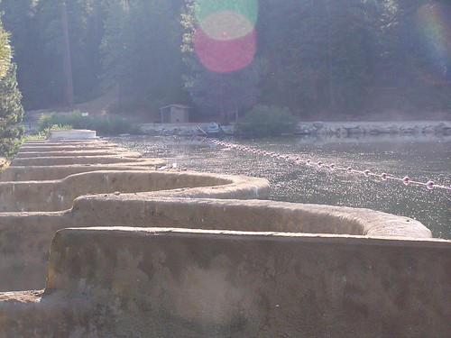

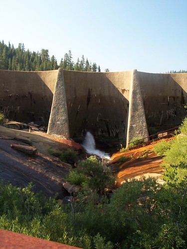

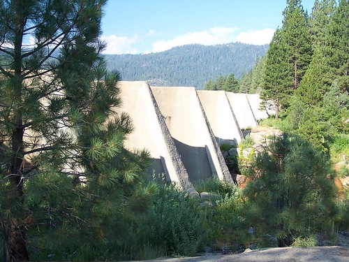

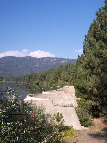

I am sure you probably have already found these of the Huma Lake dam:
Some of these came from a set of FLICKR images re Hume Lake
http://www.flickr.com/photos/eddingrid/1563902830/

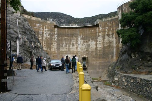

FWIW, here are some photos of the local dam (Devil's Gate Dam) here in Pasadena.
This is the dam from the inside:

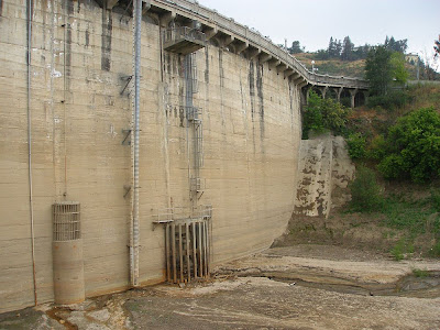

This is the downstream side (btw...note the forest fires in the background):

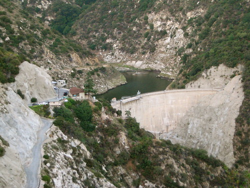

This is the Sierra Madre dam (next town over from Pasadena):
This is the Santa Anita dam (also in next town over)
MR
Good photos Marc. It is easy to see the warm tones in the concrete evident in all the photos. The last photo is very typical of much of the landscape. Judging by the green foliage and water level, it would appear to be a late spring or early summer shot. As Marc says Jacq, during the summer much of what is green in that shot will be muted green at the most, if not yellow and brown.
I was up in the foothills yesterday and though we've had a fair amount of moisture (fog mostly), the ground cover is still dusty and muted. We have a fair bit of sage and manzanita in ground cover here abouts and the green is never more than muted. The evergreens are green of course, but still retain a dusty feel, rather like the trees in the fifth photo below.
Dust is prevalent. By the late fall, prior to any rain, it coats everything, even the leaves on trees and shrubbery. It takes several rains to wash it off, but it returns very quickly at the end of the rainy season, usually March or early April. It's impossible to keep a clean car here... ;)
