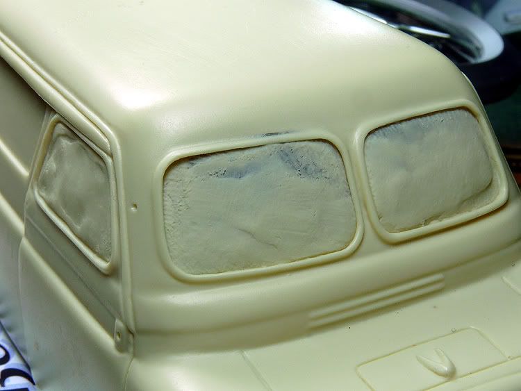

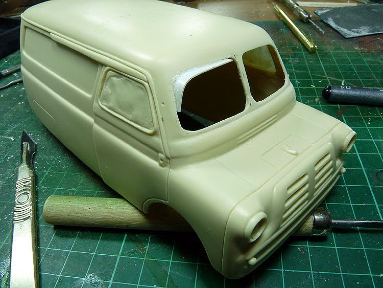

To my mind the first glaring anomaly in this body shell is the front screens. They're just so terribly wrong, now I'd decided not to do a Factory stock build but rather what's known as Rep' stock [Replica]. This gives one the latitude of being able to stray or deviate from the Factory spec's and produce a rendition that copies a "living" example. Actually it's a bit of a get-out clause to stop the nasal rivet counters giving you a hard time!!

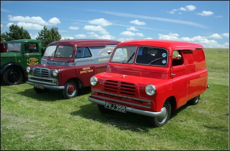

So here's a pic' of the real item [courtesy of Andrew Milner]................ as a kid/youth I wouldn't have given them a second glance - but in hindsight they're pretty cute and funky looking.
Notice how they have a "raised eyebrow" look to them...............
........... and that this has a distinct - "furrowed brow" look to it. The tops of the screens are just too flat, or level.
The window bead is waaay to thick and clumsy looking - and although a difficult thing to replicate this has got to go.
Which leads us to our first serious problem...............................
See that little bit of grey above the offside window beading? That is transparent resin - the whole of that top portion is wafer thin and is going to collapse as soon as I try and work the new shape of the windows - Grrrrr..already.

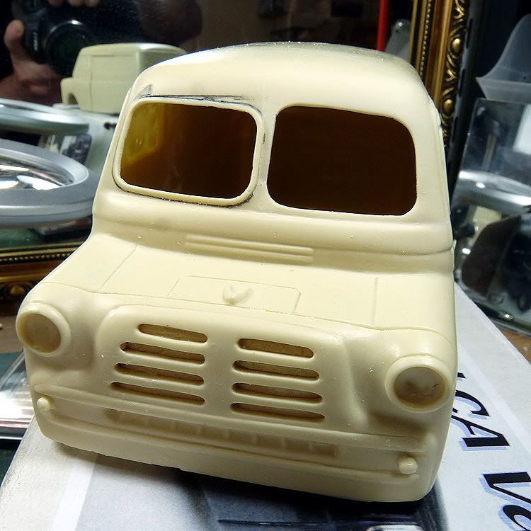

Anyhoo ..................... here's the other side cut out and put into something more sympathetic to its natural shape............
It can be seen that I've managed to recover some panel work under the screen and used that"shift" to take the aperture higher into the roof-line.
Here's a pic of the dodgy side now out and with a bit of styrene infill bonded into the aperture. the windows just simply do not fit into the body equally and so I've had to try and build up the outside a bit in order to centralise them - not successfully it transpires but it is starting to "taste" like a Bedford CA now....................
I've realised that I'm only going to be able to replicate the essence of this build at best ............. more a case of refining what's already here rather than trying to remodel every single anomaly.

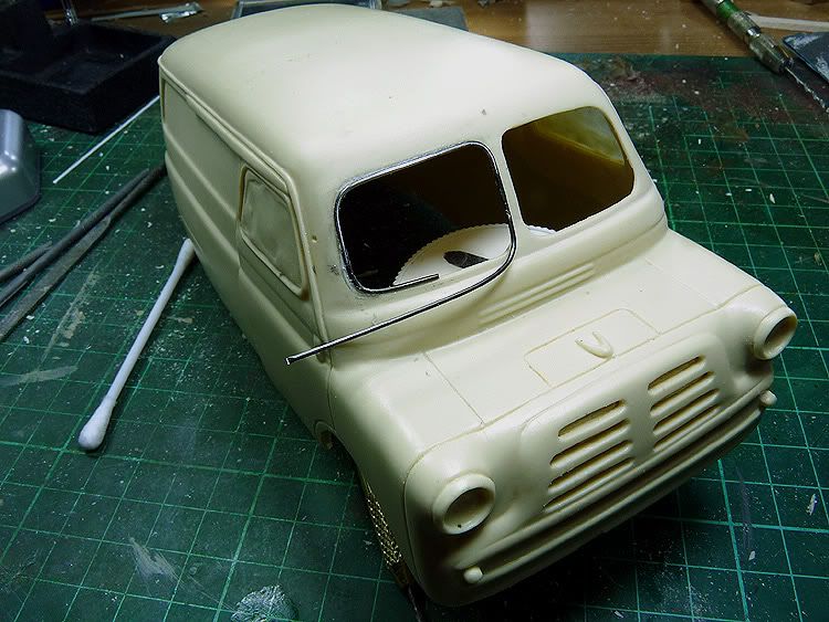

This is how I intend to replace the glazing beads. It's a fussy little process but yields good results if you can persevere................
Here's an example from a million years ago........
This was quite complex - especially the rear window - but it does go to show how versatile the technique is?
Meanwhile back on-topic...................... this is how simple the procedure is.................
Just florists wire - thin cyno and blu-tac .......... Oh and a goodly dollop of patience.
Here she is replete..........................
Notice that I've placed a thinner wire around the inside of the side windows ready to receive the glasswork. Perhaps other things to note are new dentals, the originals were lost when I opened the grill up - Oh, and the grills been opened up. It looks appalling in this shot, they're not quite as bad as they look here, as most of the discrepancy's are because of the wavering state of the interior. The grill has had a lot of work done do it. The slots are now level on the outside and not angled, the inside edges are square and not round and the upper slots have their single downward slope to them - I'm still very unhappy with the grille seeing as it's such an important part of the "look". But I've also got to be realistic in what I can expect from this build.
The front vents have been engraved, as has the rain gutter around the roof, the slider capping has been replaced with something just a tiny bit more prototypical and wire beading has been placed into the engraved lines to represent panel gaskets.
Absolute loads of panel sanding to try and bring things just a little more in line with what one expects to see, and I suspect there's a lot more fiddling to do yet.................

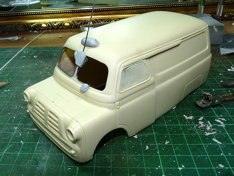

So, without any further ado ....................this as a reminder of where we started.......
And moving on a little................................
Perhaps the main things of note here are:- The straightening of the rear "van-body" panels, the building up of the rear wheel spats - the whole thing is so far out that to try and build it as per the prototype would require just too much work that would just result in throwing another measurement out - so with some judicious "pushing and pulling" I've managed to create the illusion of what I'm after if not museum accuracy.
I've created the "flat-top" effect to the front wheel arch, built up the froward and rear edges of same and re-profiled them to something more akin to the vehicle itself. Re-scribed the door and engraved it to get a better feel for the notion that it is a sliding assembly, and also built the base of the door up ready to create the running seam against it. Filled the completely wrong fuel filler door and filled the spat to "proud"! as I want this to appear slightly "ill-fitting" ready for distressing when it comes time to decorate it.
But just look!! - at the "HUGE" droop in the rain gutter and door valance - Oh groan - one repair just throws into view - yet another problem!!!
So, what's going on here then? - well you can see more modelling around the front wheel arch, more subtlety and a softer feel to to look of it, a deeper shut line" for the door with the leading edge lowered below the level of the front wing - again to give the feel of being two separate items as opposed to just a single adjoining surface. There has been a lot of scraping and modelling of the front wing where it meets the A post and makes the transition around from the bonnet to the side of the vehicle - nothing outrageous just enough to take the "Die-cast toy" look off of it.
The body panel has been shortened awaiting the rear door seem. And obviously a new door valance and rain gutter - still awaiting a little more reducing and shaping but I think already looking a whole lot better?
Final shaping of the rear wheel spat and now waiting for it's "wire" seam, plus a newly scribed fuel filler door, although I think the "finger pull" is a bit big and will need "knocking back" a touch.
A quick look around the front - mainly to allow us to see that all the judicious scraping a sanding is beginning to result in a much "sharper" look to the front and it's starting to really carry that "pugnacious" quality of the original. Only real work of note is the "line" placed between the screens and through to the roof this will form the spine of the subtle "V" that's again a distinctive styling cue of the MkI version of the original. The later Mk's carrying a shallow and then much deeper panoramic single piece screen.

Well - Earwig-Ho.............another back dated update - apologies to those that know where the latest ones are being posted - [there is no real rhyme or reason] - it must seem terribly disjointed?
So, an apology before the pic's - this ones all about the windows, and they're pretty grimy! I've fixed them in temporarily with Blu-tac and Pratt stick - and this has left them looking a bit second hand - this will be either addressed at final assembly - or I'll hide it with some judicious road-dirt over the glazing.
On then........................
How disgusting is this???? - It's a bliddy mess in here, and folk wondered why I wasn't prepared to open the doors - I'd still be in the "clean-up" stage.
Main thing to note though is the rebate that I've cut around the inside of the glazing wires - bit difficult to see but should be apparent if you squint hard enough. This did take a long time because of the disparity between the "chalky" nature of the resin and the "diamond hard" dry cyano. Blew one set of wire surrounds out and had to redo them once - couple of three repairs too.
Here's the inside of the side windows - you really are going to have to forgive me the state of the interior here. But you can see from the pic' a new set of "frames", these work better from the outside and look a bit more authentic than the wires I moulded in originally........... again with the rebate.
And now from the outside ........... the frame even in the raw looks a lot better to my eye, and I've cracked open the sliding window for a more "lived in" effect - the drivers [other] side more so!
And from the front ............... because I've got to take the screens out again they're not pressed "home" but you can see how they fit closer to the surface of the steelwork ridding the model of that horrible tunnel effect you get from kits/diecasts etc.
You can probably also see the "yellow" milliput that I've used to flush the surrounding steelwork to the wire frames and also build up the "widows peak" or "Vee" into the screen, this is subtle but definitely there on the early "splitscreen" CA's. More work to do around the wheel arch but some of that texture is being kept for R&R [Rot and Rust] later in the build.
I'm glad this bits over as I had convinced myself it was going to be a kill-or-cure part of the build - and so it was. But glad that it's over as I'm a bit more confident - enough even to continue ........... although now I've got those ruddy awful back doors to sort out.
