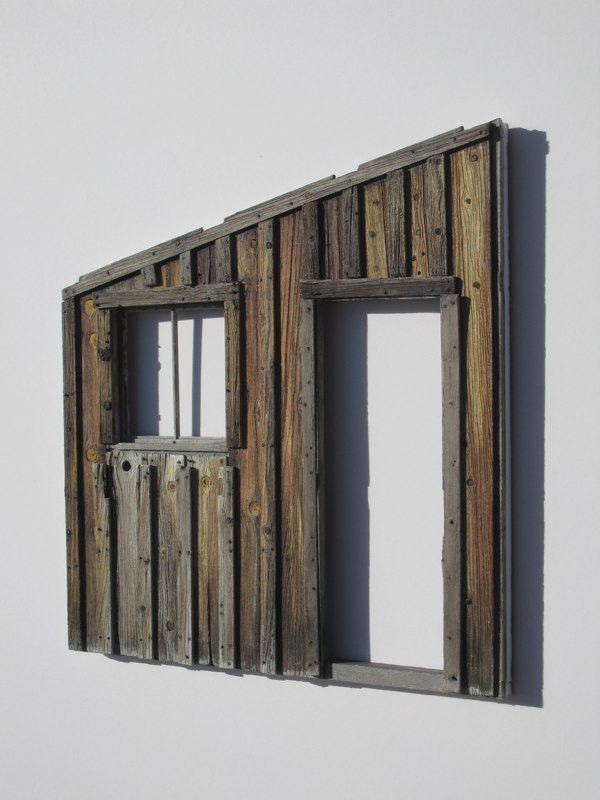

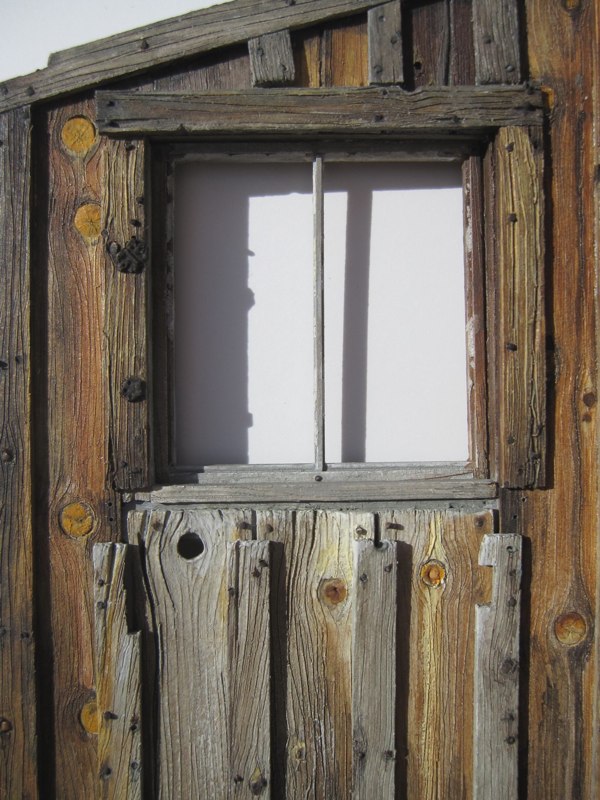

Here's a project I've been working on lately as an experiment to see how far I can push the envelope, using styrene to represent weathered wood. I built up one wall, board by board, trying to get it as close as possible to the prototype. This will be in the article I'm writing for the "Modeler's Annual".

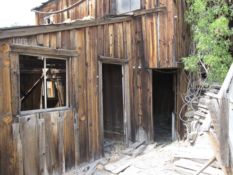

First, here's a photos of the prototype, part of a dilapidated old house in Tonopah, NV:

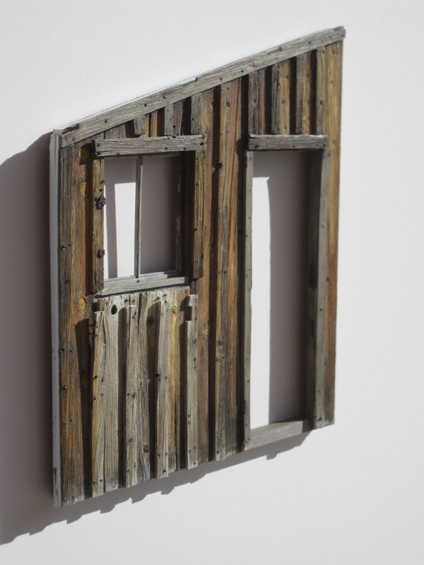

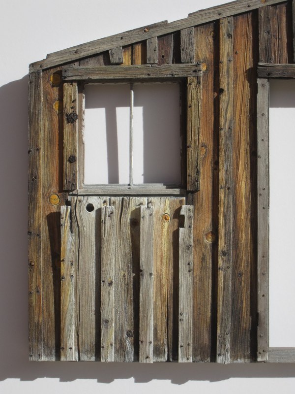

And here are some shots of the 1/24th scale model wall:

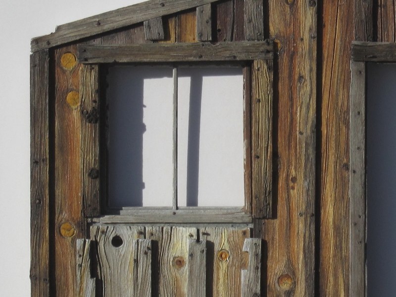

The nails are tiny pieces of .020" brass rod, inserted into drilled holes. I wanted to use .015" rod, but didn't have any available locally and didn't want to wait to have some shipped.
I haven't decided yet whether I'll build the entire structure, or just complete this section of it and attach it to different building.
Enjoy!
Ray
Now that is some beautiful looking wood, I mean styrene!!!!  Hell I think you should do the whole building in styrene.
The nails are great but how did you do the knots??????
In general I frown upon people who try and make styrene look like wood because in the overwhelming majority of cases they fail miserably , but I have to say that you have made an excellent case for the argument that it can be done . Congratulations , your wall looks like wood .
  Though I don't think I'll try and copy you ,
Geoff Ringle
That is mighty fine work Ray.  I don't think real wood could look closer to prototype example.
darrylhuffman

Wow Ray,
Excellent result.  Very nice tonal changes in the aging wood.  Its a pretty faithful reproduction of the original wall.  Would be keen to hear more on the process when time permits.
That is certainly impressive, both the grain an knot detail but it is the colouring you have achieved that is what makes it really exceptional.
Whilst I cannot think of too many prototypes for this amount of sun weathered wood over here would really like to know some more details of the paint processes you used

Thanks. I think I need to work on the photography a bit... the color is a little "off". The close ups look pretty good but the overall shots seem to have a slight greenish or bluish cast.

Holy Crap!  And "ditto" what Gordon and the others have said ... will definitely look forward to that Annual for more info.  The knots look great ... the grain follows the knots correctly ... the coloring is amazing.  Al Armitage would be very, very proud of you!  WOW   :o  -- Dallas
Wow!...well, am floored! That looks just beautiful, and as gordon said, the coloring is exceptional. Heck, I wish I could get real wood to look thiss good. I look forward to the article, and learning how to do this.
