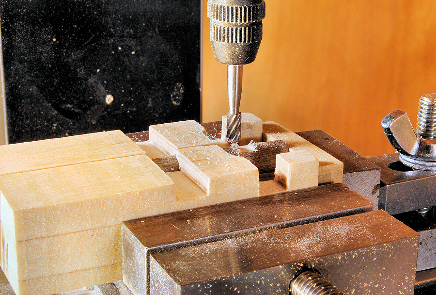

I made a small jig for a project using Poplar from the dowel section at my local Lowes. It worked .. just. Working on this I found myself wondering if there is a plastic that would machine well for such small projects? Thinking something like a block of PVC would work better then wood.
Just for size .. that's a 1/4" Dremel router bit doing the work ..
