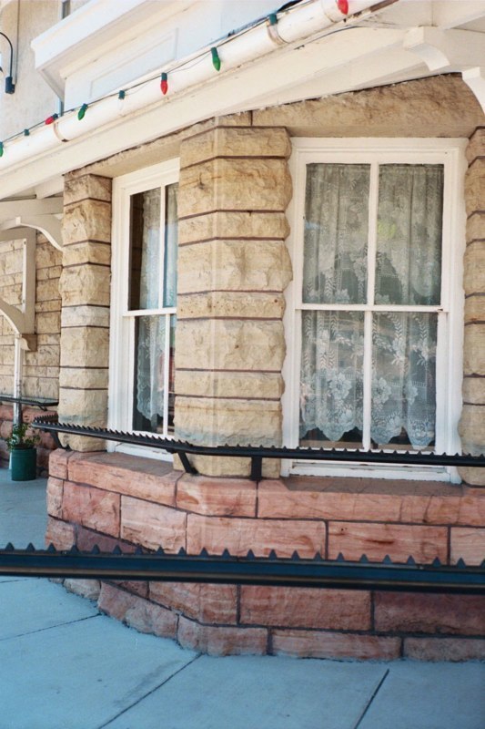

I'm trying to figure out a way to model (in 1/24th scale) a building made of sandstone blocks, such as this:

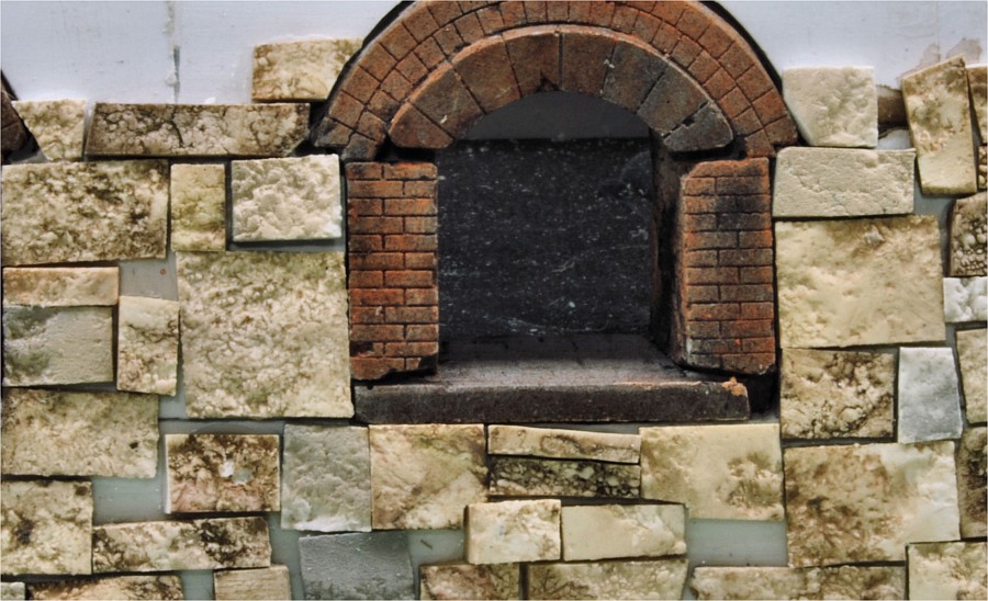

Ray, is this too rough?
Acheived by laying building wall flat, cutting stone shapes out of thick card 1.5mm, & applying mix of Acrylic/fine sand/ filler (Spackle?)/white wood glue & water to a thick consistancy, & stippling mix to card shapes glued to wall  which held mix to shape while dried.
Maybe you could do same to flat strips & use them to do some castings?
I used random stone shapes, but would also work with more regular block shapes
Edit;   the dressed corner stones were done with same mix, but applied in a thinner layer & brushed out horizontally with a coarse paint brush
Don in sunny Devon, England

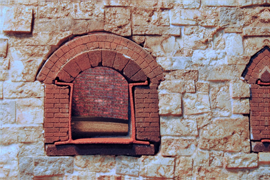

A couple of In-Progress shots of my coke oven bank 'stone'. The stone is Sculpey .. textured with a piece of red lava rock
Marc's comments are my thoughts also.   Use Sculpy or POP for the blocks and put it down in a sheet.   Roll up a ball of crinkled foil and roll it over the entire sheet.   Then cut out the blocks when dry and arrange them in a random patter to make your mold from.
