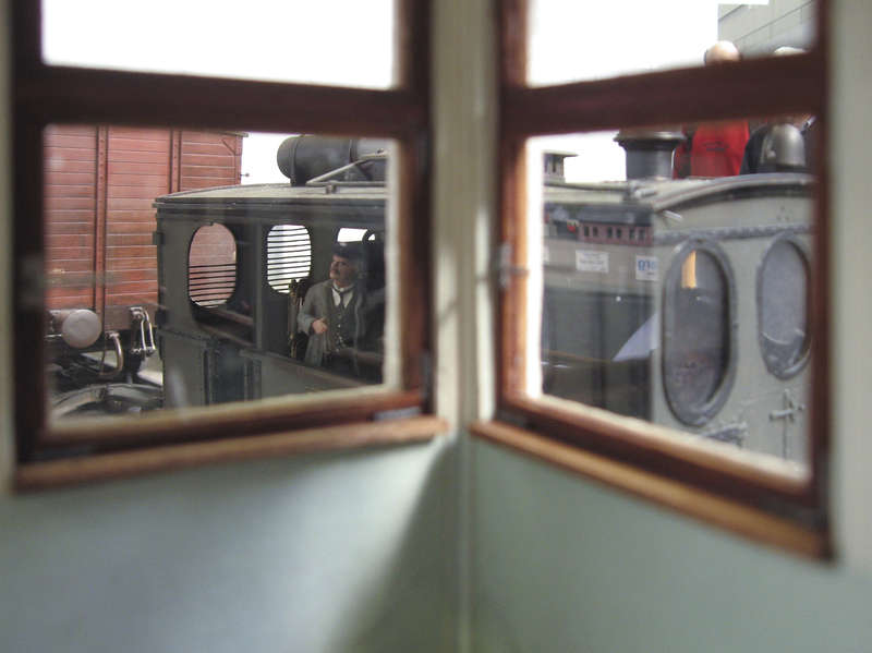

With three stunned giants looking on in the background!
Superb work ....... again!
For an exercise module I have to say this is extraordinary modelling at its best.
I know that it's an exercise module,...................... so when will you start on the real one?
Can't wait to see that!
Amazing! Thanks for posting the additional pics and info.
This is totally insane ... in a good way! -- Russ

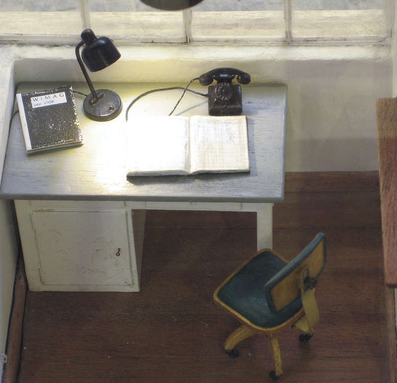

Some snapshots:
Evil eye to the janitor.
He forgot to close the door.
Now the train can run.

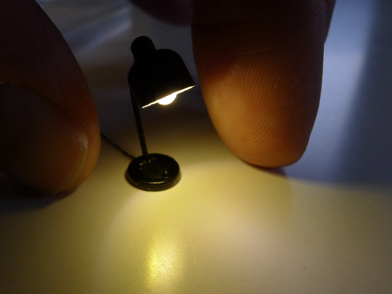

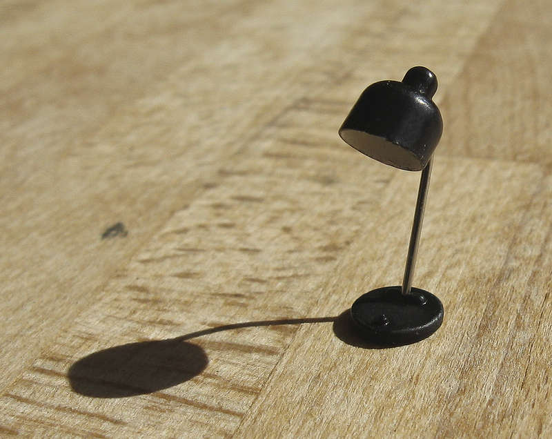

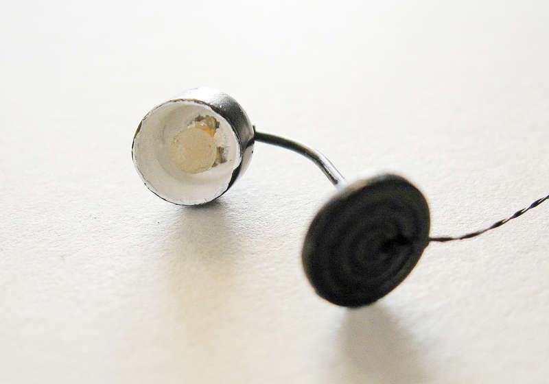

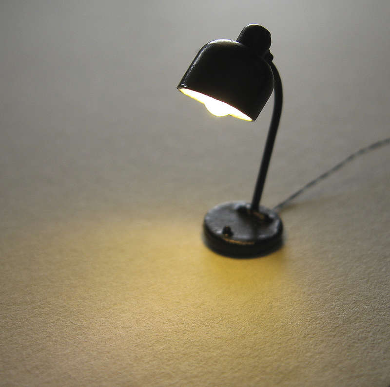

Regarding Helmut's lighting there's nothing left to be added ... aside of this:
A bulb was missing.
It's a FUD printed part glued to the LED.
Please don't mind the paintwork ... I'll fix that.

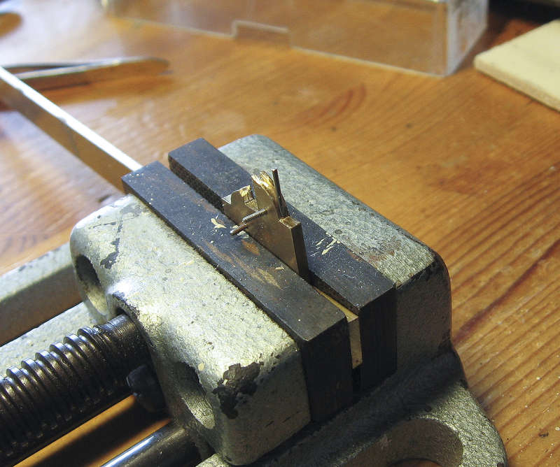

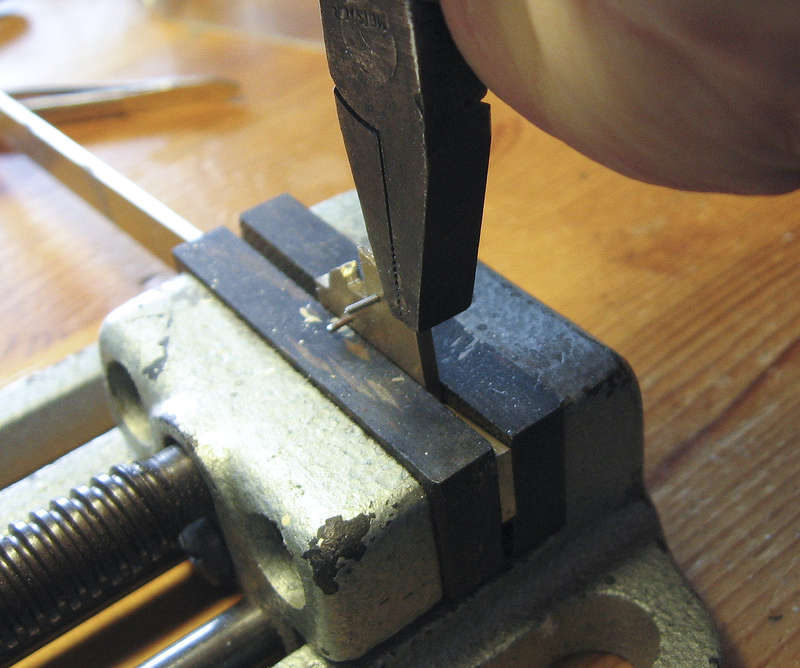

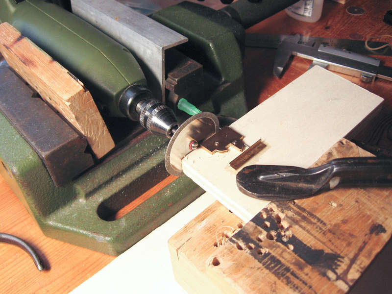

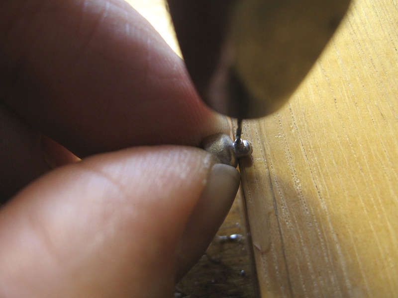

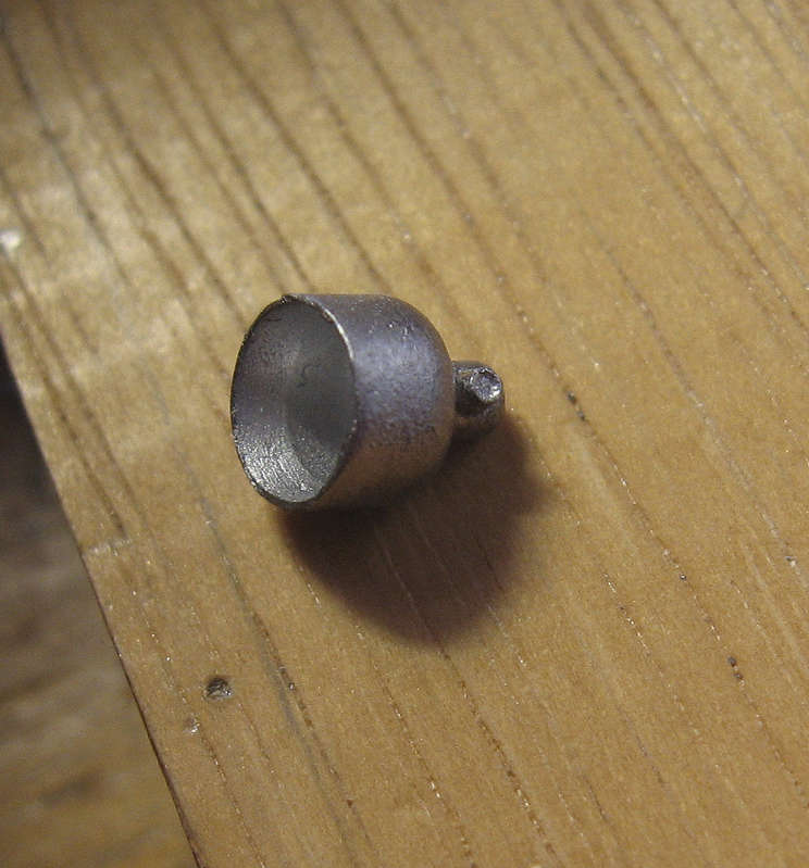

Here's how the single parts congregate. Helmut was able to mill the inner hole of the lampshade CNC based, using a jig. Unfortunately the feed-through for the stand had to be drilled by hand. There's too much deviation within (in, on, with, at) the cast white metal parts. There's only 0.1 mm wall thickness left at the thinnest part after drilling so I had to do that by hand. The cast lampshade part already has a center mark for that.
I used a pen drill for that. Drill diameter is 0.6 mm in 1/32 and 0.8 mm in 1/22.5 scale.

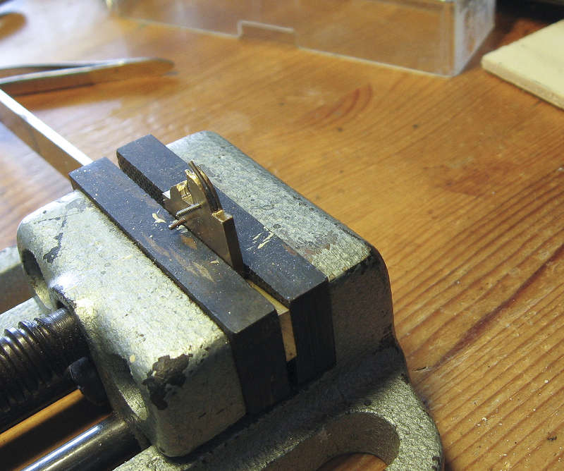

Helmut milled a jig for the stands, which I also used for cutting the injection needles.
The deburred segments fit to the jig ...
and I bend them with the collet jaw to the jig, which has a somewhat tighter radius than the prototype for compensation of the rebounding.
That's it.
The bulb is the icing on the cake!

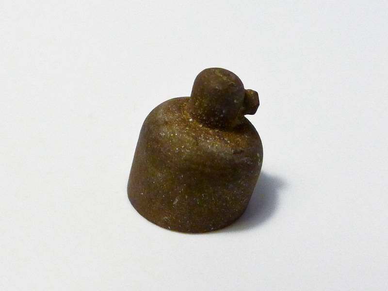

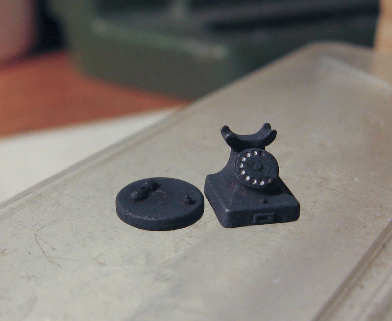

Color adhesion on white metal seems to be a problem. It's less or equal zero. Maybe some primer may help, but there'll be an additional layer to hide details.
At a tiffany supplier I found a blackening fluid for pewter. Boiling the items in some water with detergent helps to make them fat free. I then dunked them into the fluid until they went black. The fluid changes to a rusty brown soon after that. It's interesting to add a white metal part to this "rusty" fluid: It doesn't get black, but rusty!
This is after blackening:
I found the fluid here - this surely isn't the producer: http://www.ebay.de/itm/250650591700?ssPageName=STRK:MEWNX:IT&_trksid=p3984.m1497.l2649

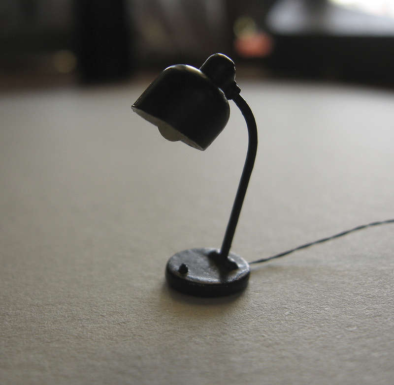

Now color really sticks to the material!
I didn't like the different gloss levels, so I used a felt disc to polish it a bit.
If the blackening worked well and didn't get too brownish one can even polish the blackened surface. This gives an phantastic impression, but the surface of the cast items mostly is too coarse ...

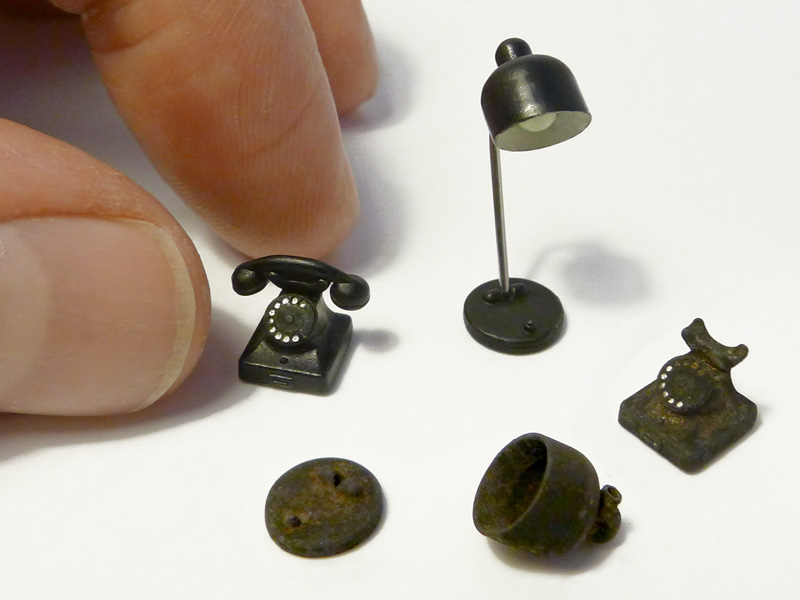

A few days ago Volker visited me. He delivered a package to me.
Safely packed, I got his phone and a desk lamp.
It is always amazing how well Helmut and Volker handeld these really small parts.

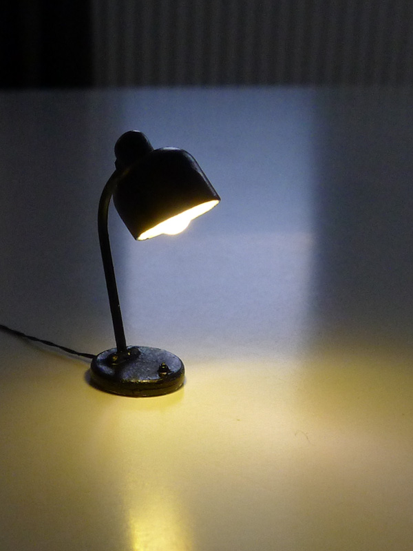

Although I recognize that the macro shots shows all the details and small errors adamant, but the size of these parts now lying in front of me, I felt ( as so often ): It looks darned small!
Tischlampe_1zu22_5_01 (fspg2)
Tischlampe_1zu22_5_02 (fspg2)

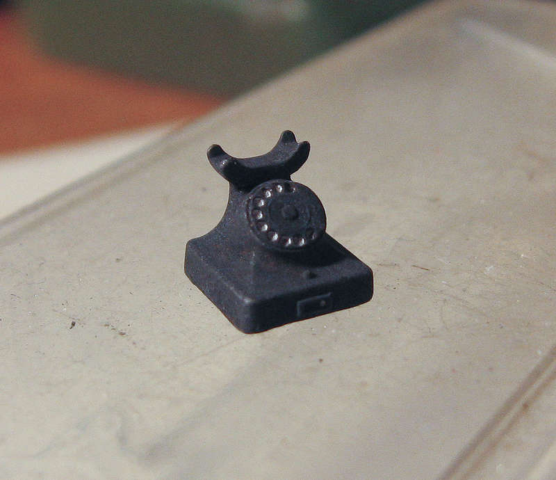

The two polished parts give the surface and the shine of the prototyp again convincingly!
The white design of the dial is successful, it doesn´t matter that the numbers are not readable.

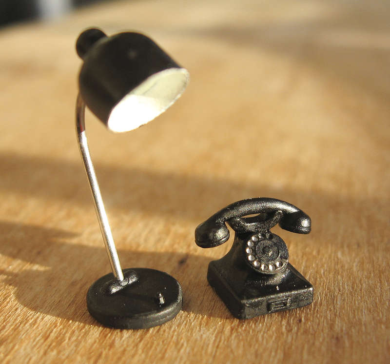

Tischlampe_1zu22_5_03 (fspg2)
As well there were still an archaeological dig on the table. Had the ravages of time left behind its marks on the parts??
If I remember, the telephone was made of Bakelite ... but the surface here looks rusty...
Volker, now you have to tell us the details.
Tischlampe_1zu22_5_04 (fspg2)
How does that grab you: The fingers will press on the 0.3mm switch ... its may be a bloody  thing... perhaps an electronic touch switch hidden in the desk under the lamp will help....
Anyway, I'm curious about the result !
