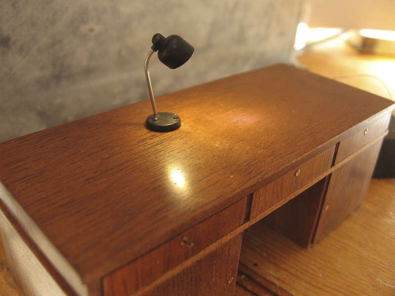

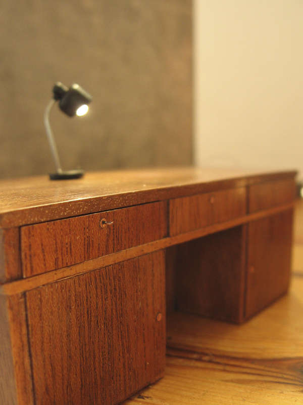

Anyway - I need this desk for testing the lamp switch. And I like the rosewoodish impression of my veneer and so I tried on to improve it at least a bit. First attempt was using a wood filler. This worked well, but as Russ mentioned it brings a somewhat artificial coloring to the wood. When I then started applying thinned nail enamel all the filler came off ... Reset. There was nothing to loose, so some CA had to serve as filler. That worked well and after sanding it down, applying mat lacqquer and polishing it with shoe polish it's a bit better. I think Marty meant the grain of the desktop front; this should be running parallel to the desktop (I glued two layers of veneer at right angles). No, this is no great result, but CA again has proven as a good home remedy.

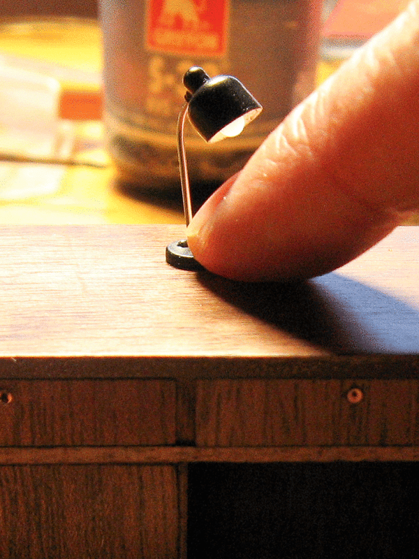

Meanwhile I was able to build my first own lamp:
Now I'm waiting for Helmut's shipment with some electronic device for the switch which then should work.
Noticeable improvement on the desk. The lamp looks good, too. Altogether a very successful exercise. -- Russ

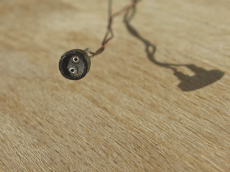

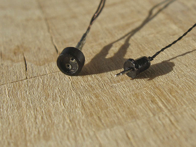

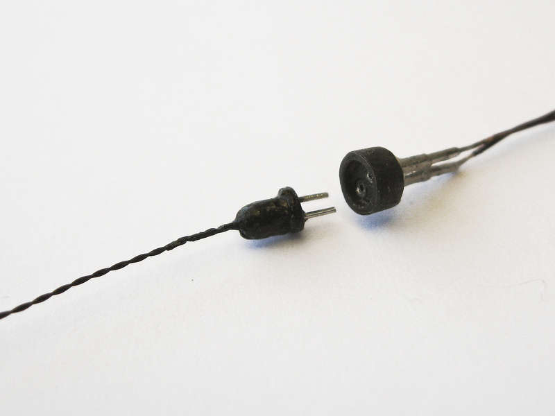

Thanks gentlemen, for your complaisant assessment of my mental condition. Do you really think that's insane? So what is this:
Well, the plug is amendable concerning its form, but it works both ways mechanically and electrically. Diameter of socket is 3.5 mm.

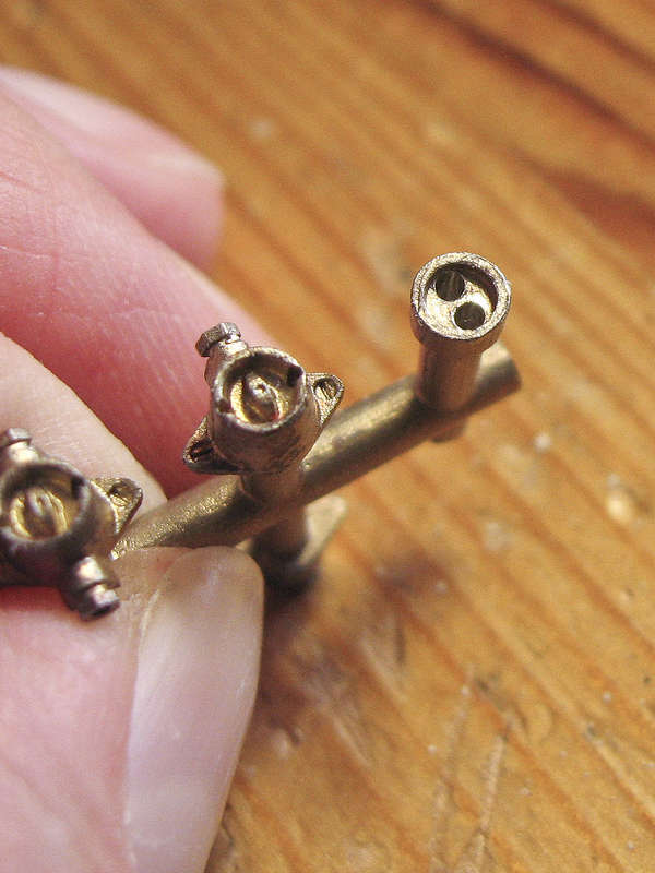

Base is a brass casting socket by Frithjof. The looming holes for the plug had to be enlarged to 1 mm and drilled through the complete casting which then was cut off. 0.65 mm hypodermic needles with some soldered enamel copper wire serve as shafts for the 0.3 mm plug pins. The upper plastic part of the needles was sanded and filed down to 1 mm diameter using the Dremel as a lathe to get them fitting to the holes.

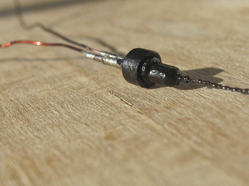

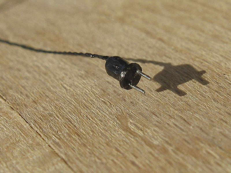

The plug consists of a small PS plate, two 0.3 mm pins with soldered 0.15 mm sec and a piece of a wooden toothpick, which was rounded and carved at the sides for pins and cbles. No CAD machinery or drawings.

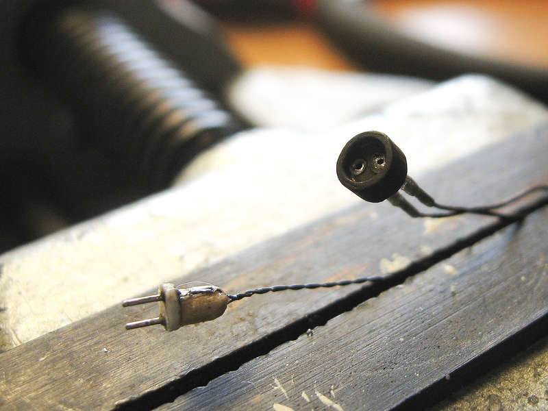

I didn't like the coarse form of the plug, but this should work now after some improvement:
