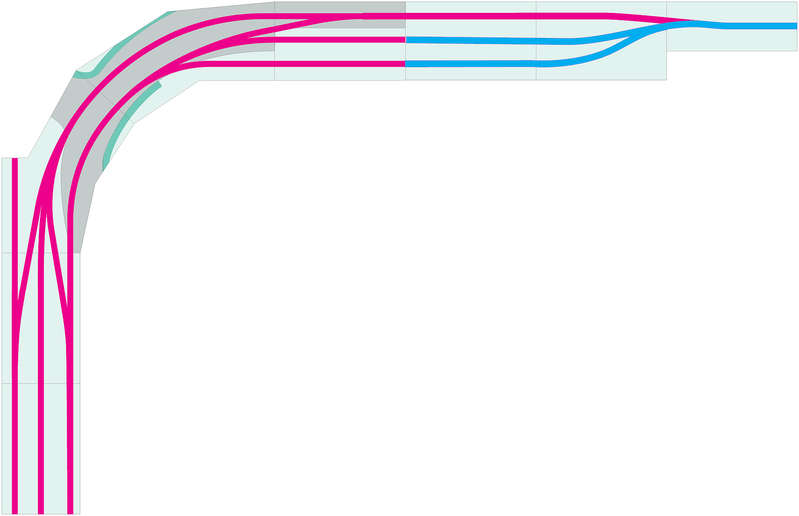

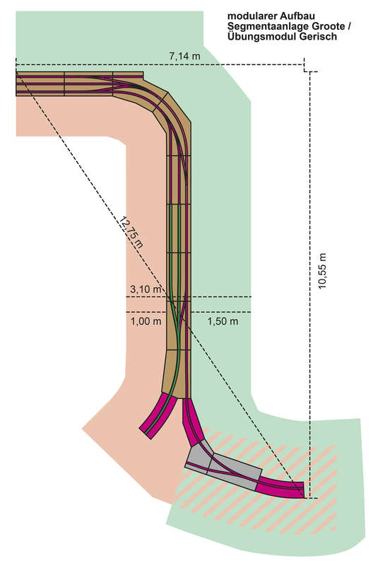

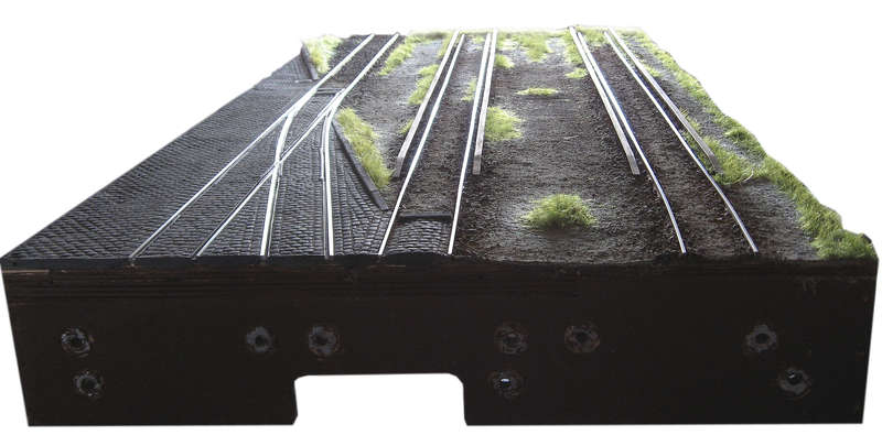

Some explanations about the segmental layout "Sauerland-Segmentanlage": Owner is Wolf Groote, whom I mentioned before as an author who has written books about some Sauerland narrow gauge railways. The layout is oriented toward prototype situations from two narrow gauge lines in the Sauerland area, the 'Plettenberger Kleinbahn' and the 'Hohenlimburger Kleinbahn', which had a similar kind of purpose and operation. The Plettenberg line closed down 1959, but the Hohenlimburger Kleinbahn ran until 1983.
There were some layout changes over the time due to presentation issues. This is the former layout plan
and this is the current version with improved track plan and longer routes for servicing the plant at the 'exercise module'
Neither track plan nor dimensions correspond to the prototype, but we tried to get an impression of two situations at least: The Rollwagen exchange yard from Hohenlimburg and the loco shed from Plettenberg-Eiringhausen. The latter is situated on the upper left wing's segments, the former on the vertical segments. The exercise module is situated in the lower right wing. Nearly all the trackage (Code 250) and pointwork is custom made. Green stands for standard gauge, magenta for metre gauge. The main aim is to show this special kind of operation on a working layout. Visitors' area is greenish, operating area pink-colored.

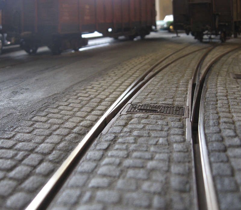

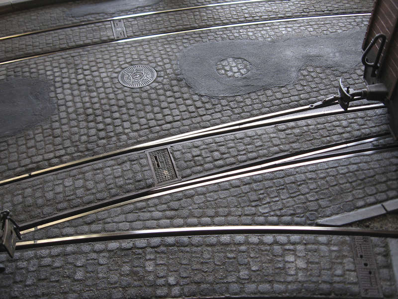

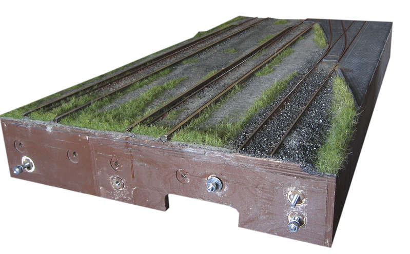

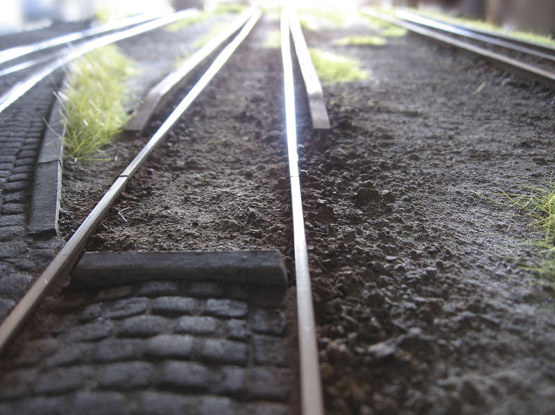

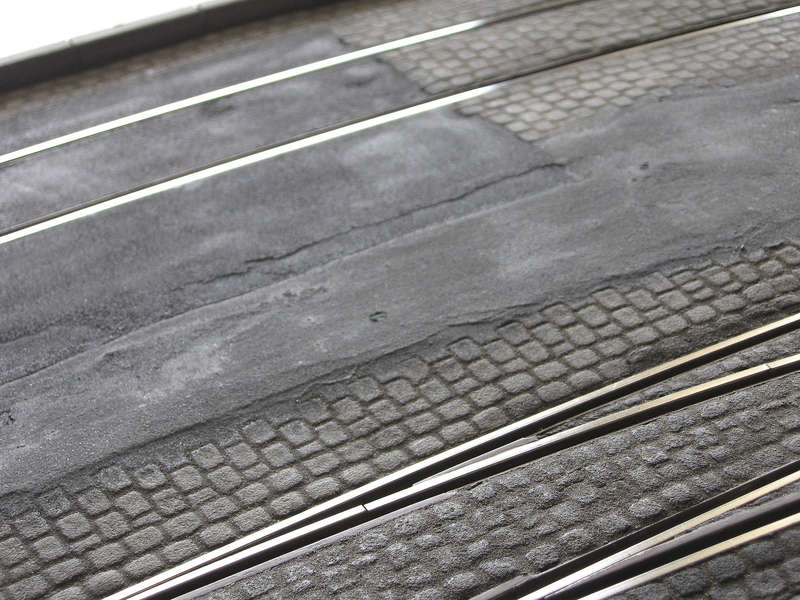

Here are some pics of the exchange yard segment:
And of the subsequent segment:

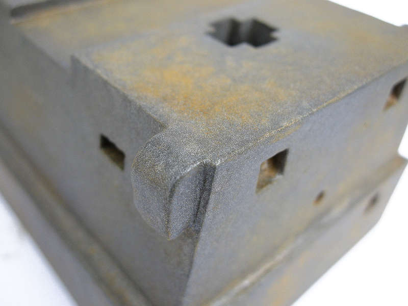

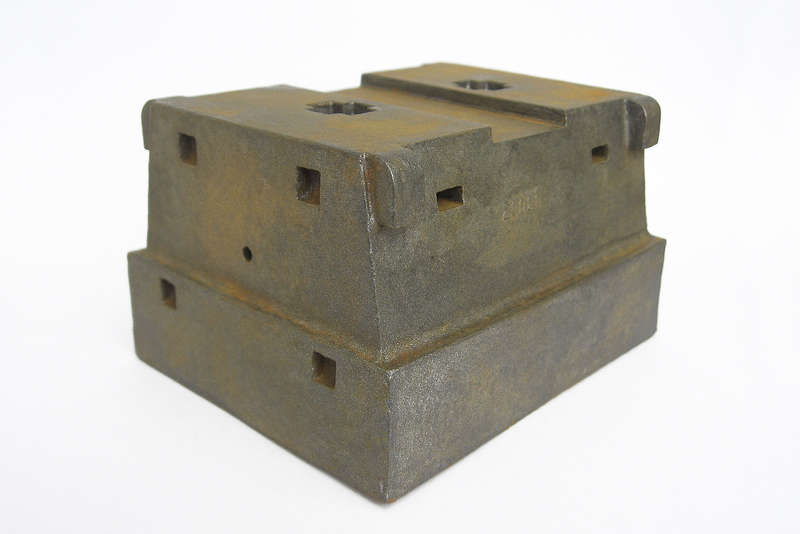

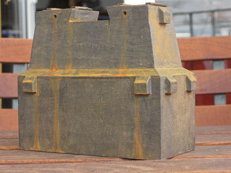

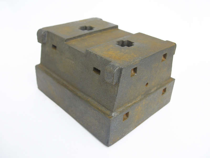

some time ago in this thread I had shown an anvil block of a normal drop hammer; back then my reference was a very bad photo from the beginning of 20th century, which does explain some detail mistakes but not my completetly wrong estimate of proportions
Such an anvil block rather looks like that:
My friend Wolf took some dimensions of an scrap anvil block, took photos and even found some technical drawings, which allowed to make precise CAD-Drawings. This composition shows the main parts of those hammers which still can be found at some drop forge plants:
The anvil block and the iron hammer running between the both rods carry one part of the forging die each. The rods are held together with the slotted part. There's a leather strap running through the slot, driven bei a clutched drum, which allows to raise and release the hammer. The vertical rods are fixed with more rods and wedges via the openings in the anvil block.

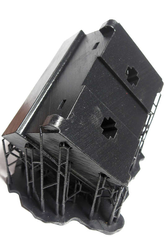

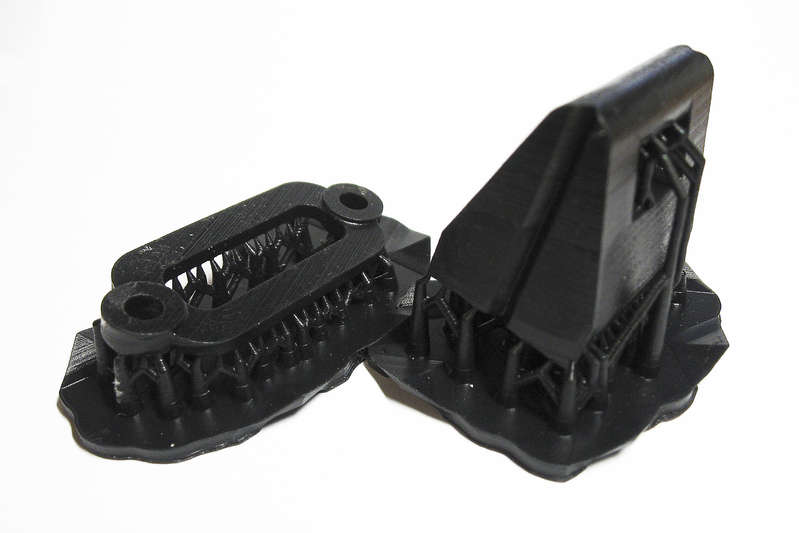

The model is going to serve as freight or only just delivered good at the plant's yard. I relinquish the additional mechanical parts; some wooden boxes may indicate them. The anvil block is predestined for 3D printing because of the slots and inner intersections. A guy from buntbahn bought an own 3D printer and offered to print parts for members for a very fair price:
I think HR Giger might have got a real kick out of those "ingrown" parts ...

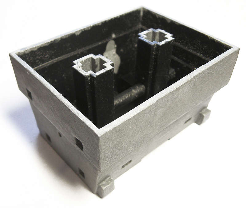

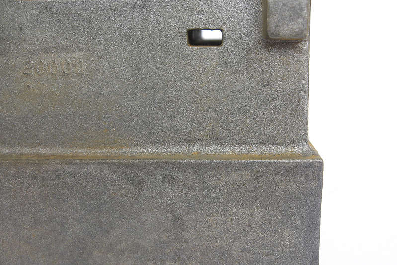

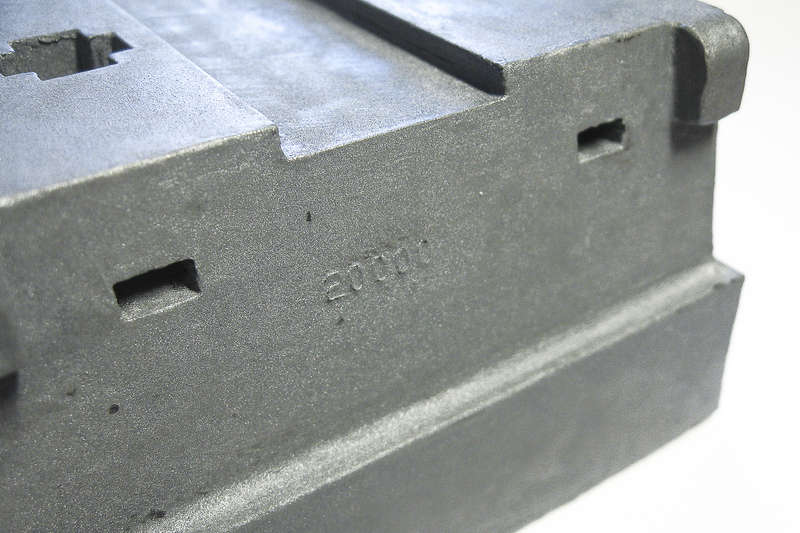

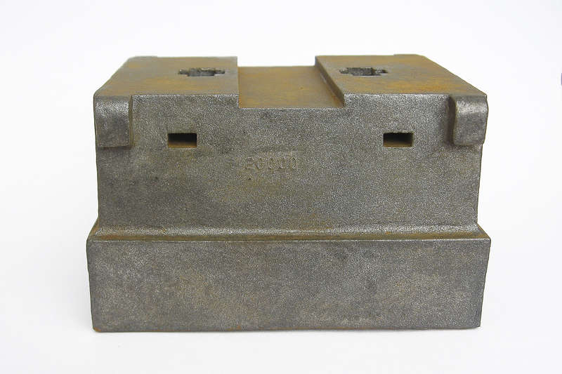

The main body is hollow with a wall thickness of app. 3 mm.
The visible layers don't matter for this purpose and size. As I did before I used silicon carbide F360 mixed to silver Revell enamel and thinner. This allows to hide the layer structure with the particles, but the details like the lettering remain visible.

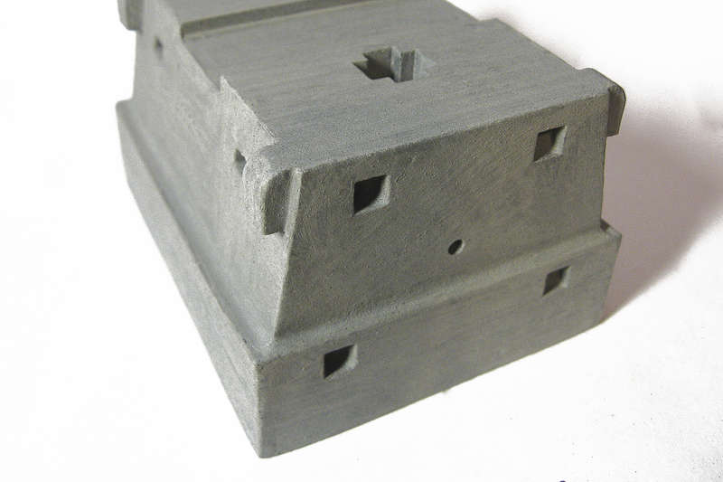

Next step was a layer of slate powder in a solution of water and PVA.

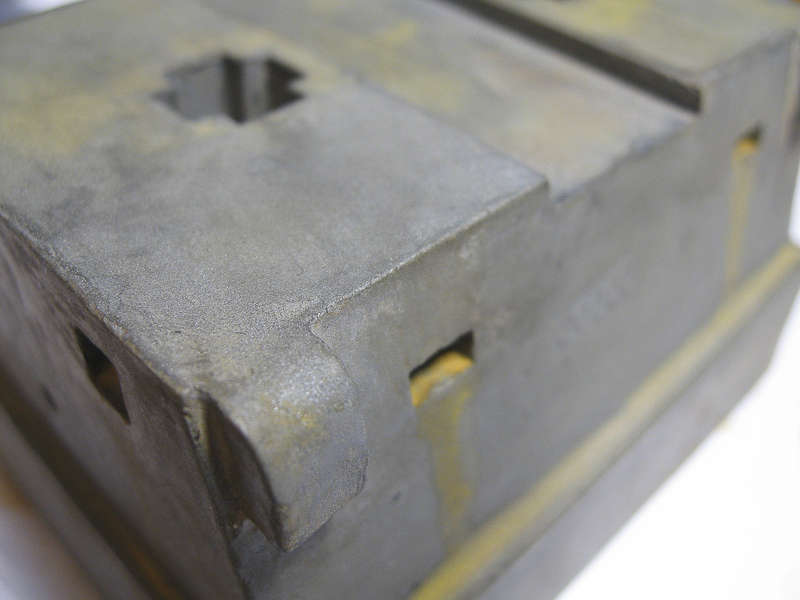

Then sanding everything with fine sandpaper to even the brush traces and adding some rust traces with gouache.
Well, I didn't like the result at all. I missed the dark tone from back then. What went wrong? I simply used the wrong silver color. After applying another layer of Revell enamel 91, dull clear varnish 2 and quite a lot of thinner there was the desired dark tone. This time I abdicated the rust traces and restricted myself to some Terra di Sienna (natural) pigments.
The cavity is filled with the same putty used for the cobblestones in the last posts.This gives some reasonable weight to the model.
