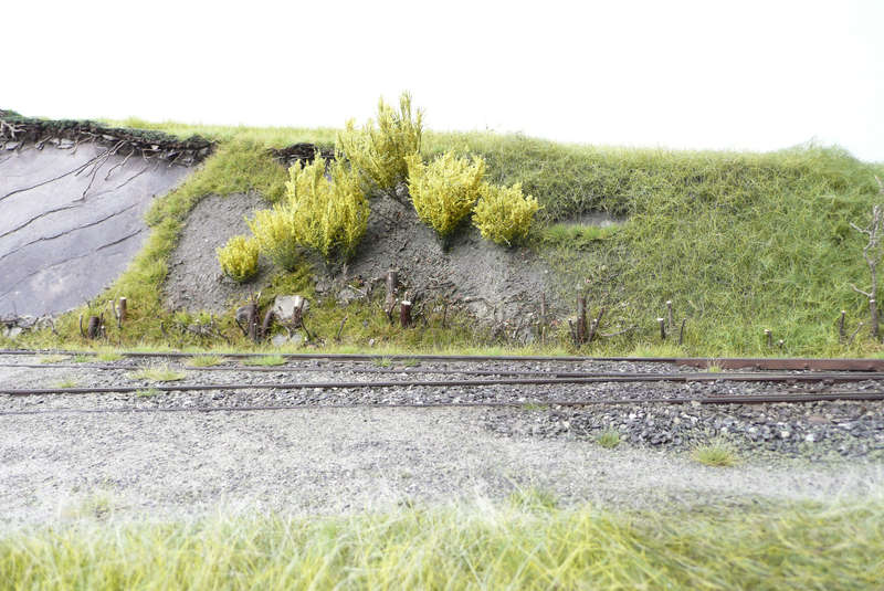

Quote from: Ray Dunakin on February 29, 2020, 09:17:08 PM
Such wonderful work! What kind of tank car is that?
Ray,
thank you. It is a gauge 2 car by Magnus/Höhne. The company doesn't exist anymore. Quality / detailing corresponds with LGB standard. It doesn't really fit the engines' or Rollwagens' standard. My friend Uwe took the car to the exhibition to take some pictures.

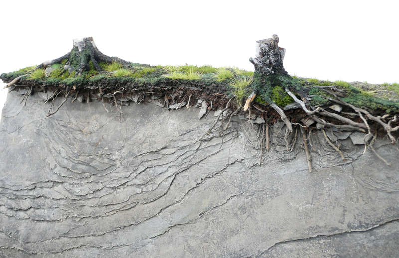

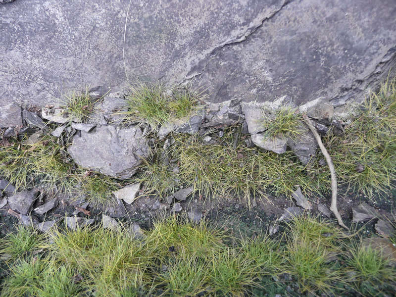

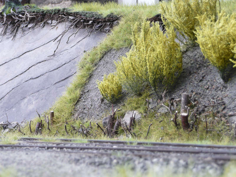

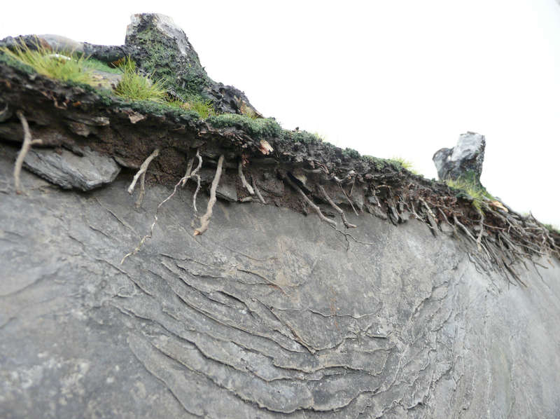

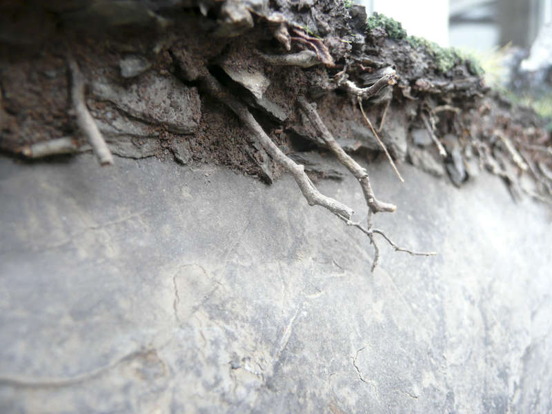

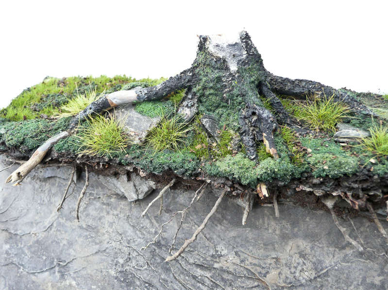

Quote from: Lawton Maner on February 29, 2020, 02:23:12 PM
Can you please share a picture of the tree roots at the top of the shale in the last photo? My error.  It should be the first photo that has the tree roots.
Lawton,
I had to wait until today to take some better pictures. There's some sawdust and more fine roots to come, but here we go.

I have rarely or never seen scenery modeled to that level of excellence. -- Russ
Thanks for the photos.
Fantastic work.
If I enlarge the photos will I see the worms digging through the soil?
That overhanging layer of soil, rocks, and roots is incredibly realistic!
Bernhard

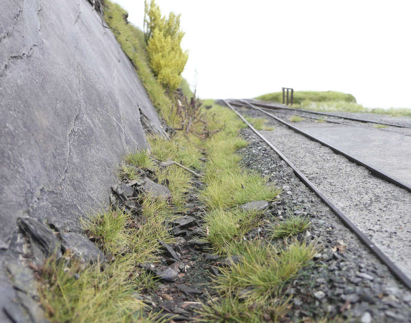

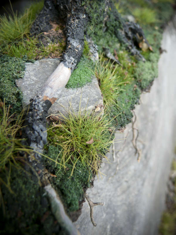

Volker, looking at the Kuhlmann easel brings back old memories. And the the cliff edge is really of the finest.
Quote from: Lawton Maner on March 08, 2020, 03:54:56 PM
Fantastic work.
The worms are usually inside the soil. They tend to come out if it rains. But it never rains in California.

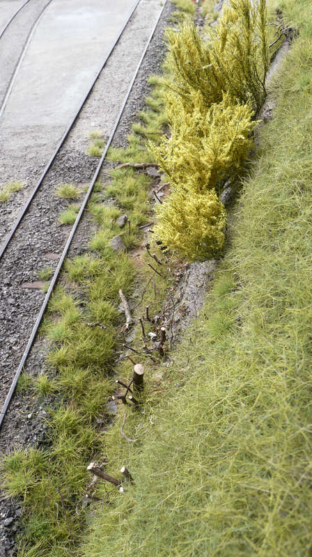

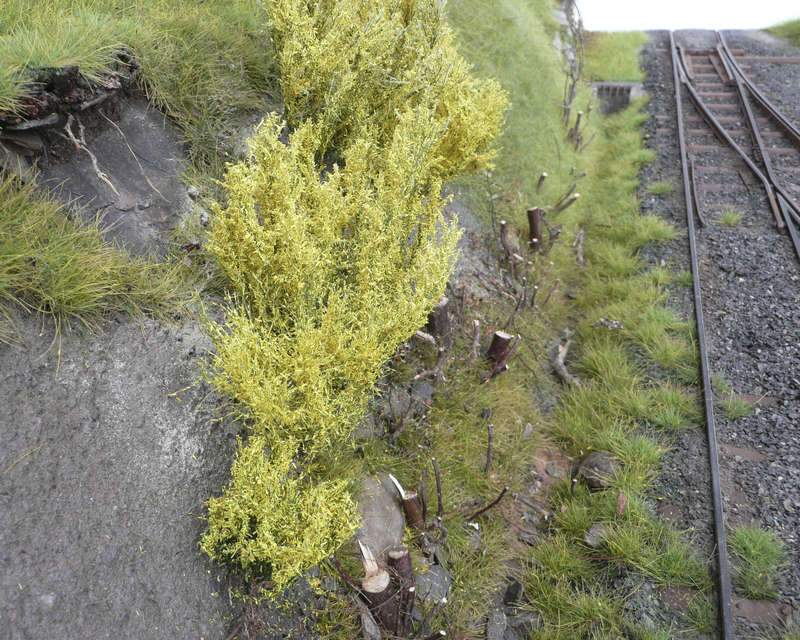

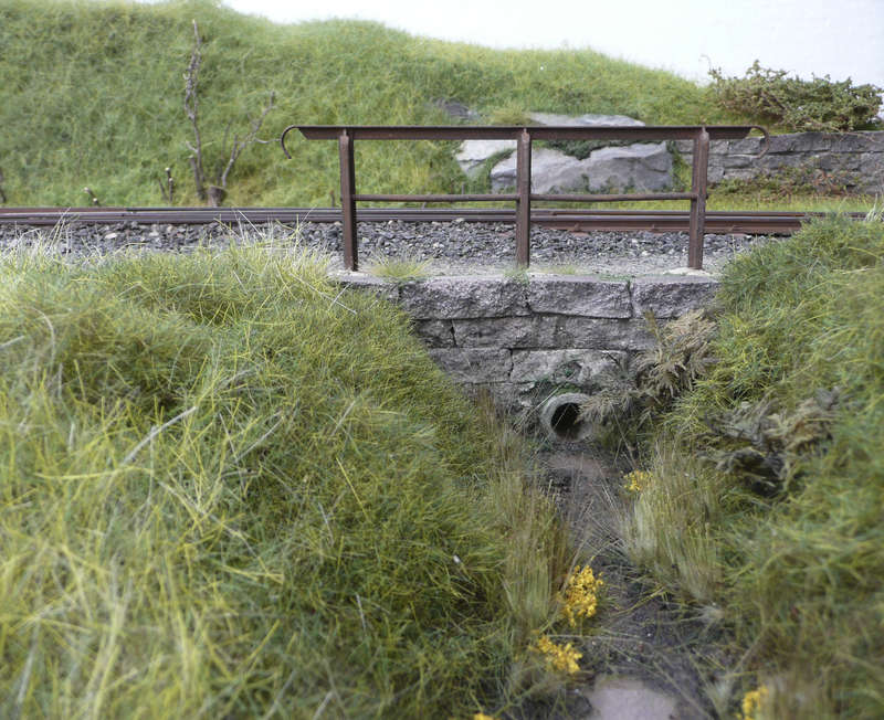

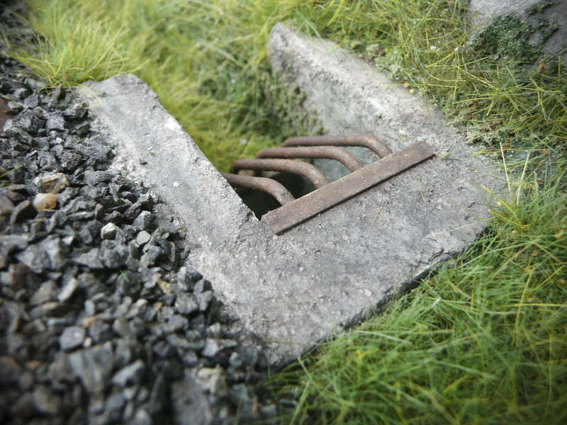

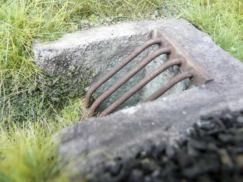

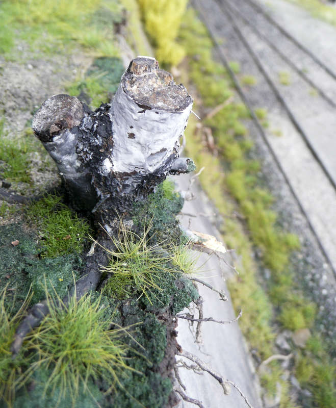

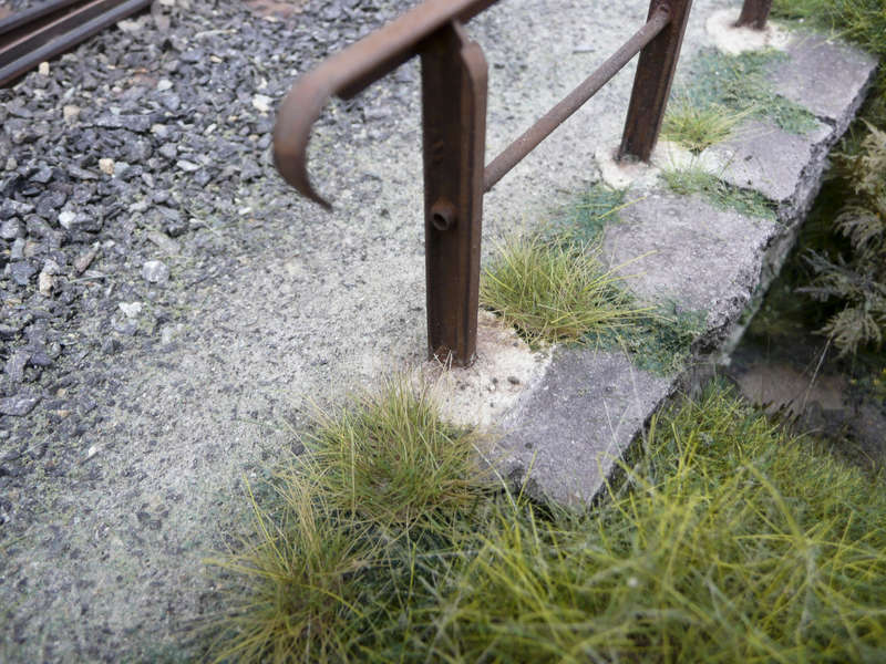

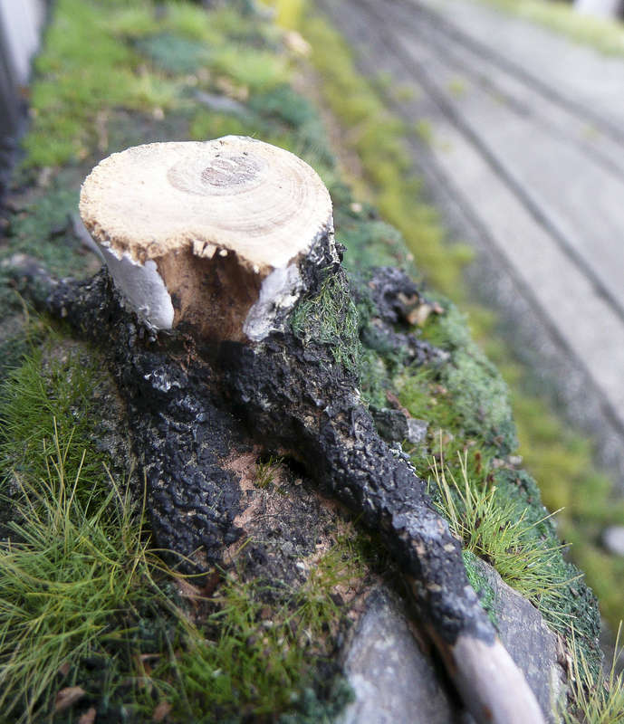

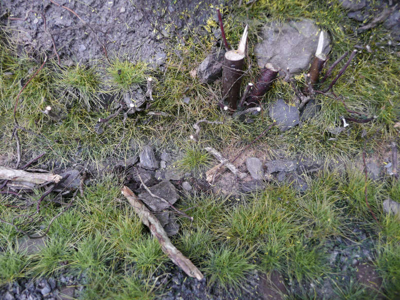

Some more stuff:
Bernhard
The grille and the cemented posts of the railing are absolute tops.
There is so much to love about this diorama! Even the smallest details of the scenery are perfect!

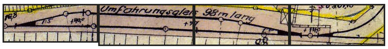

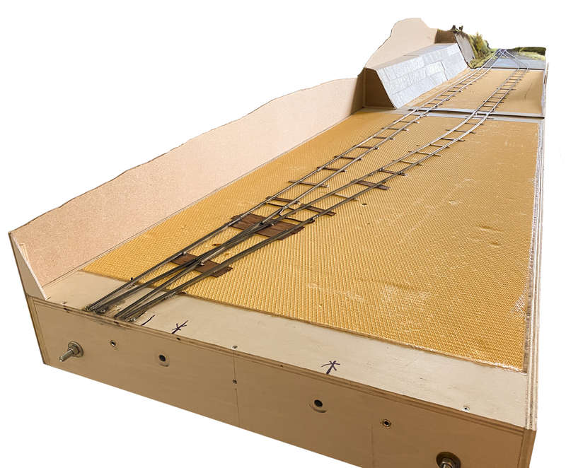

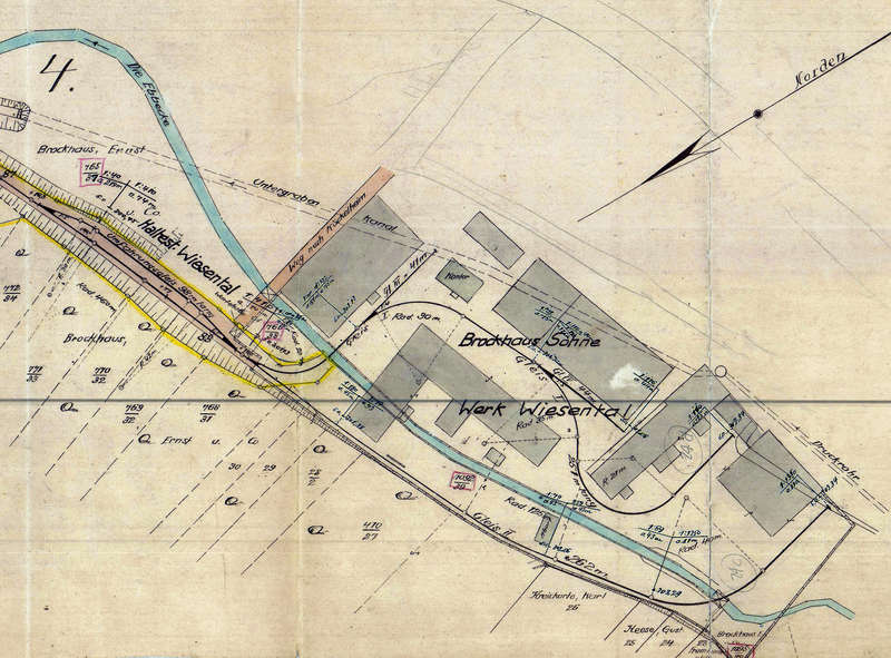

The last weeks provided some extra time for the Wiesenthal stop. This is a plan of the Oestertal line's terminus and the Brockhaus & Söhne factory.
(Slg. Wolf Dietrich Groote)
Would it be possible to model that stop to scale? It would, according to some rather big segments of 140 x 62 cm.
There are only few pictures of that area available and most of them are published in this book. This picture isn't in the book, but shows the landscape / environment very well.

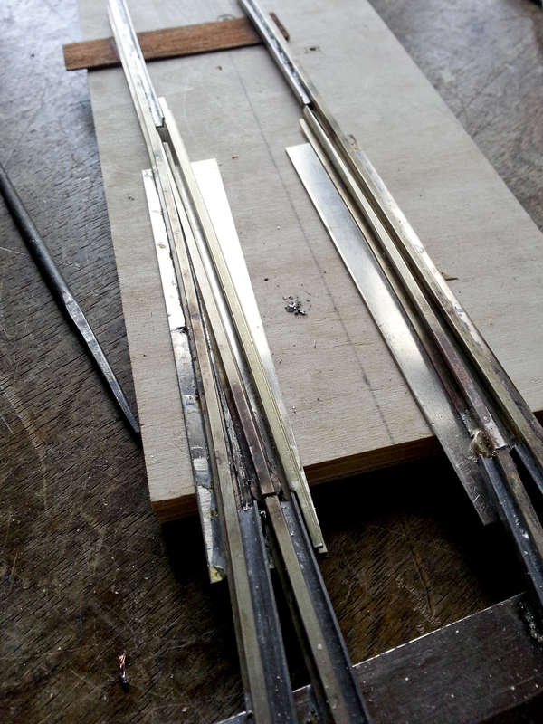

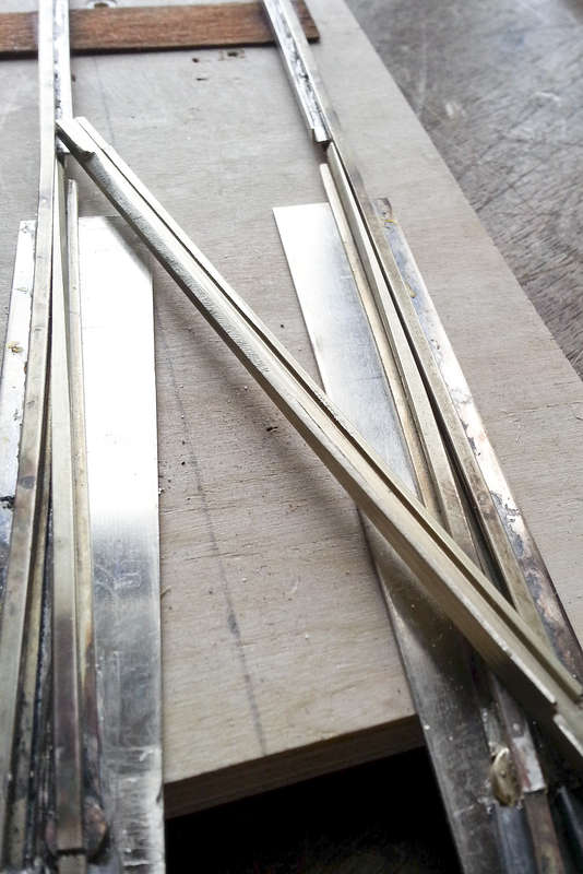

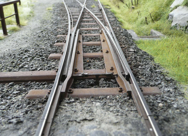

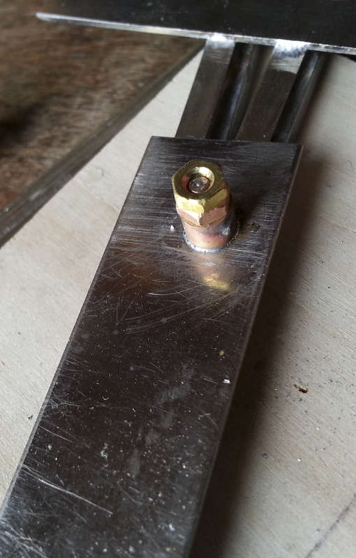

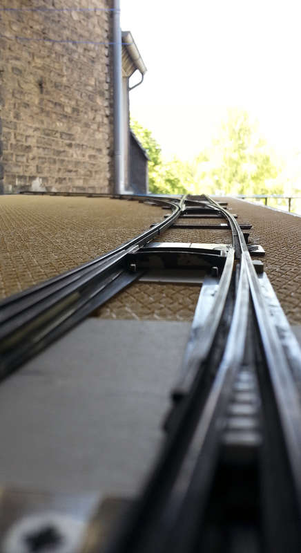

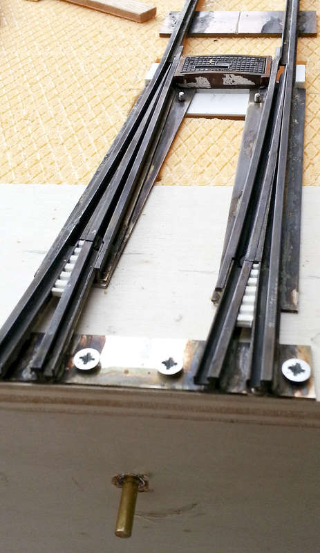

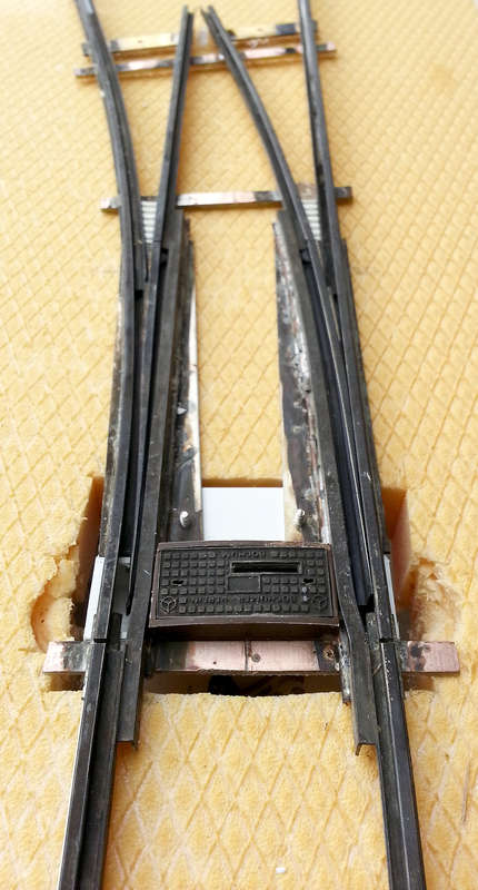

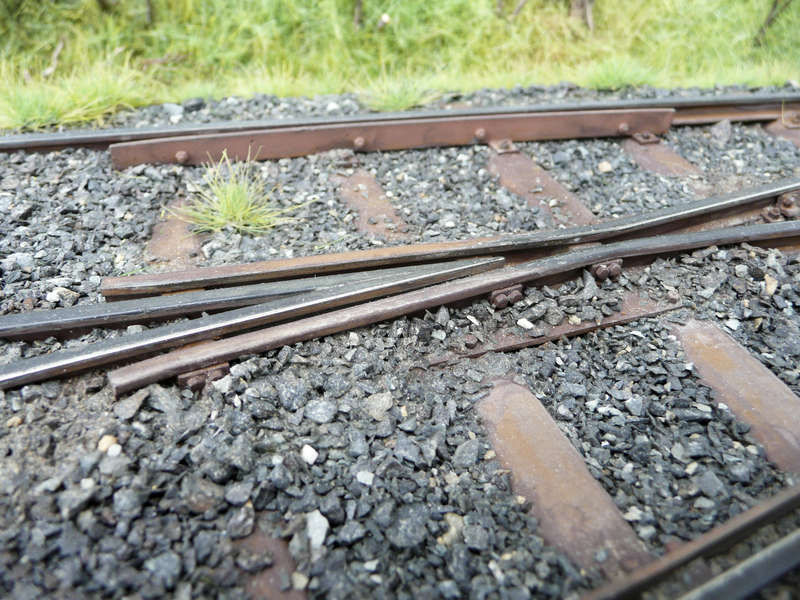

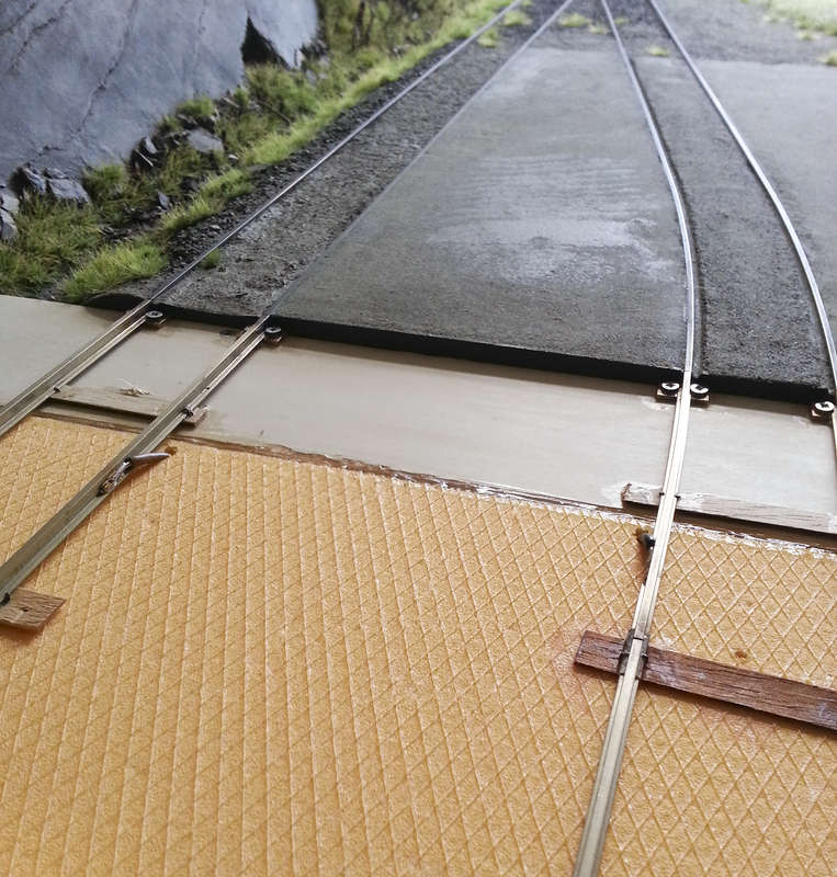

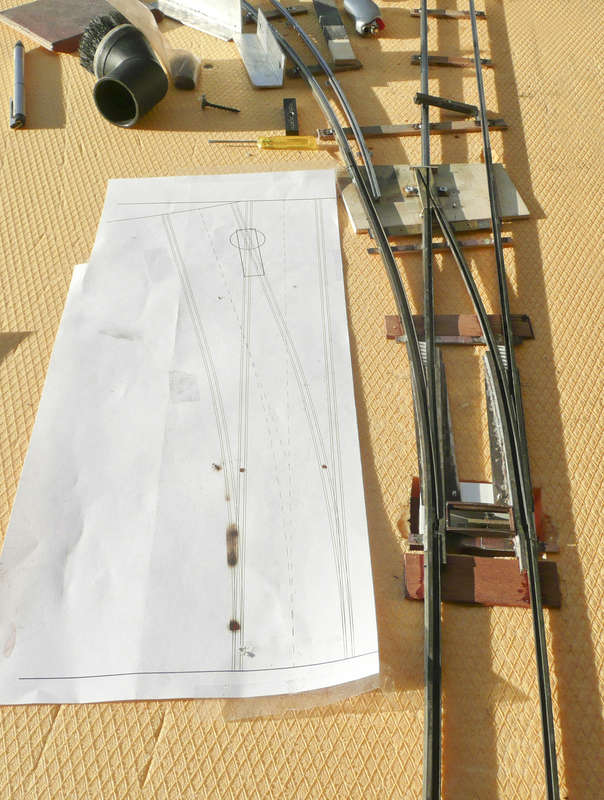

Both turnouts were made as described before in A snapshot in time.
Blades are filed and sanded to scale.
A brass screw brazed to the blade serves as joint.
The blades' lateral rails need to be undercut to provide space for the blades' rail feet.

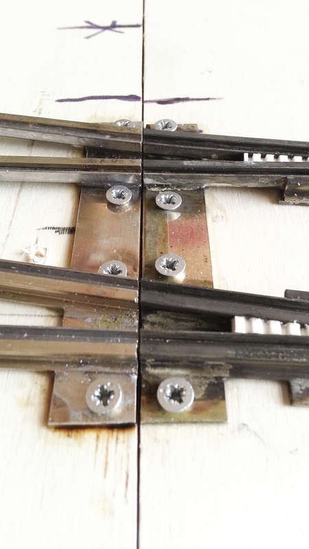

One turnout is located on the segments' edge. Sockets and brass rods provide exact positioning whenever the segments are mounted.
A very simple drawing with the track axis ant rail foot contour taped to a plywood board serves as jig.

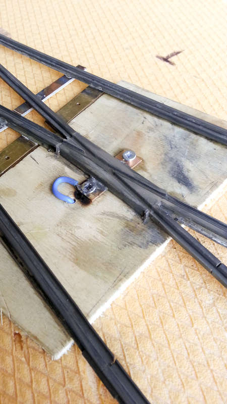

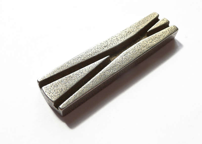

The frog is my first attempt in laser sintering steel.
After some sanding the part was perfect for its purpose.

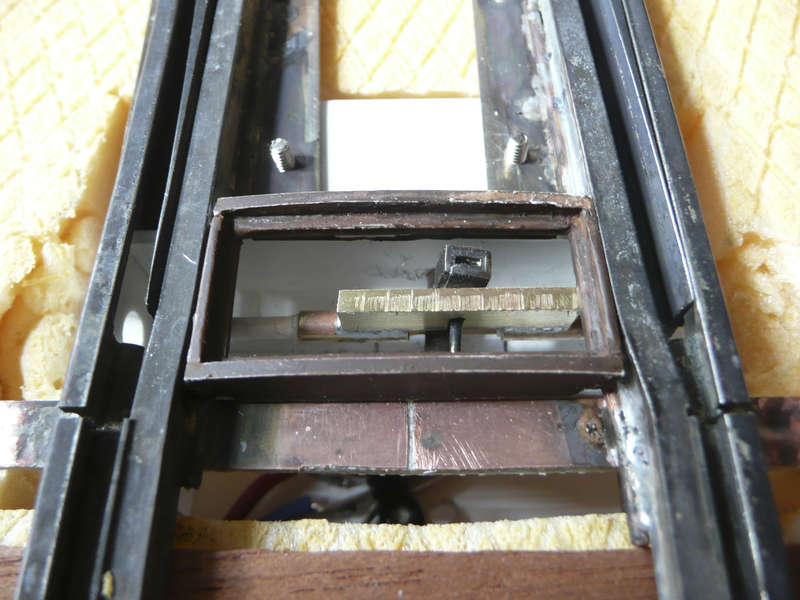

This is the mechanism to switch the turnout. The lever protrudes underneath and operates a switch for frog polarisation.

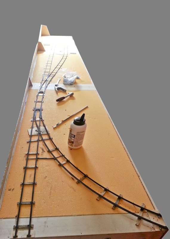

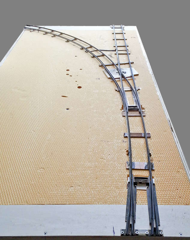

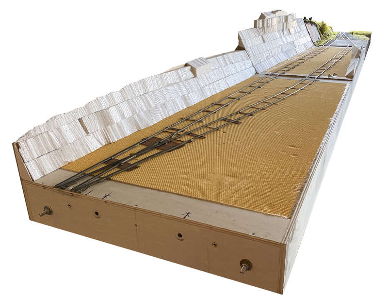

After completing trackwork landscaping begins. This is the transition to the former part.

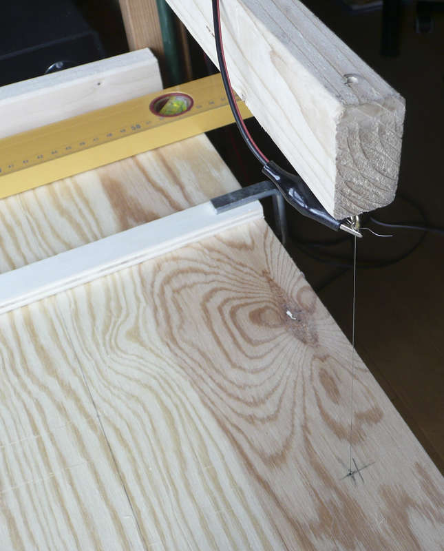

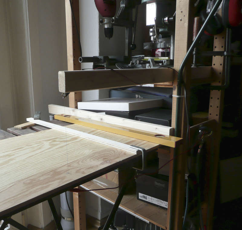

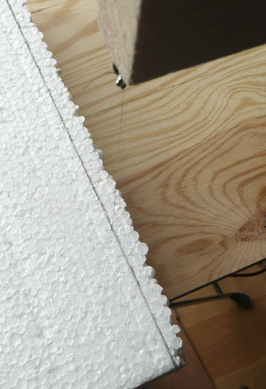

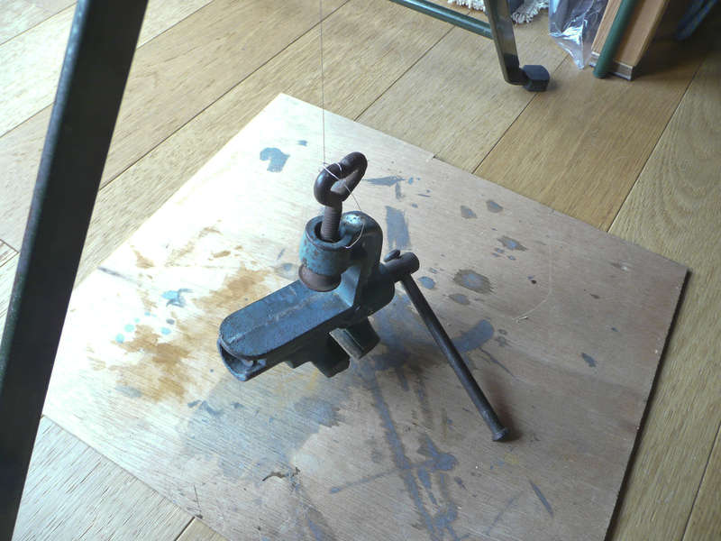

I wanted to use some packaging styrofoam, which usually ends up as rubbish, but I always hated the small pellets sticking on everywhere. And i like the idea to use materials which would have been dumped otherwise.
An electrical styrofoam cutter helped to solve the pellet problem. It was so simple to build it that I'd like to show it; I think it is self explaining  :D. Only thing I had tu buy was some 0.2 mm NiCr wire. Using a 6V power supply was perfect for cutting 6cm thick material.
That is an impressive start to the new section.
I like your foam cutting tool.
