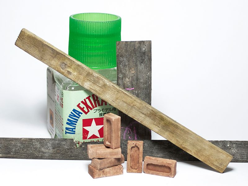

I've played a bit with the brick molds from Diorama debris that just arrived home.
I've used cheap plaster of PAris, the one that I had ready at home, but the result is embarrassing.
I've cast em white, the coloring is done after, once dry. Colors are OK although far from perfect, but my plaster skills are 0.
3 batches, and only 6 or 7 usable bricks. My mix and pouring was full of air bubbles. Sometimes too thick, the other too thinned. Really need to practice on that.
But these molds are great! There's a new batch drying this time pre-colored with pigments.
I've also tried something I've not seen so often, wet bare wood that has been stored outside for few month only. It turns yellow-green-gray.
Well, there again, need improvement. For now it's still too yellow / too balsa.

That beam looks pretty good to me Alexandre ..... think in some cases the green tinge you get comes from a wood preservative that is applied to wood that is to be used externally.
Keep up the experimentation , we are all learning ........ filed the use of cork for concrete away  ;)
Have you looked at Diorama Debris web site  www.dioramadebris.co.uk under  "tips & guides" their mix ratios I have found pretty accurate ..... for the small quantities we are talking about its worth while investing in some digital scales

Your new experiments are as usual looking just great! I like the concrete post as is....it could be very damp or just very dark from pollution etc. I have seen them look like that. The wooden beam looks great too!
Anders
Well it is good to hear you're having fun. Your results are quite impressive.
Alexandre,
   Welcome to the Forum . I can see that you are going to make a valuable contribution to what goes on here .
  I have looked at your last photo and there is nothing there that is not believable .I don't have a problem with the colour  or quality of your bricks as they could easily fit into " The Real World " , and your wood all looks fine . The piece you have on the angle looks just like aged oak , and I could prove it as I have  piles of it dotted around the estate ,
I think the "slightly aged" plank looks great! Looks very much like real boards I have seen.
