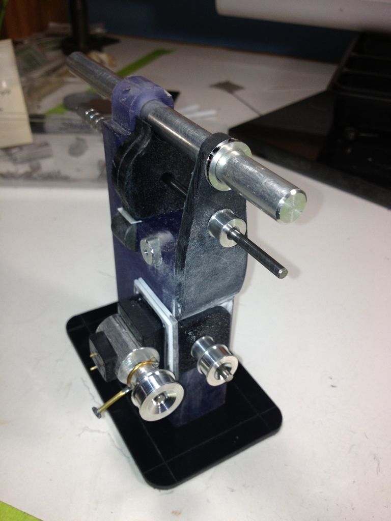

I was planning a RR shop and now that you mention the tooling
Definitely! But I would like to do some of it.
Still need a steady rest on the lathe.
Yes, making everything so far.
That was kind of the focus doing these machines and in 1/16
Trying to stay challenged.

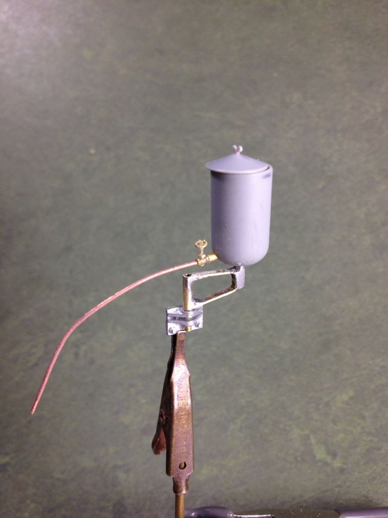

In the link Paul posted I found a neat
"drip pot" I thought it would be a cool detail.
So far;
SandiaPaul
Marty,
That thing looks great, I recognized it right away! Where did you get that little valve? Or did you make it!
Thanks Paul!
Parts list;
Pot
Grandt line wing nut
Grandt line O scale stove pipe cap
End of uniball vision ink pen
Precision scale O scale 1 1/2" valve
.025" wire
Bracket
1/16 tube & 1/16 x .014" brass
CHB donkey sled plate
The arm pivots like it should too.

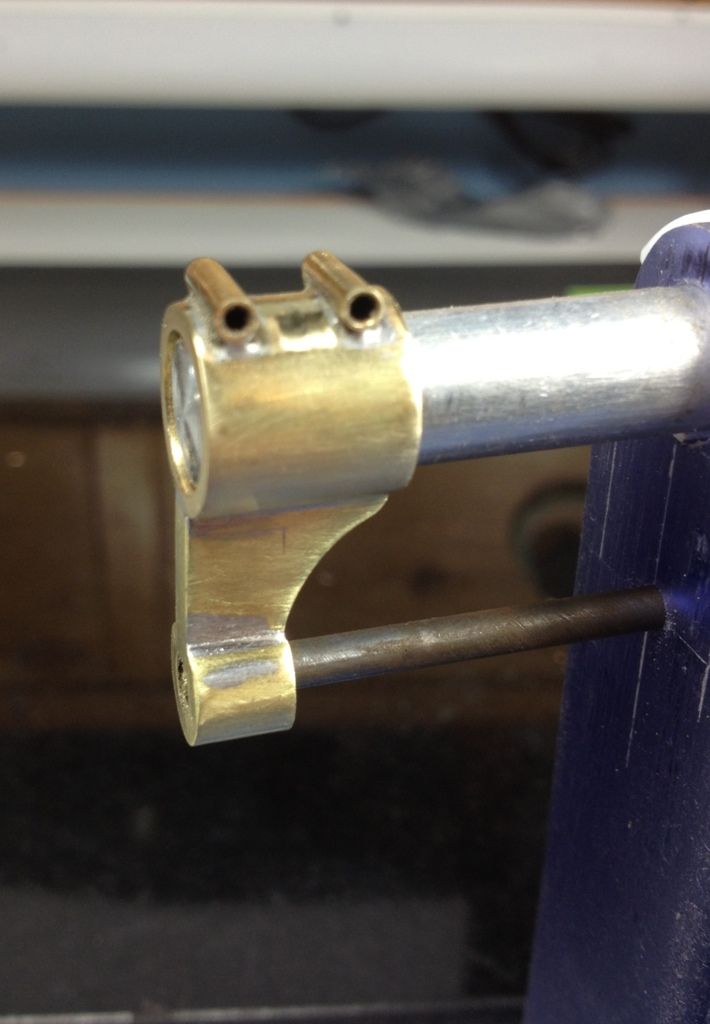

Overarm to spindle support;
Had to do it in brass, just could not find suitable material in styrene.
Quotejust could not find suitable material in styrene.
I'm Shocked!!  Ya mean you couldn't find some evergreen flat stock that you could laminate and then bore out.  Your slipping Sir.....
Hello Marty,
where is the problem, I love brass as you also can see in my work.
In the metal parts like me even better.

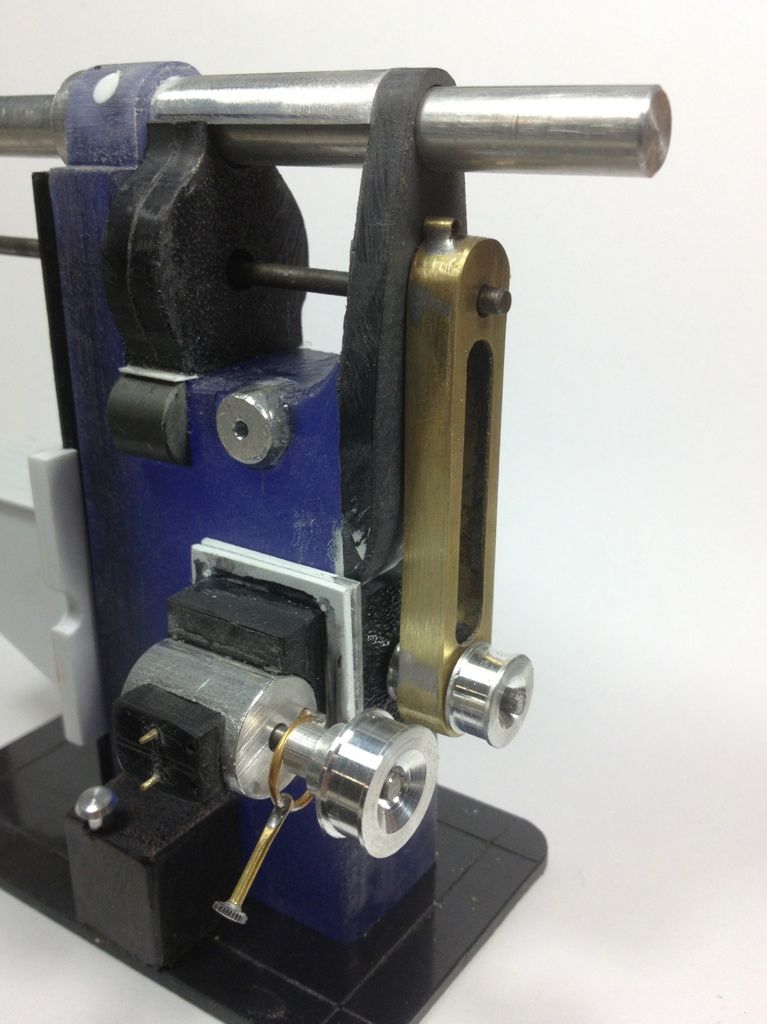

Some progress
Just cant seem to get styrene to take a curve and not break
when i use MEK to "glue" it.
Hence the brass belt guard.
