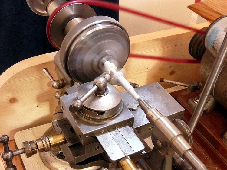

Gratuitous shot playing with the little lathe, nothing fabulous just turning down the filler used to pack out the inside of the cams.

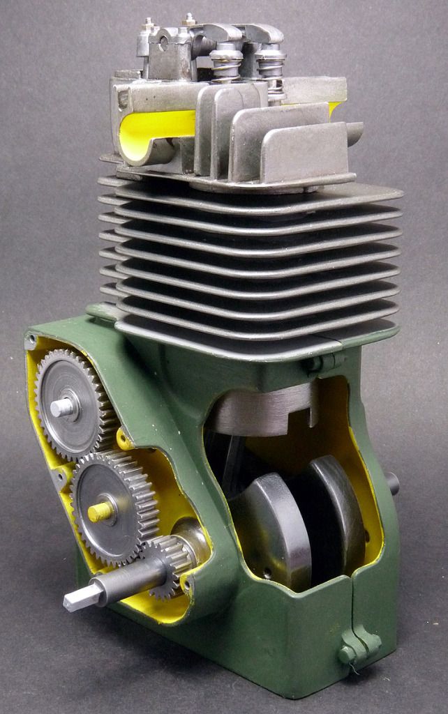

Shot of the gear chain. I've tried to allude to the turned effect of the gears but the effect is a bit too subtle here - slightly better in the flesh.
A quick shot of the interior.
And another - does show the cams and followers off though. ..... I must say these large pic's are merciless!

Here you go then cheps!
Finally put this one to bed - and it's been great fun, a really enjoyable piece of modelling. Nothing too exalted of course but I had a good time - although I'm hoping of course it gets a general blessing??
No fancy descriptions then just a few pic's - ask if you feel the need though?
As can be seen I've tried to forgo the highly polished bit of kit route - but rather go for the look that I remember our Science lab cutaway engine had! - heavily used with countless grubby fingers pawing it daily. Evidence of constant strip-downs and even the occasional hand-painted rebuilds.
Tried hard also to make a reasonable fist of the look of the raw metalwork, some with a bit of surface rust others well finger polished. I didn't take an age to photograph it so consequently the metal effects don't feature to highly but in mine own defence they do look a little bit better in the flesh - ish!
