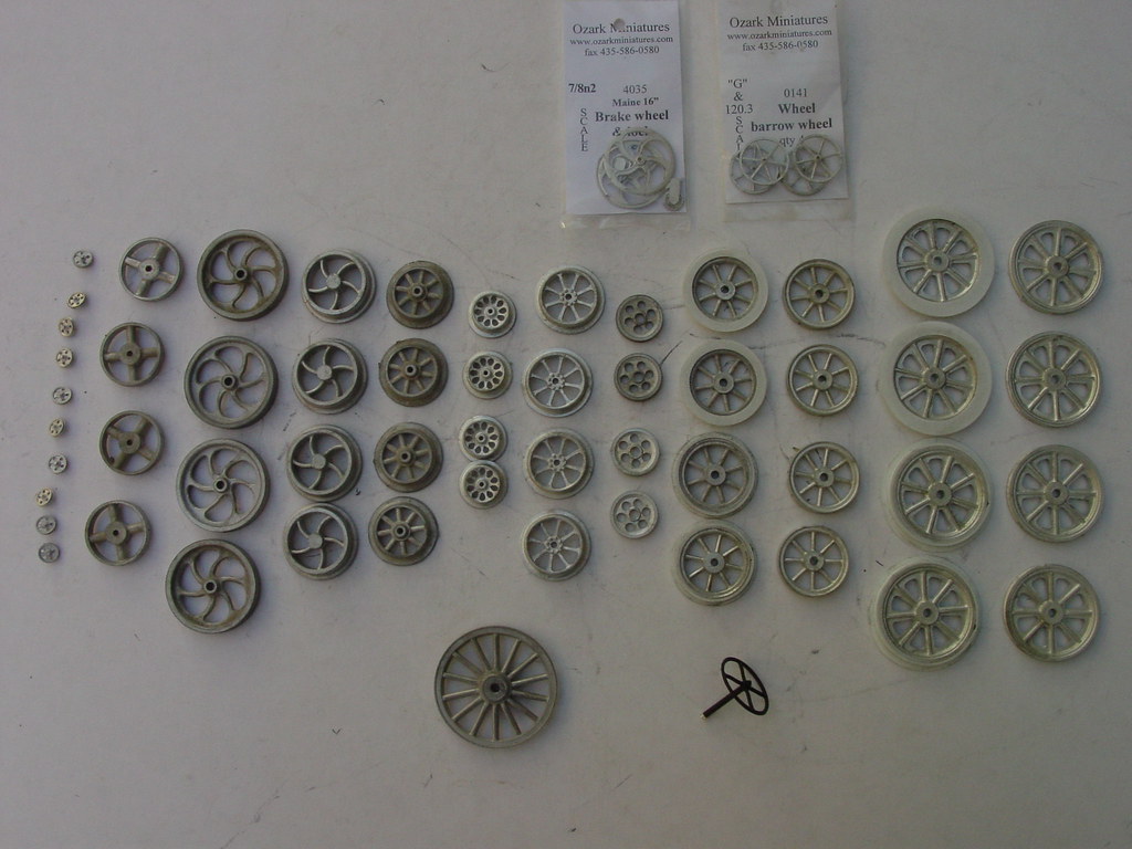

Where'd the wheel centers for #10 come from?

Marty the center is a cannon wheel casting from Ozark minatures. I did a SBS in the Summer 2012  Narrow Gauge Annual.Fordson Tank and Rail Truck.
http://www.ozarkminiatures.com/Scripts/default.asp
Here's a photo showing some of the other Ozark Minatures castings I use in my model.
