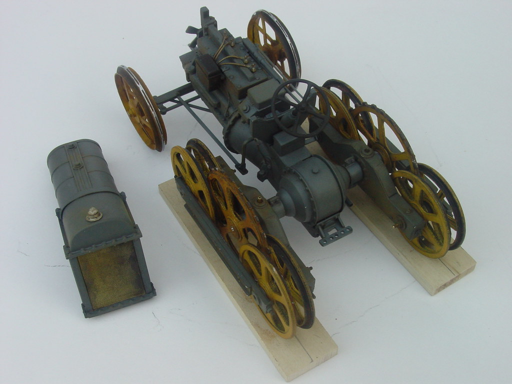

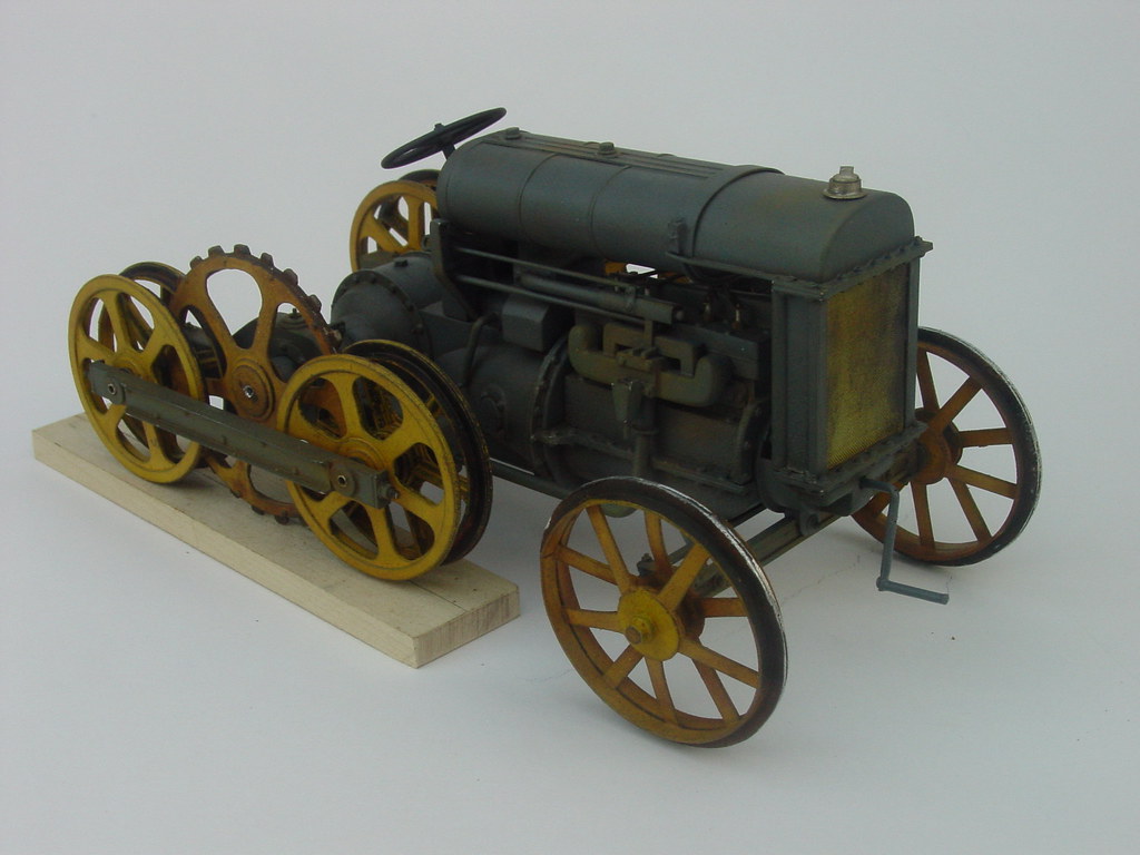

Thanks guys for your comments. Here's two photos of my progress.

Simply stunning!  :o I reallly like it all over, but what catches my eye especially is the radiator web.
Thanks guys for your comments. For the tracks on machine #6, I'm using ladder chain from Tamiya.  The chain comes in a ladder chain and sprocket set, there are 128 links and some sprocket parts in the set. I built the connecting parts out of styrene square tubing. First I cut a piece of 3/16" tubing 1/4" long and placed it down into the link keeping flush with the top of the chain. Then I cut a piece of 1/4" tubing a small 1/8", this part goes over the 3/16" tubing on the bottom of the chain. I'm thinking that I will paint the connecting parts and add them to the chain and then add the full assembly to the frame and glue all the parts. At this point I will add a painted pad to each of the connecting parts.
Way to go, Gordon. -- Russ
Looking good Gordon!
How does the tamia chain compare to the servolink?
Can you take a side by side picture?
That's a lot of work! Should look great all painted up.
