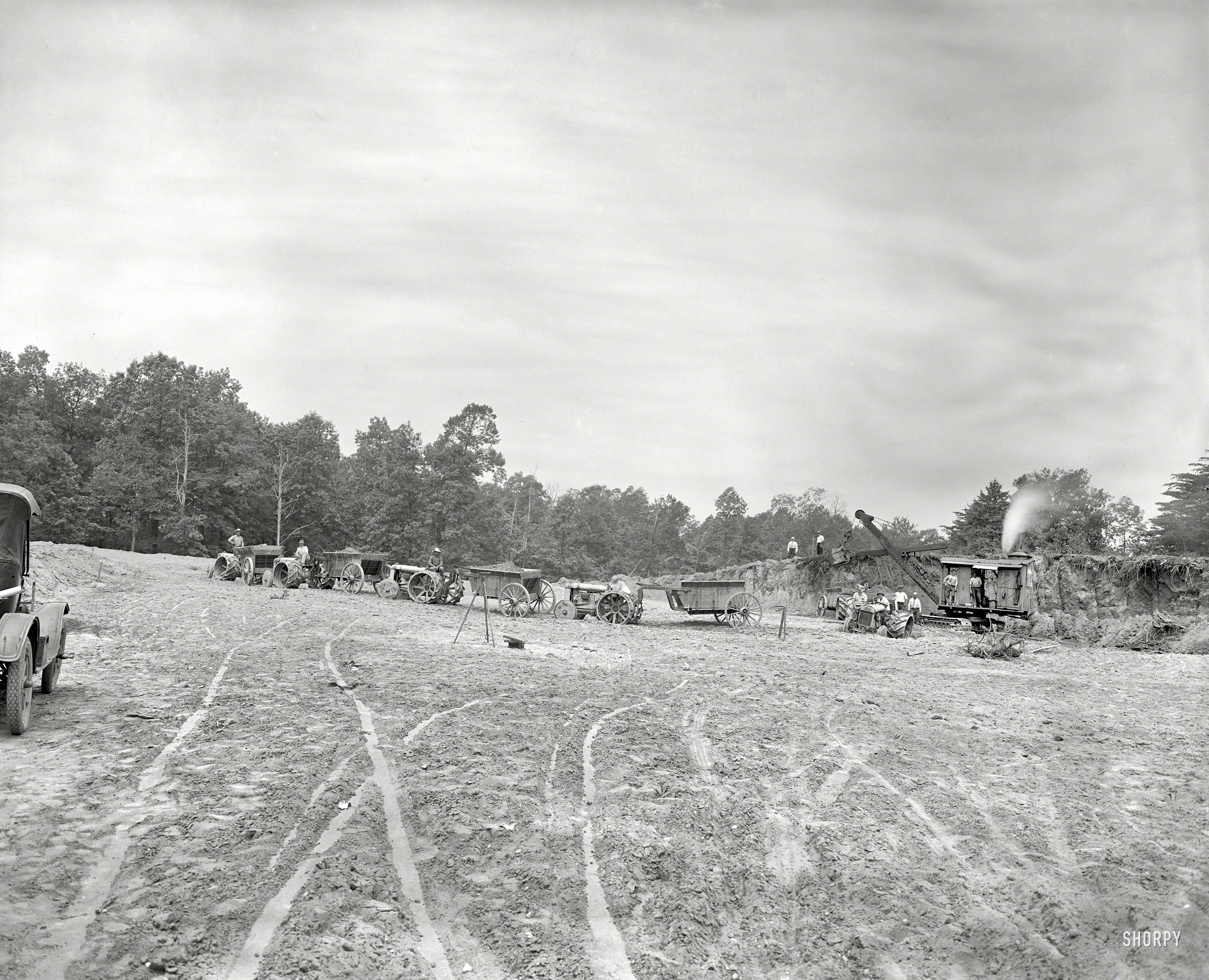

I continue to be amazed by the top notch modelling I see on this site. A few days ago I saw this pic on Shorpy and thought it might be of interest:
A flock of Fordsons pulling dump units. ;D

That is one cool scene, love the dump wagons they are using with the Fordsons...

Fantastic photo, Stoker.  Thanks for posting it.

Interesting... they look very much like primitive versions of modern earth movers.

When I first saw that pic of the Fordsons I was unsure if they really were Fordsons because of the solid front wheel and the "duallies" in back, but I looked into it and found out that those were features of Fordsons. It appears that the extra wheel in back for extra traction/decreased ground pressure is bolted on. If you follow the link I posted and then click the picture it will yield a very high resolution picture and you can see that on some of the wheels the chevron does not line up. The trailer dump units do look like modern scraper type earth movers, but these appear to be just bottom dump/spread units with no scrape feature. In the front of the trailer you can see what looks like a bottom door mechanisn, and then in the back there is also a gate. It looks like they are mining dirt to build up a roadbed which you can see on the left.

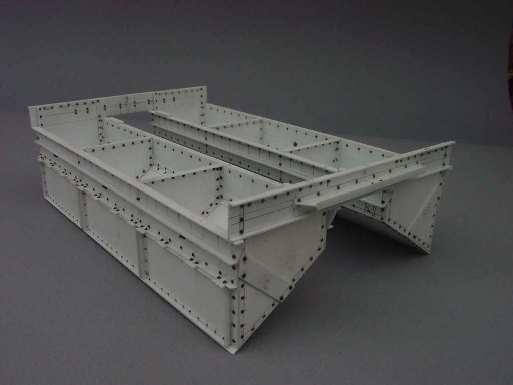

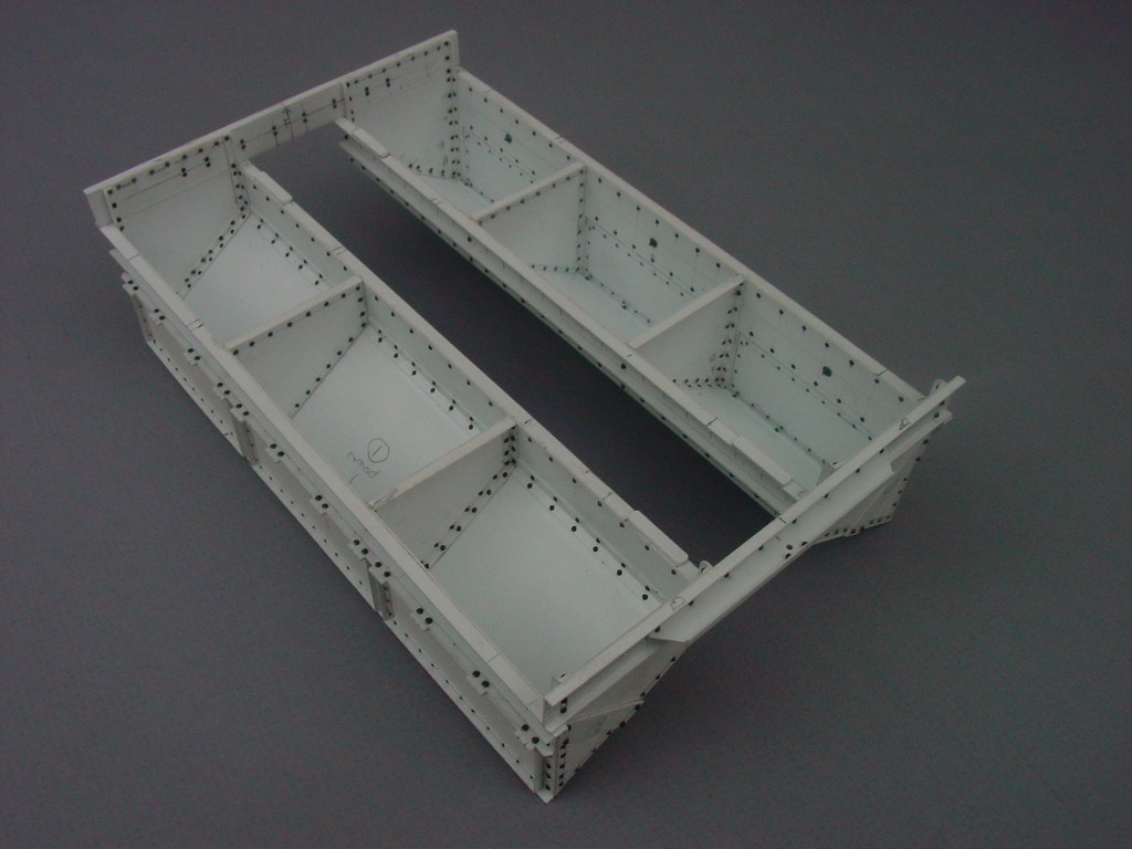

Here's two photos of model #7 the Monorail Loco, American Magnesium Company Locomotive. #1. Close to 2000 parts.
#103
I used five different Grandt Line castings. The rivets on the doors are 0.040" diameter #154. All the other rivets are 0.060" diameter #156 with some nut-bolts 0.060" diameter #128 in spots. I used nut-bolt-washer #23 on the hinges, and nut-bolts-washer #16 on the stiffening bar under the  side sill.
The sheeting is 0.020" thick. The side and center sills are 0.030" thick with 0.156" flanges. The end beams are 0.030" thick with 0.125" flanges.
The angle-iron on the doors is 0.100" Evergreen angle. All the other angle-iron is 0.125" Evergreen angle.
Wow! Great progress Gordon!
