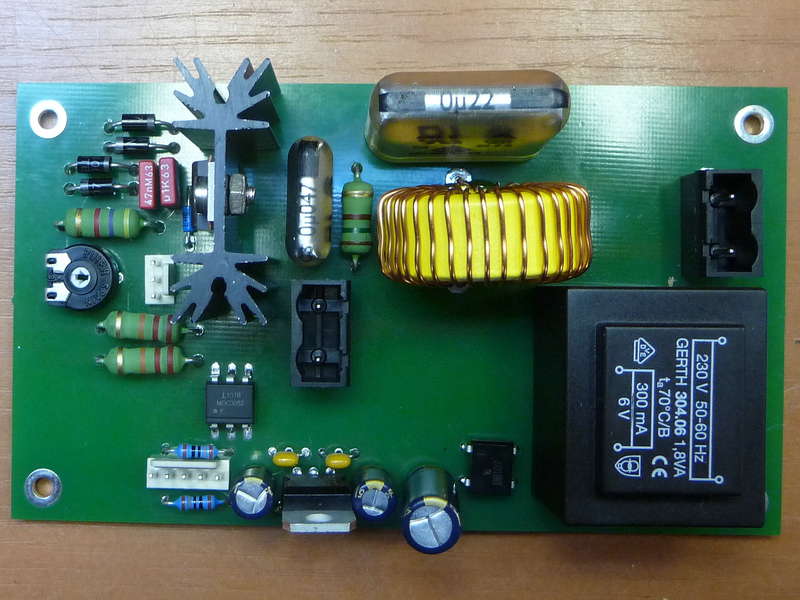

THE (Buntbahn Forum), there are currently just a self-construction project on which I participate.
I'm just doing the finishing circuits soldered to the transformer together to build a case.
transformer
Board with the necessary equipment, for Widerstandslötgerät.
Right now I'm just cold and powerful pause forcibly.
