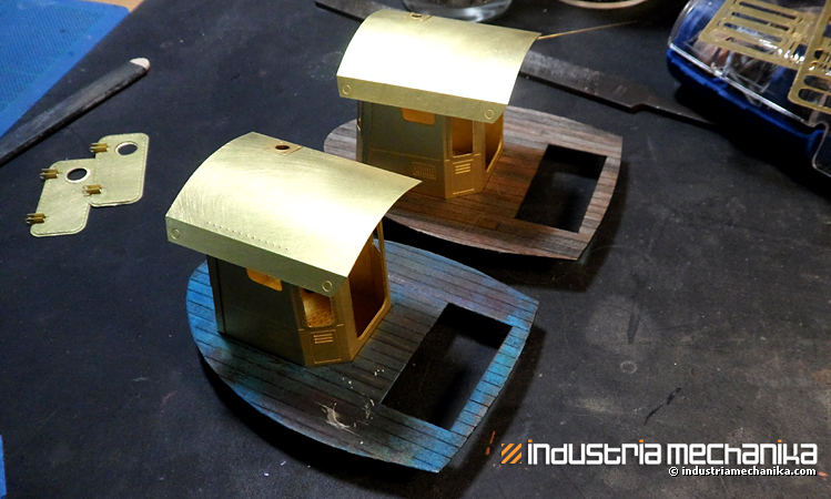

Here's the detailed build-log of my 3 Waldo builds so far with my SBS's, etc... More to come!  I'm working on a bridge/refueling rig I started over a year ago for the Remora and am doing another Sky Mark buoy with this.
http://fichtenfoo.net/blog/tag/waldo/

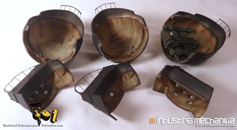

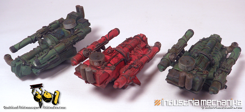

FichtenFoo
More progress on the Waldos before my "commission-break" to work on painting something for a toy company.
1: Primed w/ Black Duplicolor Primer
2: Airbrushed on Flat White Tamiya Acrylic
3: Satin clearcoat with Future Floor Acrylic mix
4: Sponged on paint chips using Vallejo Model Air colors in this order: Black-Gray, Burnt Umber, Mahogany (sparingly), and Ochre (sparingly)
5: Airbrushed on the following faint layers of Ak-Interactive Products: Blue-Brown Wash, Dark Streaking Grime, Engine Grime. Applied more towards floor of hull.
6: Stipple AK products to blend/randomize with deerfoot brush and Odorless Turpenoid
7: Let cure 24 hours
8: Flat-coat with Future Floor Acrylic mix
9: Airbrushed on the following faint layers of Ak-Interactive Products around upper rim of hull: Streaking Grime, then Rust Streaks
10: Using flat-angled brush and Odorless Turpenoid, push/pull/streak rust-toned-band down towards floor of hull.
11: Apply thinned washes of Track Wash on inside crease
12: Apply fuel stains with AK-Interactive Engine Oil and Fuel Stains
