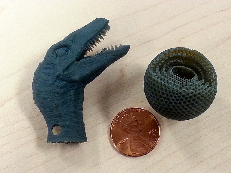

Not the greatest photo, but here was our first successful print, at a z resolution of 50 microns:

That was around five and a half hours. This machine goes by vertical height, and the raptor head was setup with the snout pointing up so that the teeth could print without supports. I set up a build tray of 32mm figures (~1:48) before I left today, and that will take about three and a half hours. The figures were cut up and mostly lying on their sides rather than standing straight up.

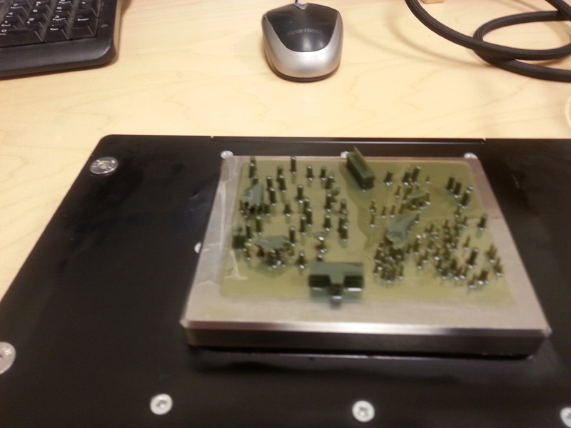

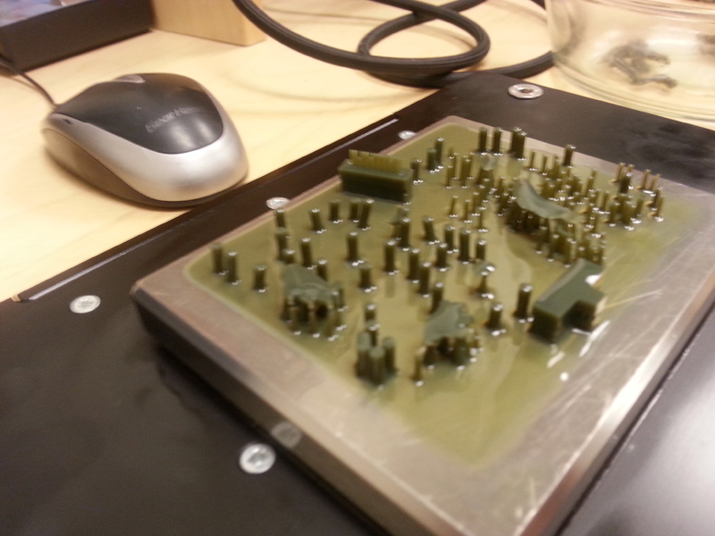

Also: Here's what a failed print looks like!
Still not sure what happened. We sent the job file to the tech, and he was able to print it without any problem, but we had two failures. (These are both photos of the second failure.) For whatever reason, as near as we can tell, the machine had a no-data exposure frame, which essentially caused a blank layer, and so all the subsequent layers had nothing to attach to.

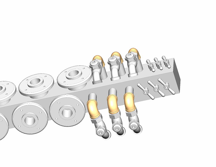

Shapeways has started using an automatic thin edge detecting feature. 4 or 5 months ago, I sent this cluster of pipe fittings and faucet parts in and had it printed no problem. Recently I sent in a second order and the thin edge feature disallowed the faucet handles. Didn't matter that they printed fine before, they would not allow the print unless I modified them.
Shapeways has a new button, "Print Anyway", that might be useful in instances like this.
https://www.shapeways.com/support/print-it-anyway
That's interesting...I communicated with someone and told them I would be fine if it didn't print properly. But he said it would cause the print to fail and they wouldn't accept it. Hmmm.
I just read that "Print It anyway" policy and unless it is a "gun" or a prohibited item, they say it will be printed...just no returns allowed.
Tr it out Chuck and let us know what happens.
